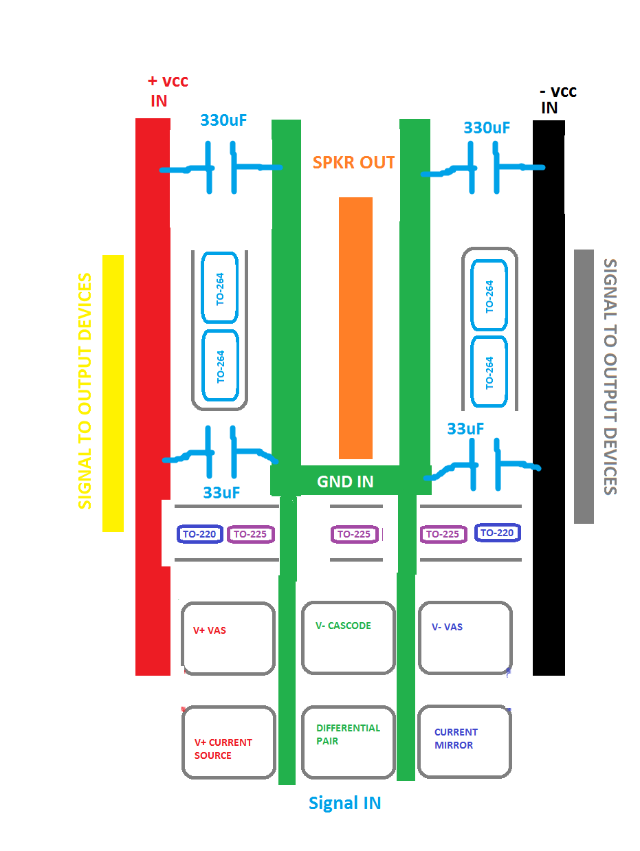

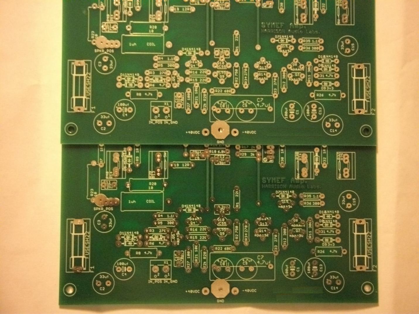

PCB updates
Having received no updates for improvement so far I speed-ed up the progress and had the boards cut today. The boards will arrive next week. Thus those to receive complementary boards should receive them the week after. So get your components and oscilloscopes in order.

To hit the 30k research mark I have eased the availability of PCBs and BOM, pay harrisonaudiolabs.com a visit

PCB updates
PCBs
Joel, Paulo, Raj, Brian, Evette, Mrsavage, Pinnocchio
All the best
PCBs
All the best

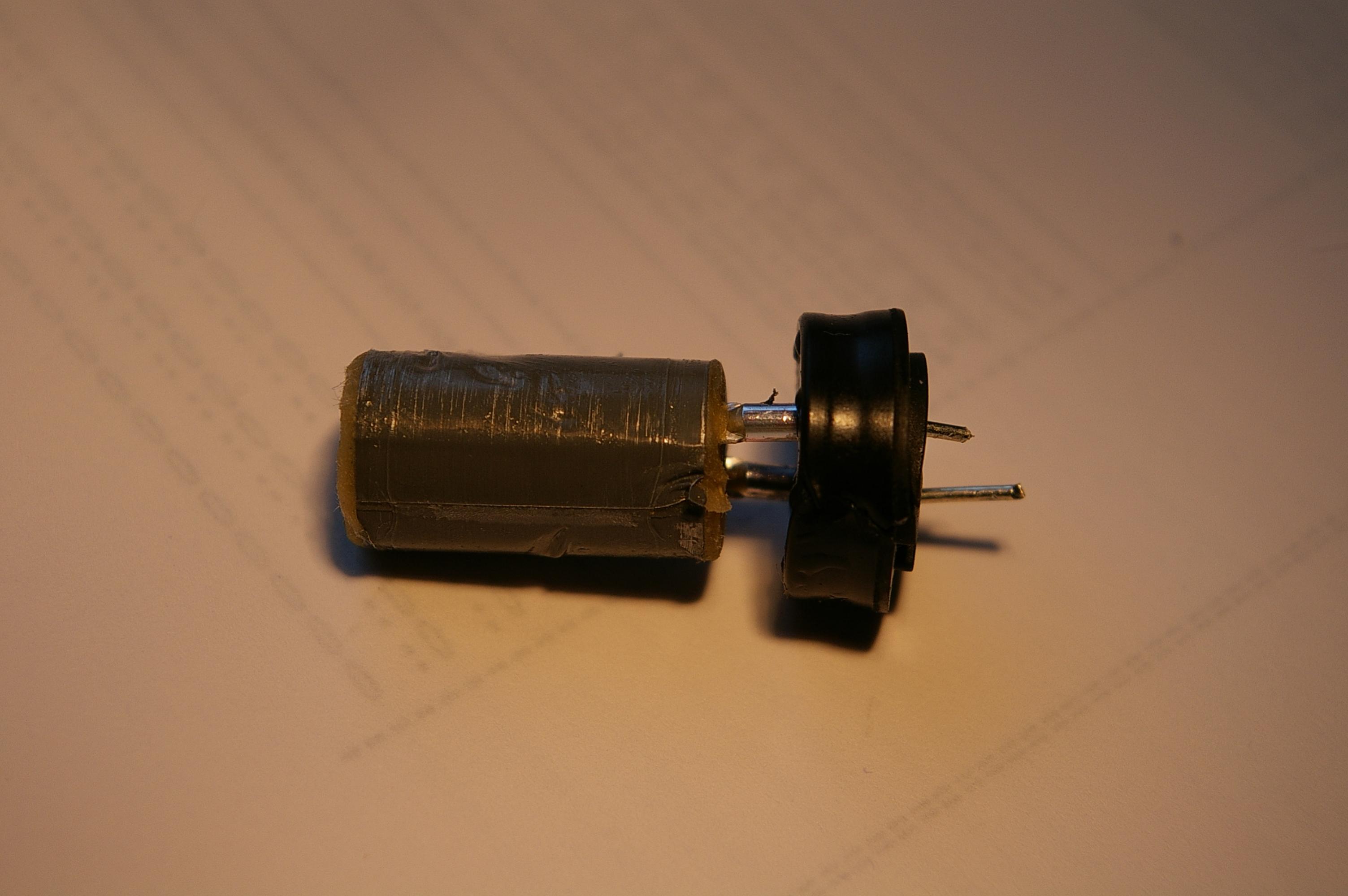

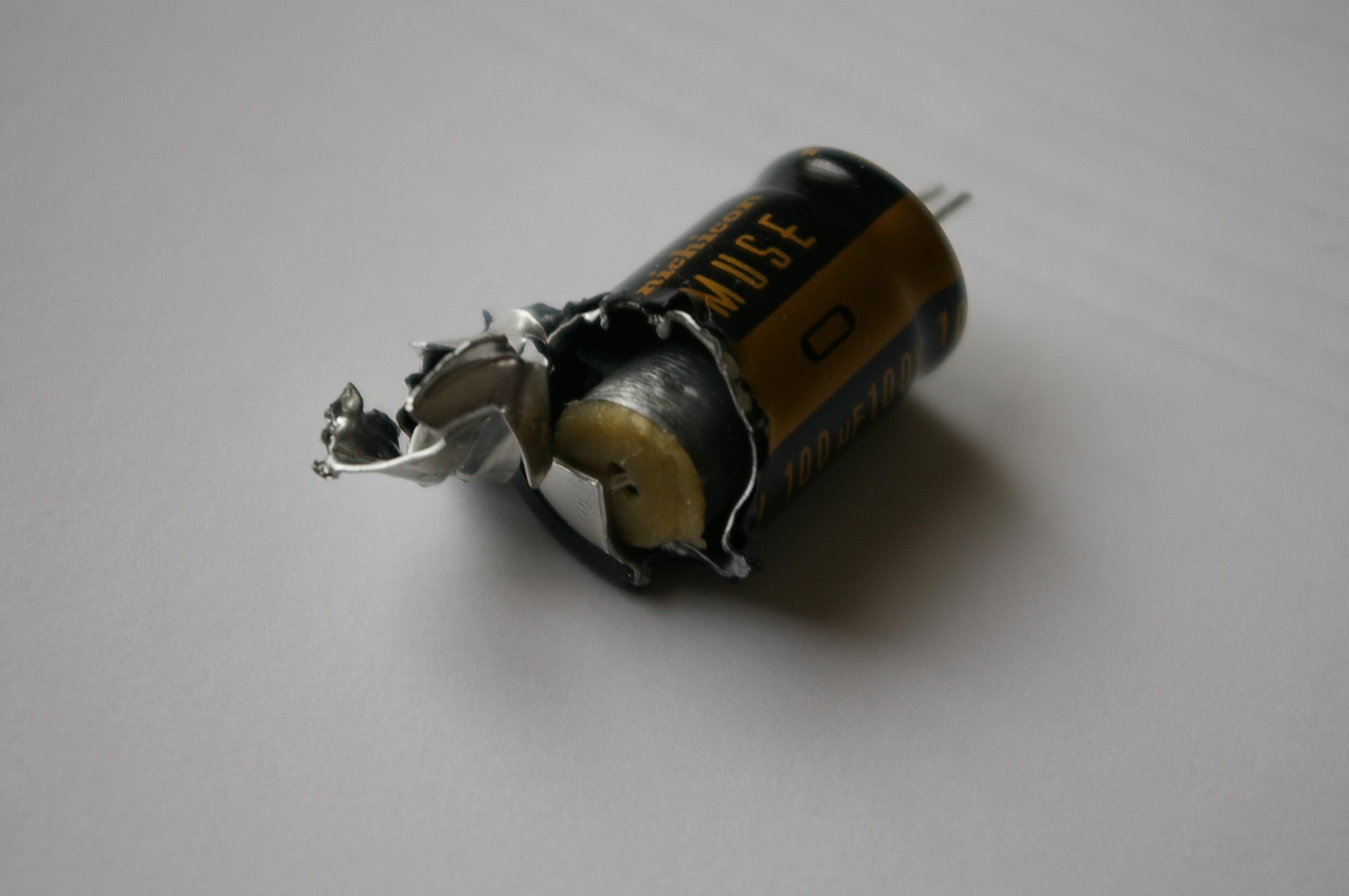

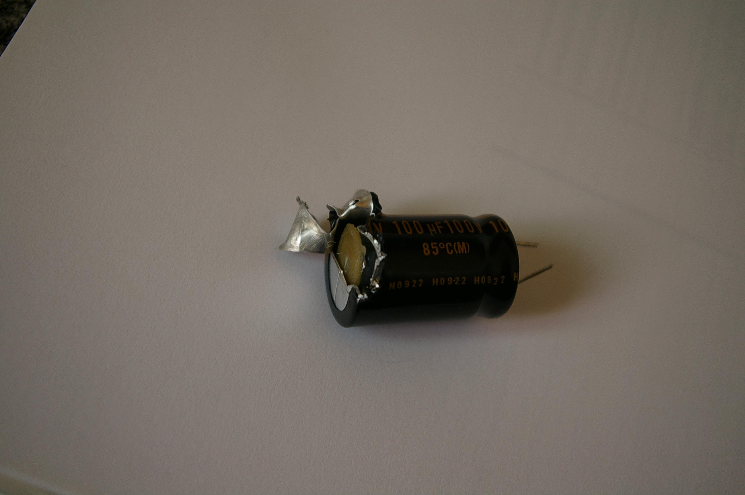

Incidentally, I soldered a Muse KZ capacitor the wrong way and it became very hot and inflate the top. I wanted to see what’s inside so I opened the can. It then vented a vapor smelling like sulfer. I took some pics of what’s inside and here they are:

next time be aware of the polarity and stick to safety region.😉
