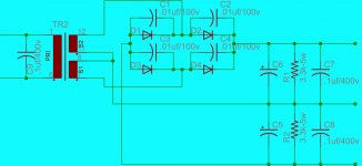

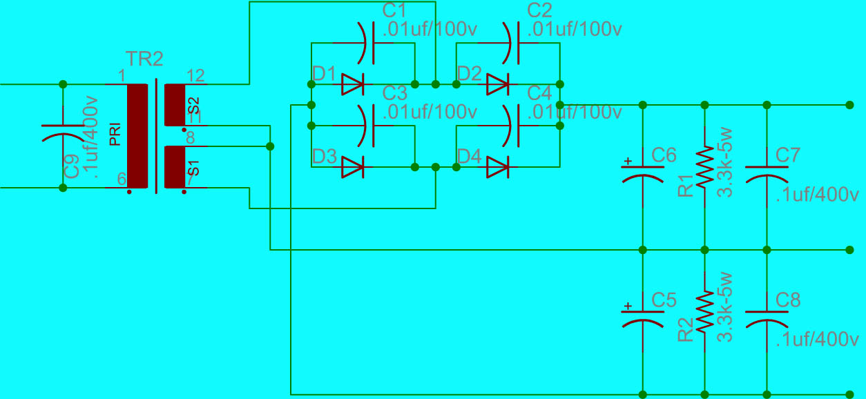

I was talking about film caps across signal path electrolytics. I'm confused, I don't know if it's good to pursue that way or not. Anyway, you answered one of my previous doubts - the films across psu reservoir electrolytics - and I thank you. I'll put 100nF film at the rails of the psu to filter RF noise. What is best - to put them near the rectifier diodes or at the output of the psu? Thank you again, drowranger.
Thanks, Joel.
How did you arrive to the snubber caps value? I supose depends on which diode is used. I use soft recovery ultra fast types. Also the input 1uF cap, I see in some designs 100nF. I also see 1-2uF cap after the electrolytics in some schematics and sometimes a RC filter. Is there a way to arrive to the best values for this parts?
Thank you.
Thank you.

I discovered my PSU was noisy that's why the jump for the regulated supply gave such good results. The highs became smoother and sweeter. This "noise" was perceived like an harsh metalic treble. I rebuilt the PSU according to drownranger and that metalic noise is now mostly gone. Being so, there's no need for a regulated supply with this amp. In fact, the amp has more bass with the unregulated supply.
I feel like I'm trying to find my way in the dark and you guys are the torches that light my path. That's why I make so many questions and sometimes do stupid naive mistakes. You have the experience and the knowledge that I don't have (yet) and I thank you for sharing it with me.
I'm now using the unregulated supply with 100nF MKP at the outputs and 100nF at each diode. I don't know if the noise is coming from the diodes, the transformer or the power company. But now it's better. Is there anything more I should do to improve further the PSU? Another question I'm wondering - why is that with the regulated supply the bass was not so strong and extended as with the unregulated one?
