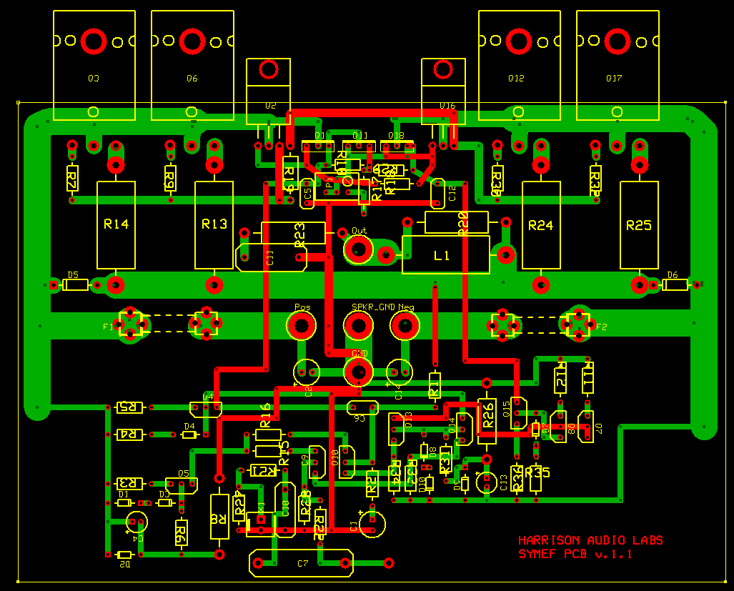

Thank You Mr. Harrison for giving me the pcb,s for this amp. @ friends of mine helped me built this 1 channel of a great sounding amp. My power supply is giving me 45+ 45-at 500va. I,m using 66,000 mfd caps. I changed the Front end to a i cap input of 2.7uf this is all I had at the moment. The output is biased at 65ma,,offset is only 2,5mv- The sound is WOW Great amp. Thanks again Mr. Harrison. Evette
🙂Further listening with the amp I,m more and more impressed with the ease in which it can take you into another world. I can,t wait to build the other channel and use better parts,to bring out this best this amp can do. Thanks again Mr.Harrison 😛Evette

Hi Evette,
Thank you for your contribution to the state of the art. I am glad that you are expriencing what the formula tries to capture 😉.
kind regards,
Harrison.
