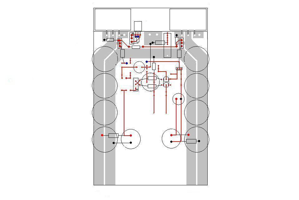

I find your work very interesting
Though it seems to me like a lot of copper and very few components
Im pretty sure the amount of copper needed could be much less with placing just a few components slightly different
Several copper lines seem to wiggle a bit much in places where just a bit of rearranging would straighthen the lines, and naturally make it smaller
Maybe also allow a few components to be mounted below board, if it makes layout much simpler
And few jumper wires also makes sense, if it makes layout simpler
Maybe also below board if needed or makes sense
Seems to me that it gives possitive results to try and have as many resistors as possible as "jumpers"

Below is a picture of how I like a supply, only this is a much smaller amp
I have removed all coupling film caps that are not needed in terms of stability, making layout even simpler
If anyone would insist on film coupling caps, it easy to mount them below board
ehhh, its not 100% finished yet
And yeah, I know, its a much simpler design
