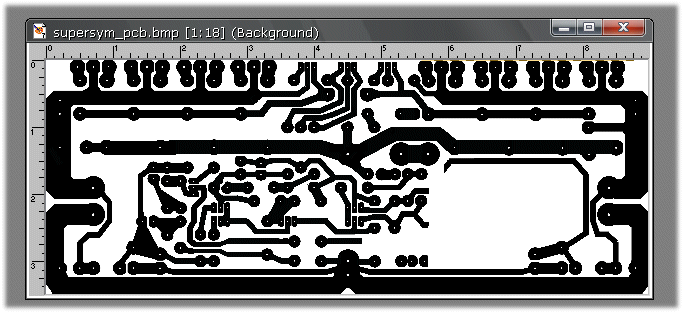

Even if that might not be practical, designing the pcb with input stage options might be doable. Then everyone can decide to use FETs and/or cascodes there.
Originally posted by ostripper the cascode/JFET has NOT been built yet.
Will it ever be?
The base amp , WITHOUT the additions is up and working. While I am 99% sure the cascode will work and still be stable , the BASE design is 100% (listening to it now 😎 ).
That's why a versatile pcb might be a good option.
I noticed the cascode and VAS was what determined OLG , UG , phase margin. Replacing the differential with anything (MOSFET , JFET, more KSC's) had very little effect on performance.
Have you tried it?
One might want to try slight variances on component selection. So far I have tried 47 and 68pF cdoms.
68,82 and 100R for R16 (main degen for the VAS collectors).
with and without C21 (10p).
ALL these affect the character of the sound while maintaining great stability. I also have experimented with the OPS bias (60-70mA per device sounds the best).
It might be interesting to know what affects what and how. Did you make any notes on that?
One thing I might be interested to know is if using a regulated supply, perhaps higher voltage, for the low current stages might not improve things and if you are thinking of trying it.

Exactly , Alex has made a very nice board. I am also done with a very nice one. I see NO reason why both artworks can not be offered as options. My board will just be the "strait up" supersym, exactly the one at the beginning of the thread. Alex's can be the modified one with the cascode /JFET. 😎
With alex's , one could just jumper C-E's on the cascodes and run a "strait" supersym .. no issue. In fact, if alex uploads his artwork to me, I will host it for the thread.
To answer calmart's question , I HAVE run the cascoded FET input stage successfully with the KSC1845's on every topology (balanced ,APT,self and RCA "bootstrapped"). The reason my present amp does not have it , is that the perceived sound improvement did not justify it for ME (truly subjective). CFP inputs , JFET ... all the different input stage configurations sounded nearly the same with this and other topologies (again subjective).
As one who has gone "around the world" with all the AB DIY amps on the forum , (bootstrap , self ,leach, this one , roender's folded design) , I must say , even objectively , only this one and roender's can retain the same precise hypnotic sound from the "first watt" to insane levels at hundreds of watt's (really).
After submitting my "plain jane" supersym (maybe tonight) , I want to start on a standardized OPS so I can just "plug in" any
modified LTP/VAS creation without having to redo the complete board. This way, I can test ANY mod , at full power within hours of conception. This will also give me chance to play with SMD input stages (Aussie amp style) , which , by the way.. I feel is the way to go (as far as the LTP/VAS).

I did a new version, called for Supersym-2.
I have achieved a good result , distortion of 0.005% with 180W rms in 20Khz, Slew rate is the 90 Vus.
I also added the short circuit protection.
What is your opinion, I should open another topic?
I use the same transistors of the design (are very good you chose well). The original project is yours, so I am asking
-I do not have the pcb
by raphael -I did a new version, called for Supersym-2.
I would not mind at all , In fact I would like to see it.. submit .asc and/or schema.. 🙂 is it triple.??
