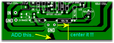

PCB top side with silk screen...

I have , read several times, my errors and I try to correct in my new PCB 🙂
Thanks for comments , are welcome and I have learn a lot . Next PCB in progres , in diferent size and shape .

By alex - I have , read several times, my errors and I try to correct in my new PCB
now you are down to 2 (errors) the 27K NFB "takeoff" should come
right off the output pad. move that star ground just 20mm to the right (center it).
This amp does not oscillate , so your zobel- off center should not be a factor. Your output coil has disappeared !!!
I like your green and red led PS indicators , I do the same on my external 100k uF 75-0-75v supply.
It can alert you to deadly voltages.
OS

Re: PCB top side with silk screen...
Looks good 🙂
But why those high volt 100V caps
With less voltage they could be higher capacity
Is lead pinout really that much
Ahh, ok I see now, picture is bigger than actual size
I would try and direct/control the supply lines more towards where you want it
Well, may be perfectly fine as is, but from another quick glance it appears than ground lines for power supply caps are way too small
There seem to be plenty room for making double "bridge", with each pair of supply caps 😀

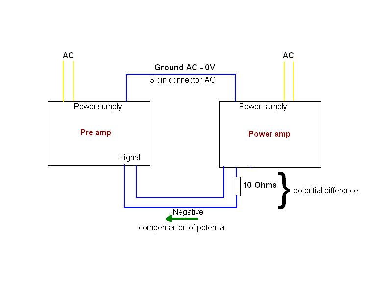

AndrewT said:I had forgotten that discussion.
I agree that the Signal Ground can benefit from some form of Audio isolation from the Power Ground.
If an unsafe voltage accidentally contacts the Signal Ground somewhere along it's route then the diodes conduct, with either polarity, to Safety Earth when the voltage >~600mV
pacificblue said:Without the resistor a potential difference between power and signal ground of up to ~600 mV can build up. That would offset the correction signal and affect the NFB function. The lower the signal voltage, the worse the effect.
E. g. with the feedback combination 27k/1k shown in the last schematic 60 V output signal should give 2,14 V correction signal, but can give anything between 2,14 and 2,74 (up to 28 % difference). 6 V output signal should give 0,214 V correction signal, but can give anything between 0,214 and 0,814 (up to 280 % difference). 0,6 V output signal should give 0,0214 V correction signal, but can give anything between 0,0214 and 0,6214 (up to 2800 % difference).
Where are getting these values, which can measure in the simulation?
In my opinion, resitor creates a link to Ground
Fig:
The resistor values were taken from the last posted schematic. R46 and R12.Rafael.luc said:Where are getting these values, which can measure in the simulation?
The voltage values were simplified assumptions for output to ground and gate of J2 to ground. They will be different in a simulation and in reality. I did not want to calculate, which current actually flows and whether that makes the diodes conduct or not. It is also not accounted for, why and how big a difference between audio and power ground will develop, e. g. due to static charging. In real life there will probably be a point, where the diode starts to conduct and all output voltages above that point would be offset by the diode's forward voltage. Below that point any differences would probably be leveled out through parasitic resistance after a while.
The gist is that the feedback pair is first of all a voltage divider that provides a scale model of the output voltage for the inverting input of the differential amplifier. Without a resistor across the diodes that scale model is not linear.

Pacific,
thanks for taking so much time to drag me through that input/output referencing.
I guess the only way left to convince me is to breadboard it using an opamp as the power section and see for myself why the output would float in that range +600mV to -600mV.

the 10r0 in the diagram should not be in the signal return line.Rafael.luc said:In my opinion, resistor creates a link to Ground
Is the ground AC link shown in the diagram real?
I have never seen this done.
The PE wire is usually in the three core mains cable/cord and connects to the mains socket outlet.
It is quite probable that you won't see anything floating. Most of the time parasitic resistance will be sufficient to draw both grounds to the same potential. The only two situations, where this could become an issue areAndrewT said:I guess the only way left to convince me is to breadboard it using an opamp as the power section and see for myself why the output would float in that range +600mV to -600mV.
- when the output voltage is high enough to produce sufficient feedback current to make the diodes conduct. Then the diode's forward voltage will be the offset. With an opamp the feedback pair needs a sufficiently low resistance to achieve that at the achievable output swing.
- when for some external reason there is a potential difference that is below the diode's forward voltage and there is no connection between those two grounds in the source to draw them back to the same level, e. g. with a battery-powered non-earthed source like an MP3 player. For a simulation of that specific situation there would need to be a voltage source between the grounds with <600 mV.
Re...revised PCB
Final version , right here 😉 http://i40.tinypic.com/3538fw4.jpg .
If some errors exist please let me know . 🙂
Regards Alex mm .
Regards Alex mm .
By alex mm - If some errors exist please let me know .
No REAL errors ,Alex ... just some small things that would give that extra "refinement" (.003-4% THD). Instead of a long "diatribe", (love to use that word) , A pix will suffice. (attached)
OS

hi Alex,
Nice board, well layed out !
Maybe you could route the 27k NFB resistor to the take off point (via) where the the output coil is connected.

PCB fix NFB resistor ...
🙂 PCB revised again ...and again http://picasaweb.google.com/lh/photo/uQBvyIaFZ0WJUmeSuXNp_g?feat=directlink 😀 I think this time It's in right place NFB resistor , or not ? Thanks Ostripper and Piersma for your

PCB revised again
That is better , still .. won't NFB be under the heatsink (you could notch it out). Also , the 22k from the bases of the cascode (ksa1845's) could be a 6.2v zener , both ways will work nice.
2 little refinements (attached) and lacking a double sided board , one could just run a heavy gauge wire from output pad to Inductor.

AndrewT said:the 10r0 in the diagram should not be in the signal return line.
In my figure, there are two rack (pre-amp and power amp), GND of the Power sumply of each equipment, is connected to 3 pin connector AC (ground).
Mains socket is the short circuit the two pins ground, placed two equipament the same electric potential, it is used in equipment such informatica, a potential difference can burn the entry of an equipment
This is called "virtual earth" if your home has no grounding
