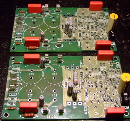

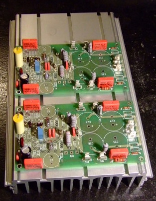

Well, I thought it was time I cracked on with these. Still waiting for some parts, but I craved the smell of solder fumes. 😉
I've got all the semis, I just need to sit down and match them, and I've installed some more caps since that pic was taken. I'm waiting for electrolytics, rectifiers and resistors, all hopefully on the way.
For traffos, I'll probably be going with 30-0-30 to start, but I might bump up the rails on the five for the mids to 35-0-35, we shall see. I'm also undecided as to build two five way cases, or put them all actually in the speaker enclosures.
I'm tempted by a Class D solution for the bass end, that way all the amps would fit on some nice big heatsinks I have.
