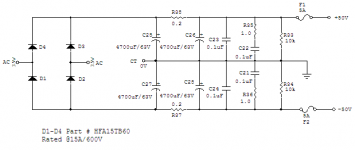

is there a schematic to go with AAK's PCB?
R33 through to R38 inclusive are all missing from the PDF I have to hand.
C27 & C28 are also omitted.
Why are R33 & R34 specified as 2W in the BOM? Even at +-40Vdc on the supplies they only dissipate 160mW.
Similarly, the snubbers R35 & R36 are 1W, why?
R10 =68r is passing about 5mA and dissipation is less than 2mW. Why the increase from 250mW to 500mW?
I have used 600mW metal film for all of these and the other 250mW resistors.
As far as I can see the only higher power resistors required are around the output, R27, 28, 4 & 7 should all be as specified.

Hi Andrew,
For R33 to R38 check the PS schematic below. Using lower power ratings for the resistor you mentioned are fine. At the time I used what I had available, I also use +/- 50V rails and wanted to keep R37 and R38 running cool.
Al
Here it is.
