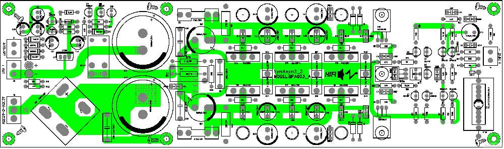

Hi JimS
Thanks for suggestions. I moved the input terminals so now you can
use Phoenix type terminals for the transformer inputs, and added vias to both sides of the Wima input cap to accommodate a larger cap.
I also added a couple leds after the fuse that serves as a blown fuse indicator, and holes to mount U3,U4,U5,U6 to the main heatsink. I tried to figure a way to fit a hole on the board for mounting the BD139 to the main heatsink but it's way to tight. So for the BJT version the BD139 still needs to be mounted to one of the output transistors.
Here's my latest board with all the changes mentioned above. This is my mosfet version of SymAsym. The BJT version is basically the same accept I have to swap to pins on each output transistor.
Best Regards,
Al

new board
Looks nice.
Couple of ideas:
1)Can you rotate c18 90 degrees and move it to the side of the speaker grounds to give greater access to the speaker grounds from the front of the board? It is tough to solder and remove with C18 in front.
2)For the BD139, what if you move c18 as per above, then you can then move c6/r26 and speaker-out closer to the big caps. Then you can put a hole in the middle of the board for mounting the bd139 directly to the heat sink.
3) Also, bypass holes for C1 would be nice, even if you have to attach below the board. I would like C1 spacing even wider, but it looks tight. However increasing the whole size for C1, might make it easier to remote mount a larger cap.
Built another board yesterday, testing tonight.
JimS
