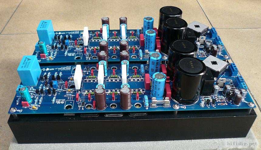

Symasym 5.3 "AAK model" builder's thread
YUP...like so.
...neat!
symasym_5.3
new symasym_5.3 amp photo
old symasym_5.3 amp photo

Nordic said:
On the Symasm page there are two schematics above each other
One from a simulator and one from eagle.... Follow the feedback chain.... There is a diffirence between the 2 (R30, C19, R29 Q2)
Which is the correct one?
http://www.lf-pro.net/mbittner/Sym5_Webpage/symasym5_3.html
Nordic: it does not matter whether 499R is before or after the parallel 470u/100n. That is only difference I can see
