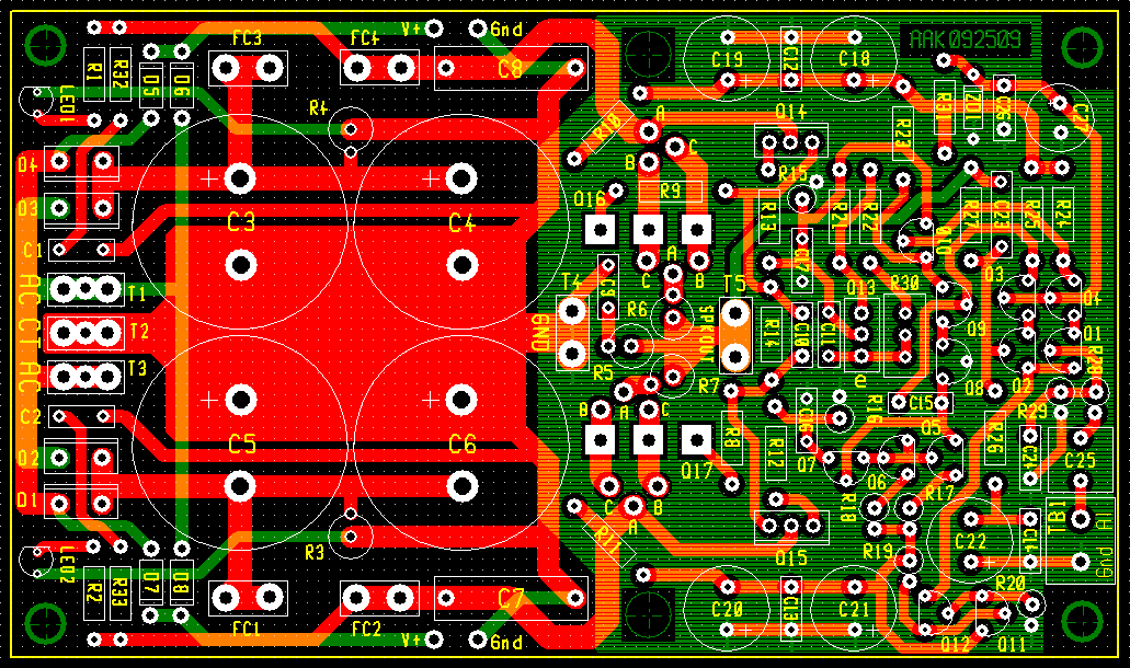

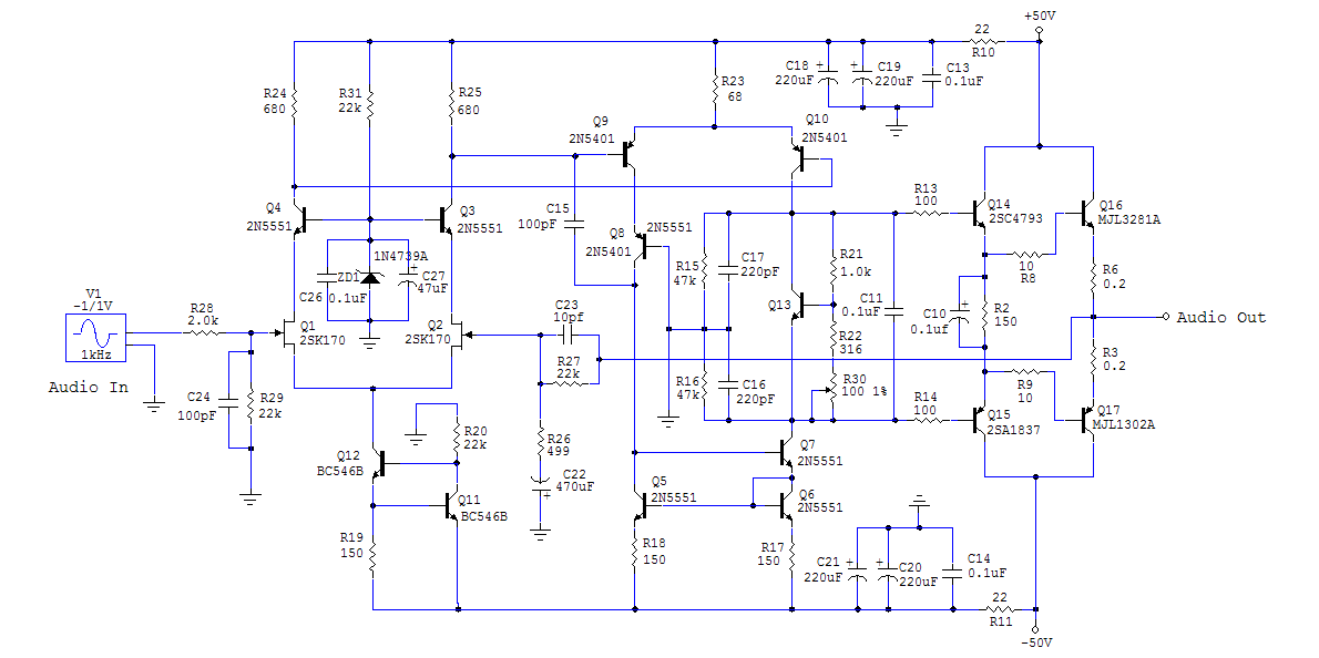

It's been a while but I'm glad to be back. I'm currently testing my new Symasym PCB (I know, long overdue) and I need some help on the design to make sure I'm not missing anything. Specifically I'm wondering if the bias circuit for Q3, and Q4 can be improved? Could it be the cause of a slight bit of hum that I hear with my ears right up to the woofer with the inputs grounded? My original PCB design is dead quiet.
I'll be posting some pictures of the assembled boards, and a pic of the PCB art work shortly. The board is the same size as the original (3" x 5") version
but with the added flexibility to easily configure the board to operate with different inputs and outputs devices. Here's the schematic.

Here's the PCB artwork. Adding Q3, Q4, and Q7 for the Wilson current mirror in an already tight space was no easy task, but I think in the end it turned out really nice. Anybody think that adding a cascode at Q8, and Q9 would be worth the effort?

The new boards ground scheme is basically the same as the original. Plus, when I put a jumper across the emitter and collector of Q3 and Q4, disable the bias circuit, and replace the 2sk170's with 2n5551 it's dead quiet. So it appears to only happen when I'm using the Jfet inputs. That's why I think it may be the bias circuit ZD1,C26,C27, and R31.
C24 and R29 connect to ground. The red trace is there to make sure that both pins are connected to ground on the top side of the board (green plane) if one of the through holes fails to connect. Probably not necessary, but it doesn't hurt just in case.

I'm no designer but here's an idea.
Is there any value in having a separate regulated power supply for the front end? But keeping the power supply for the main drivers on board.
Is any of this "plane" connected to another part of the circuit?
Could a hum voltage be imposed across your input circuit and create the noise you are hearing?
The green ground plane connects all the grounds in the amplifier section together and connects to the power supplies red ground plane found in the center of the board labeled GND. This is the star ground where the speaker's ground wire connects to.
It turns out that after looking into it some more last night the hum is only audible when the amp is first turned on but goes away once it warms up. So it shouldn't be a problem, but I will investigate it further and possibly try a different bias circuit for Q9 and Q10. Other than THD looks great, comparable to my original board and MikeB's design.

AAK is your PCB double-sided?
Besides, there is a reserve space to make traces more thicker for better audio performance and lower circuit impedance sake, if I'm not missing smth.

The PCB is double sided. The green layer is on the top side, red bottom. Signal traces are 52 mils which is more than enough. The power traces are 110 mils, they could made thicker but it should be Ok considering the trace length is 1.6".

I think if impedance of routs is lower it's always better plus more reliable traces despite there is nothing to sacrifice instead.
I presume that green layer is a ground plane. Have you thought using single point ground system, adding snubbers to PSU? It may have far better performance results.
I can't find R3 on your PCB, likewise R5, R7 on the schematic.
I guess two 220uF as C18-21 will have worse ESR than one 1mF cap.
Maybe you should try to place output devices on the bottom side of the board, due to better heat distribution through whole heatsink, cause it always coming up. Otherwise bottom side will be cooler than upper side. From this point it would be better I think if output devices be placed in parallel at the bottom center of the heatsink and between each other.
