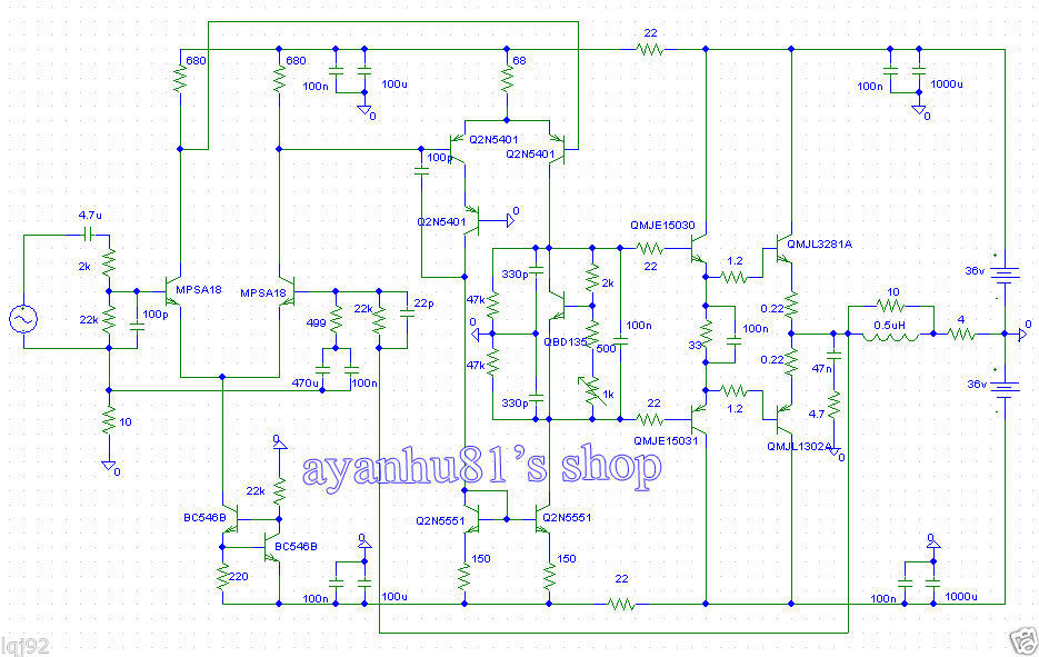

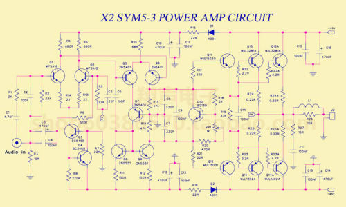

Hi, I've joined both schematics the 100w and the 150W for the 150w they add two more output and the rest seems remain the same diagram.
What do you think about...
Regards
Bigcat

Hi Bigcat 🙂,
You should get the full specification of power for a power amp : it is always given as xxxWatt on xOhm. The power supply provide you (doing the maths) with the maximum you can get from 8 (or 4) Ohm speakers : it is normally what could interess you. When you say 150W with the first schematic and 150W with the second schematic, you should understand that it is 100W on 4 Ohm, and the other one could be 150W on 2 Ohm ... It is mostly the same circuit for both ! On 8 Ohm, they will provide the same Watts with the same PSU. No it is not that simple to get more Watts using a higher voltage PSU : they are also some transistors that will burn (MPSA18), and other will become hot ...
Both schematics could give you 60Watt max on 8 Ohm with + and -36V that they use both. The difference with the doubled number of power devices is that it will provide you some advantage in THD if they are well matched. It relaxes also the SOA requirement as a double number of transistors will share the current needed by the load. Don't be fooled by the numbers ! The first schematic is plain the one they have taken from PMA or Michael Bittner our members here, and Michael Bittner :santa3: IS the one that did give to us all, for free, this very nice sounding power amp. The comments you read and report here are those from the chinese sellers. Sellers are always aware that more Watt is more appealing, and it will sell better 🙄 ...
Please, get some good book and read about power amps (e.g. High-Power Audio Amplifier Construction Manual , Randy Slone (R.I.P), Mc Graw Hill).
Best regards
rephil
