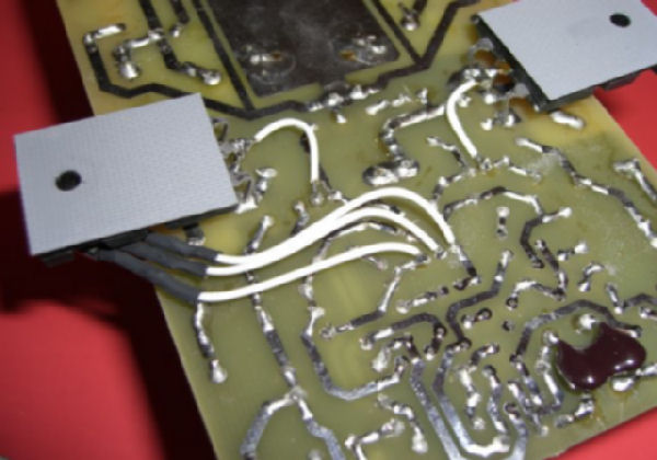

So far so good..(Bryan Adams)
My heatsinks are just as high as the PCB´s,70mm.So to make it work I guess i have to do sommething like this..
For Q1 and Q2 I have soldered some sockets,so that when everything is working like it should
I can try some J-Fets..
I bougt some matched smallsignal transitors for the fronend.
Now on to some boring case work..
