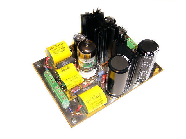

BTW I just completed a tube front end specifically designed for Symasym. It's has lower distortion levels than I thought it would have, but it does add some 2HD. Initial impressions are really promising. I still have about five different types of 6922s to go through.
Here's a pic.
Here's a pic.
Thanks roender for the information. I agree it's not necessary, especially if 2HD can be increased by other means. But, with symasym's low distortion some may like this option. I've enjoyed so far playing with different tubes and evaluating how each sound. It's all in the spirit of DIY audio.
