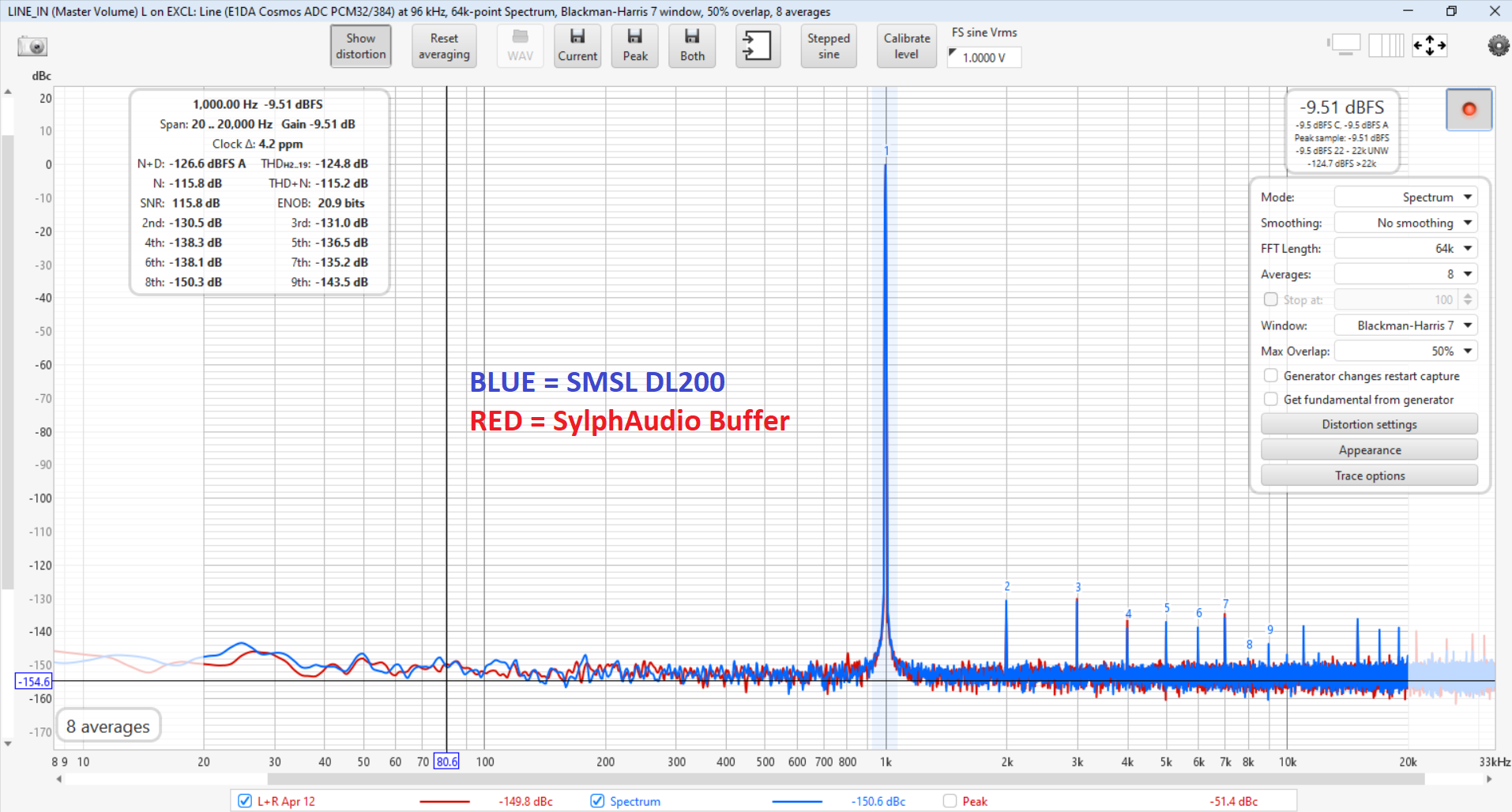

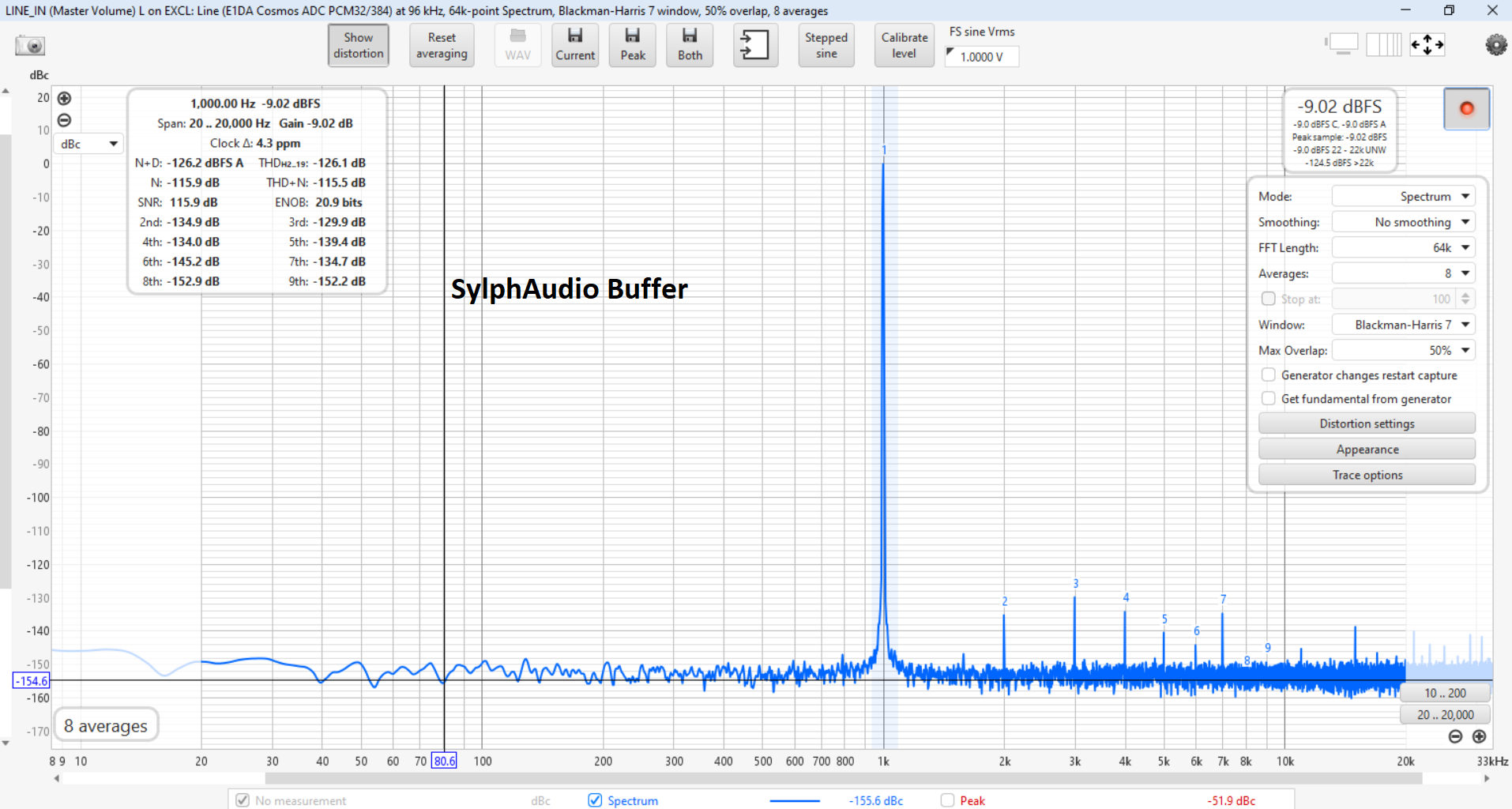

Sylphaudio OPA1612 Preamp / Buffer Performance
Setup:
Input Source = SMSL DL200 @4.96Vrms
Power Supply = LRS-350-36 @38V DC
Output from SylphAudio Pre/Buff module

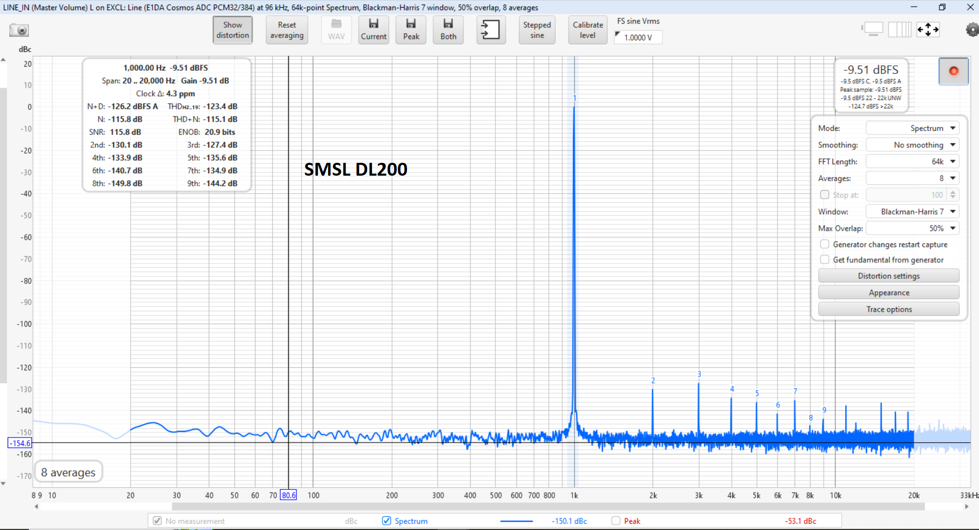

SMSL DL200 overlaid with SylphAudio Pre/Buff output
Setup:
So what are the differences please?haven’t tried to listen to them side by side. I think clarity-wise not much difference.

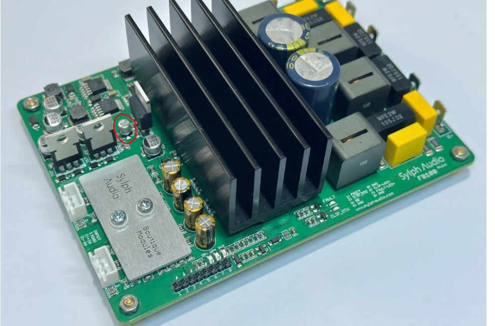

Have you now changed these modules in this way or is this just a modification that you recommend be made to your boards?For FB100 and FB360, removing the 22uF electro cap before the LM7812 reg going to TPA325x improves the sound. Verified 5W/4R FFT and 7812 output on scope and it's the same before and after. Same 22uF caps on ADJ of 317/337 regs can be removed without affecting the SINAD performance. Perfect warm neutral sound if those 3 caps were removed.
FB360 has a slightly perceivable micro detail, although it can only be noticed when you compared them side by side.So what are the differences please?
Removing the bulk electro cap on the input pin of LM7812 powering the TPA chip has a difference in sound. So yes, we removed it going forward. Power supply on the TPA325x chip affects the sound the most, I think.Have you now changed these modules in this way or is this just a modification that you recommend be made to your boards?
317/337 adj caps for the opamps, we retained it since it doesn't have much difference on my subsequent listening tests.
