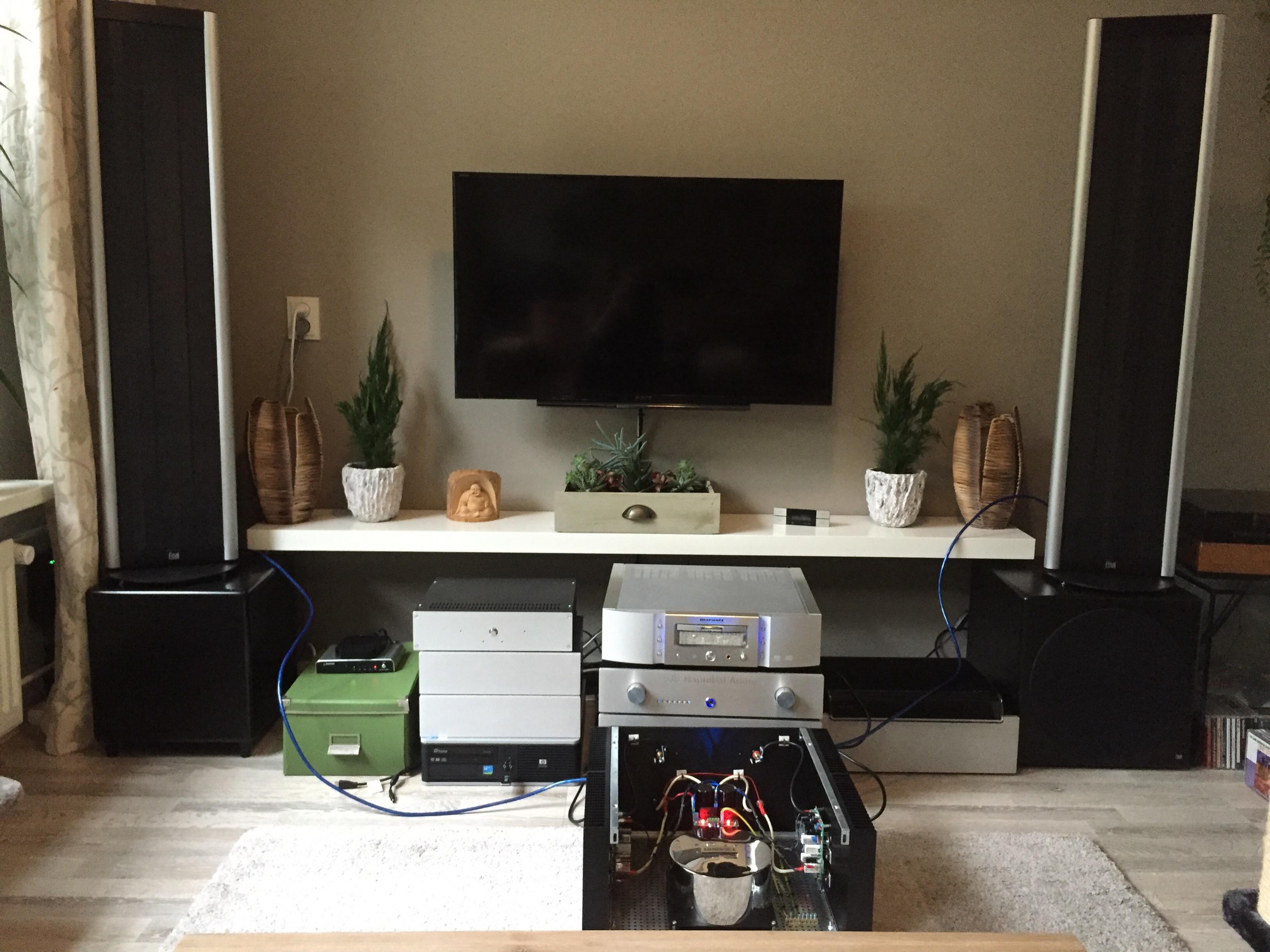

I have electrostatic panels. My Hiraga of about 45Watt class A sounds really good on them, but it lacks power..... Panels are voltage hungry... that's why I made the NX. More power and good topology.
In about 1 hour I will listen to the NX on the panels 🙂 I'm driving some Tannoy's now and it sounds really promissing.

Just hooked it up in the livingroom on the panels. Nice sound stage! Needs burning in, that's for sure. But first impressions: close to my Hiraga but a bit harsher on the highs and mids. Bass is just fabulous! Dynamics are really good. Lets give it some time to "age" a bit and see how it develops.
This is a really good amp! Panels are not easy to drive and they are dead honest. Any flaw will present itself without being nice about it 🙂 so if this was a bad amp, it would have been painfully clear from the start. As said, it is not! Very, very good!

Could it be I used the wrong resistors? Highs sound a bit metallic... Know what I mean?
I love the Kiwame resistors but they will not fit in this build.... Hmmmm..... I'm not very happy with the highs and mids..... Any thoughts anyone?

My guess is that you got used to the Low-fi of the Hiraga and are not used to hearing the highs and upper mids.I built 5 different Hiragas and all were low-fi sounding compared to all of my other amps.
True, that could be it. Hiraga's do have a lot of 2nd and 3rd harmonics as in tube amps. Listening to Sara K. On SACD now. Sounds really good!

Are those Finals [sp] you are driving?
If so, one of the toughest loads in the business at HF - they were referenced in an article by Keith howard in Stereophile.
Hi Bonsai,
Yes, those are Finals with modified PIO power boxes 🙂 And yes, very difficult to get good dynamics out of these. They need a lot of voltage and a very fast amp. NX does the job better than Hiraga in dynamics!

Hi-fi = accurate
Boosted 2nd and 3rd harmonics = not accurate.
My point is that if you are used to listening to amps that are not reproducing the highs accurately and ampt that does will sound "brighter" and even more harsh on some recordings.
If you put it that way 🙂
I still think I used the wrong resistors. My CD player is modded with pure class A output and does not sound metallic in highs anywhere. Not even on JK class A amps 🙂

yes, that is your problem. Big Loop Area.Note that there is lots of space in this cabinet. No separate wires even come close to one another.
You appear to have used coaxial for the input. That is a very good alternative to a twisted pair, if you have connected the screen/shield/Return at BOTH ends.
All your single wires should have a return route. The signal flow and the signal return should be run as a twisted pair.
This reduces the loop area and reduces the inteference.

Input is shielded Canare starquad, not coaxial. And the screen is only connected to the chassis part. Should be enough for stopping interference shouldn't it? Love to learn!!!
