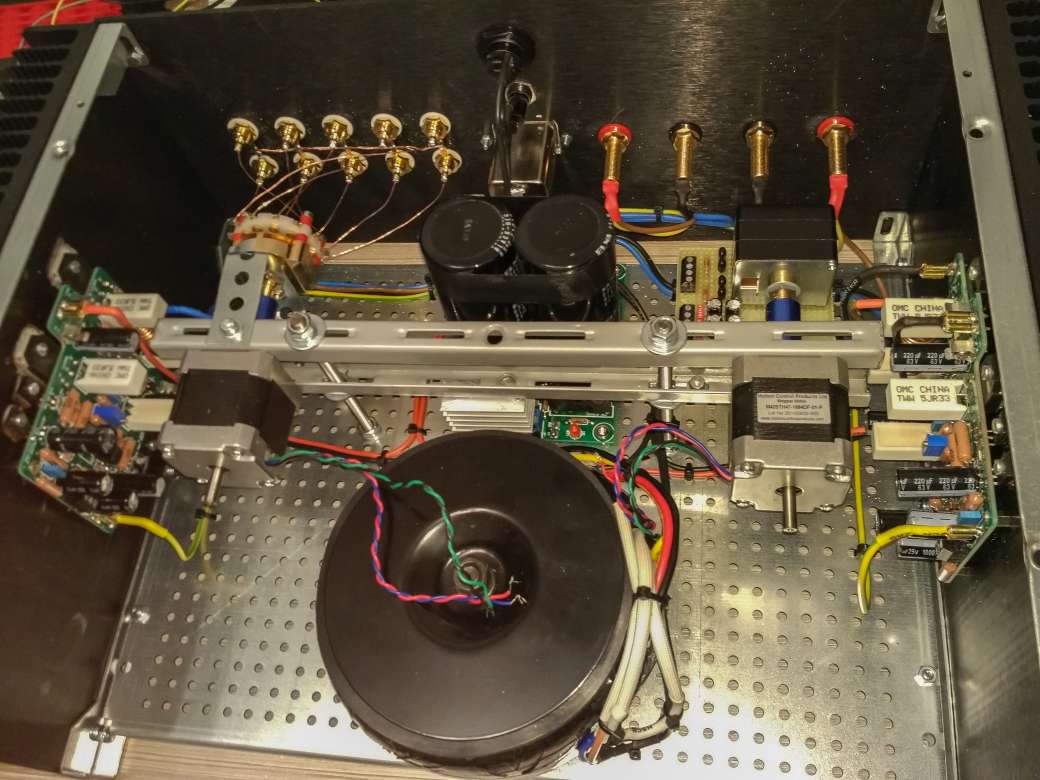

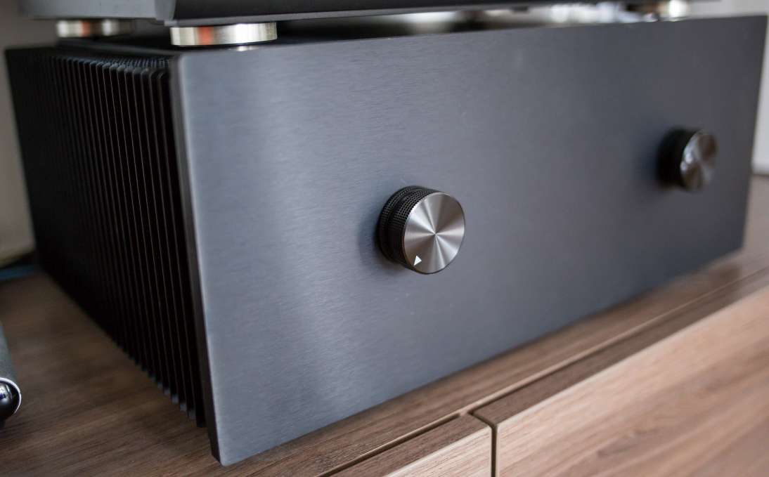

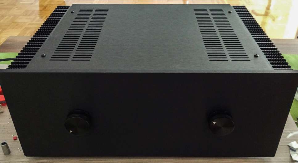

i've got the amp up and running, although i didn't resolve my issue with input dc offset, so i left out the bipolar (input) cap... so far my sources don't have a dc offset so until it's like that, no problem... output dc is in the range of few mv, no any buzz or hum, i'm pretty satisfied with that part, but i'm even more satisfied with the overall impression, the sound is great for me, also plenty of power and reserve for my visatons, just the amp i wanted to build 😉
attached a few pictures, final build is impressive, even the wife is amazed how good it looks, which is not a small achievement in diy projects, i'm sure most will agree 😀
btw, i've forseen the remote for the amp (hence the motors installation), but still no time for implementation, also the input cap is still an issue, so it's still not 100% completed, but right now i'm not bothered with any of that, important it's running... and it's running fast 🙂

Wow - that's very nice Petar - congratulations!
Very glad you like the sound - hope you get many years of enjoyment from your amp!
