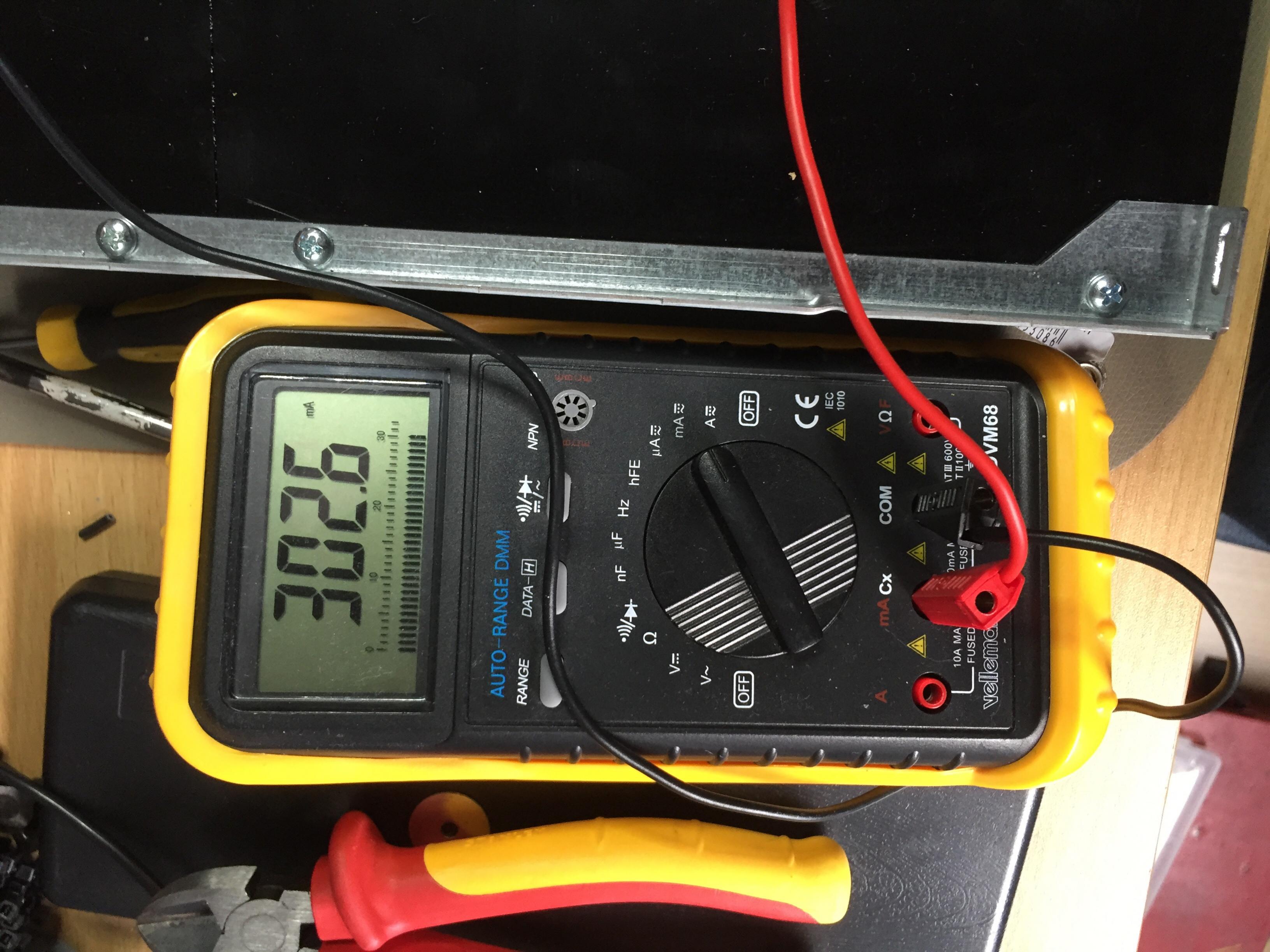

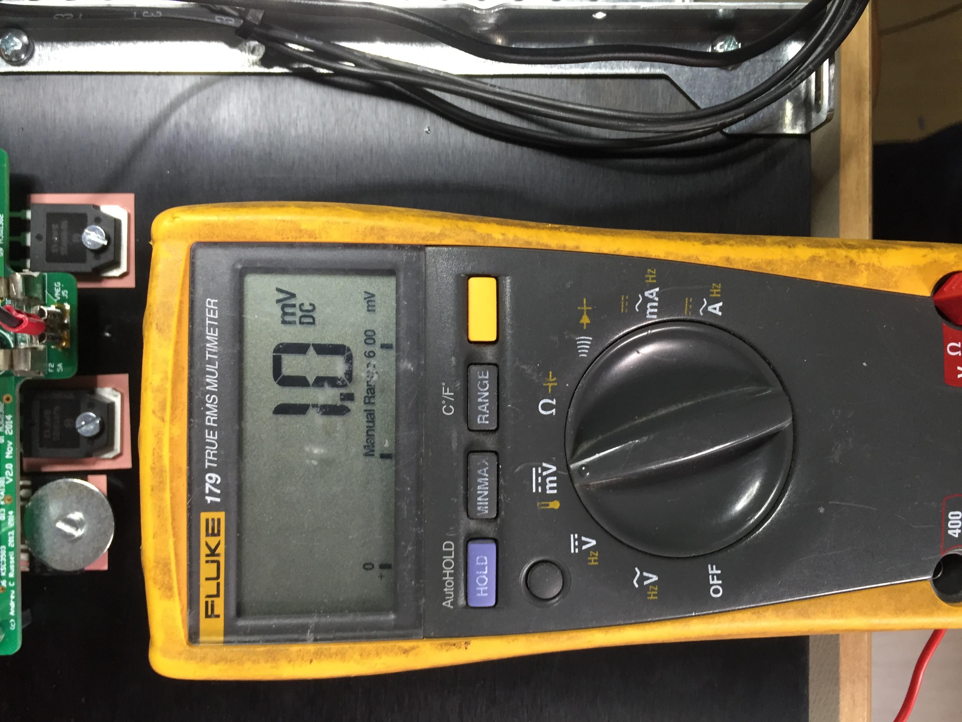

Ofset of left amp after 10 min.
That's correct Sjoerd - and it should be to within that level after repeated on/off cycles from cold.
With the complementary input structure on CFA amps as used in the sx and nx designs, the ~600mV Vbe's cancel leaving only small differences due to the transistors themselves of worst case 20mV. Thisis what gets dialled out with the offset pot plus any imbalance in the TIS stage halves.
