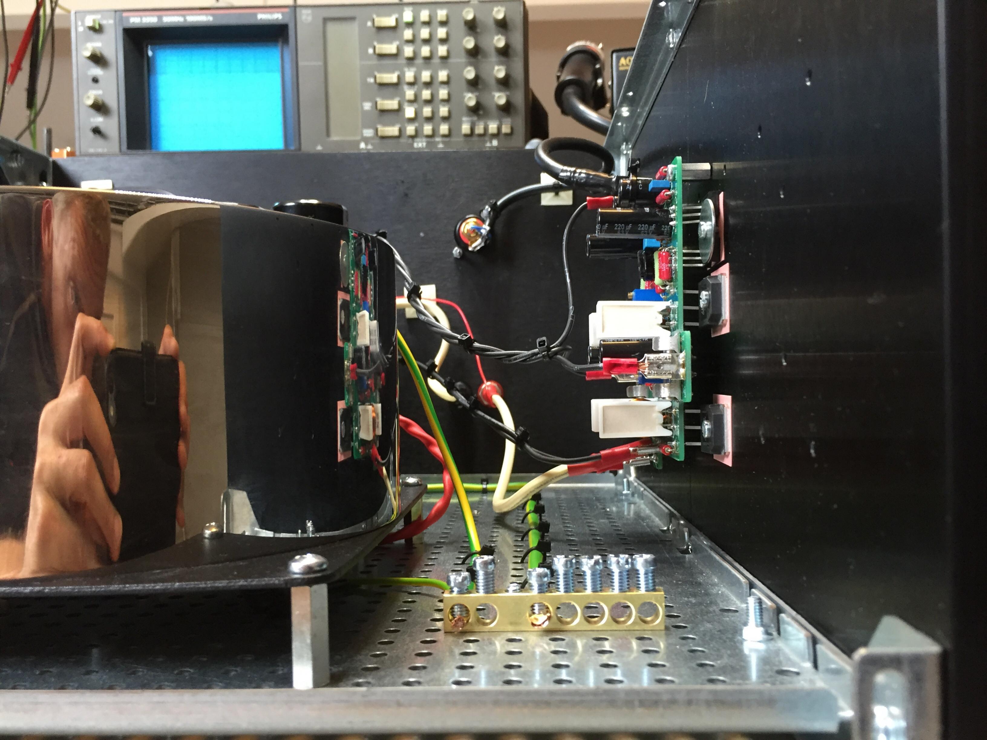

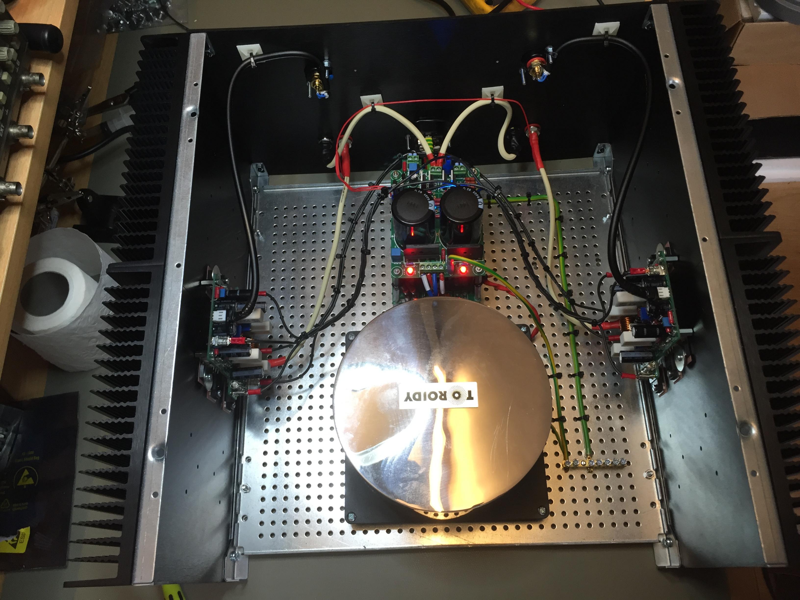

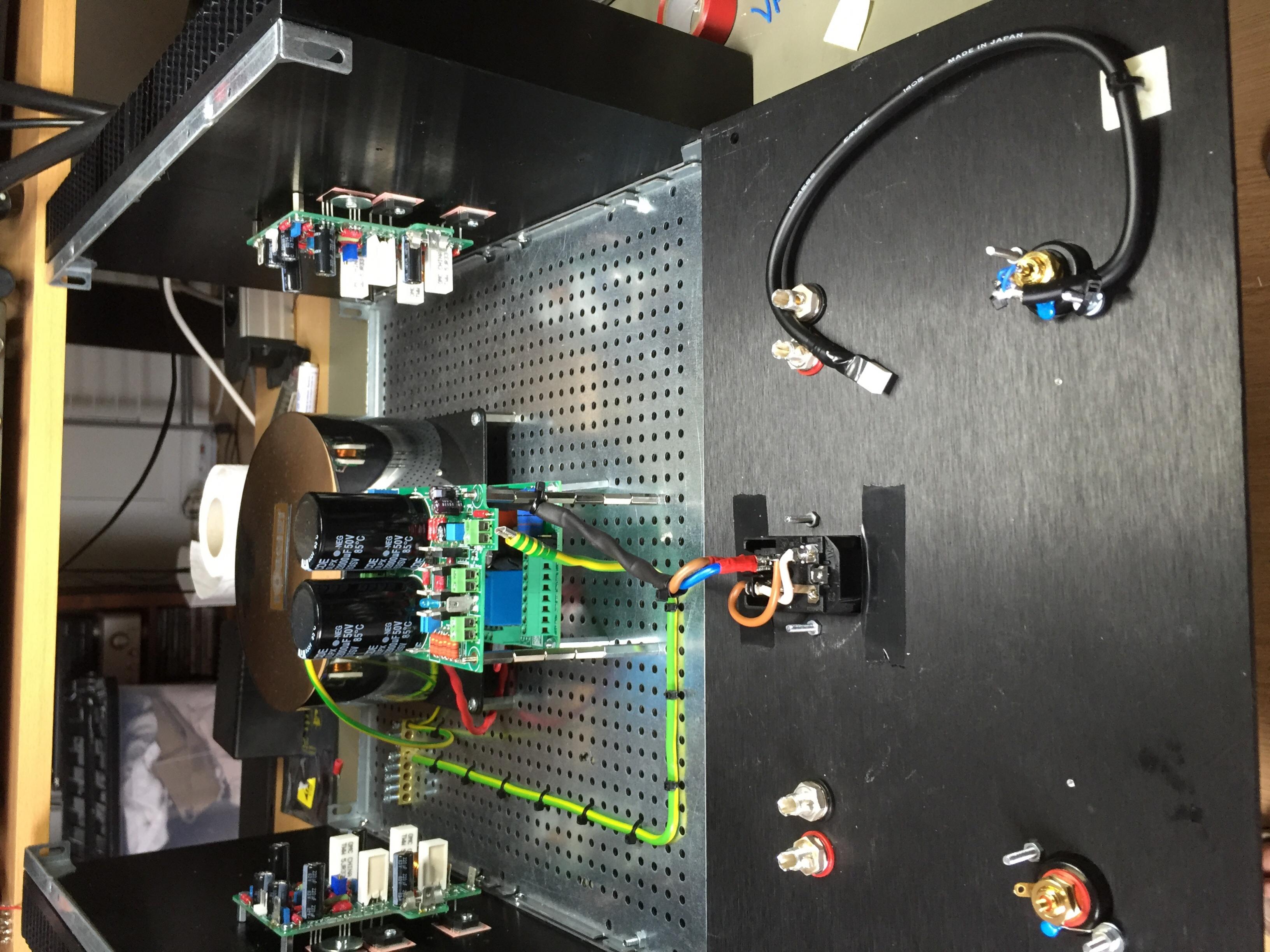

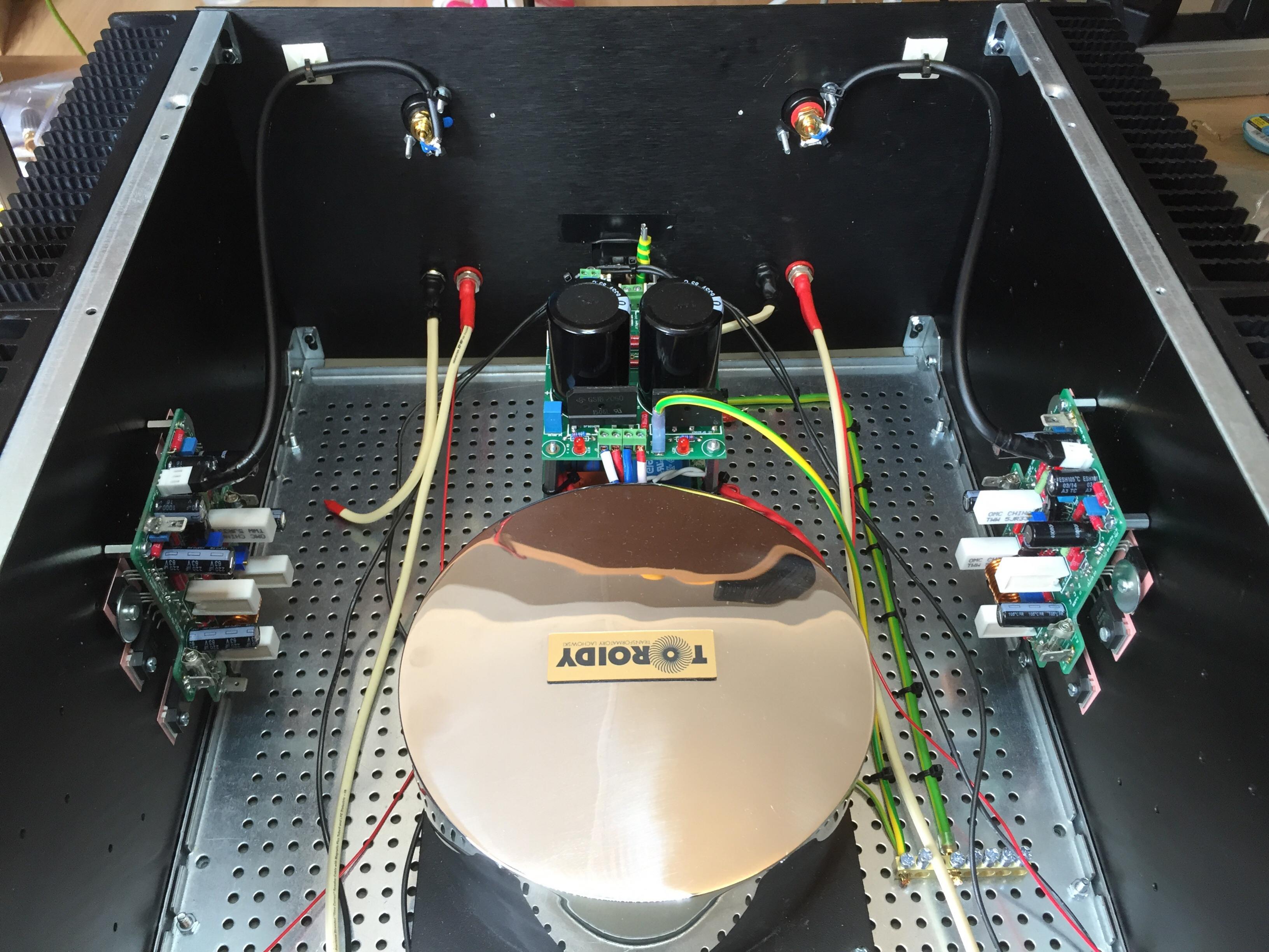

SjoerdSmits,
I am no expert on any of this and it appears you are spending your time to make the wiring very neat but I would think that Bonsai would recommend that you twist many of these pairs of wires together and not run all the wires as simple single strands in parallel as you are doing. I will look and see how Bonsai responds to my post. I would especially think the power supply wiring should be done this way.
Steven
Steven
Note that there is lots of space in this cabinet. No separate wires even come close to one another.
- SX-Amp and NX-Amp
