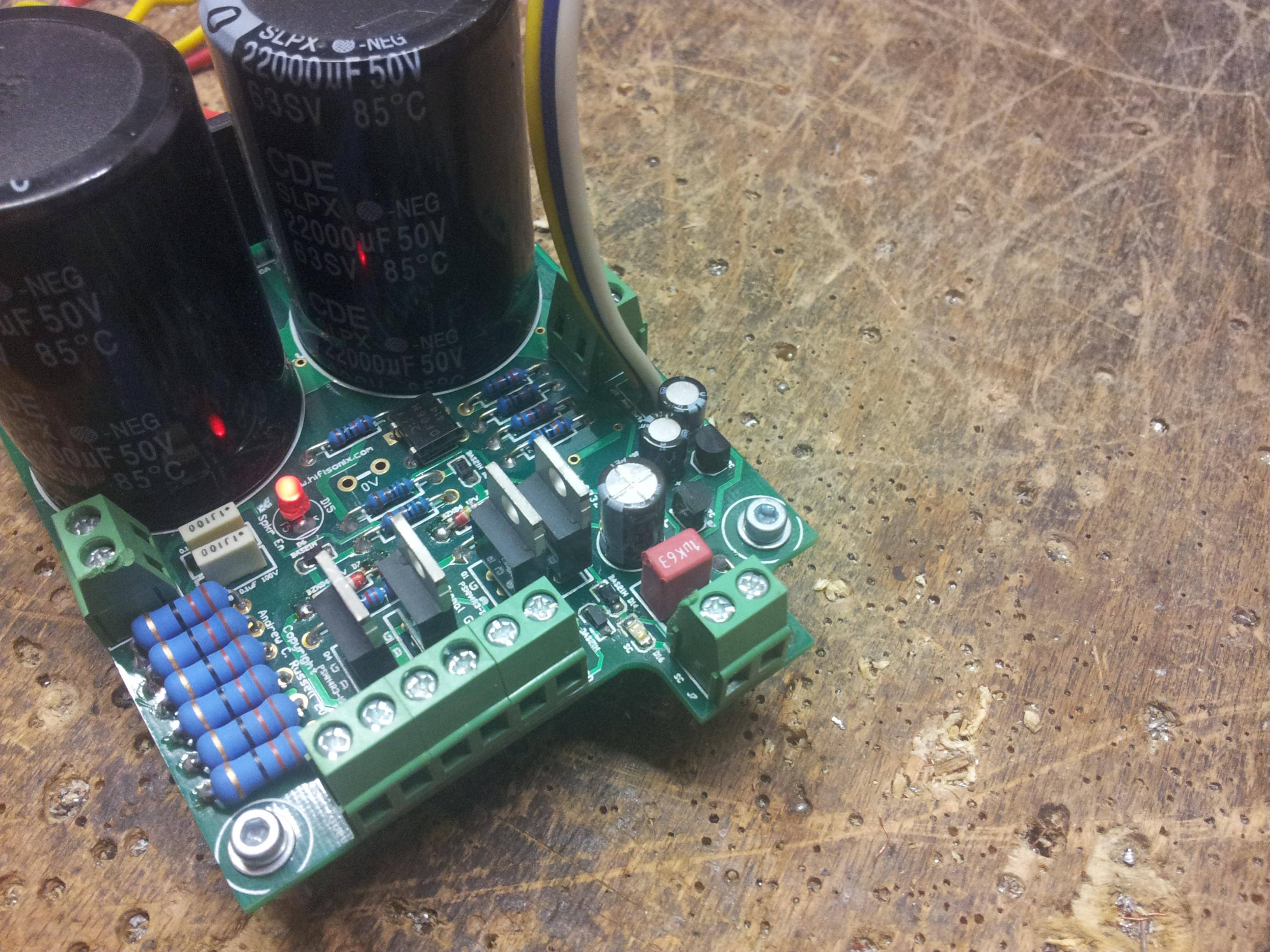

No, it still there. Bonzai said he would look at it, I'm still waiting for a solution.
Sometimes it sends an SC message to the PSU PCB and turns on the SS relay and the red warning LED.
But turning off the amp and powering back on does not defeat the SS relay.
It needs the PSU smoothing to discharge to near zero volts to allow the SS relay to untrigger.
That needs many minutes. Or take the lid off and manually add a 50r resistor to discharge each cap bank.

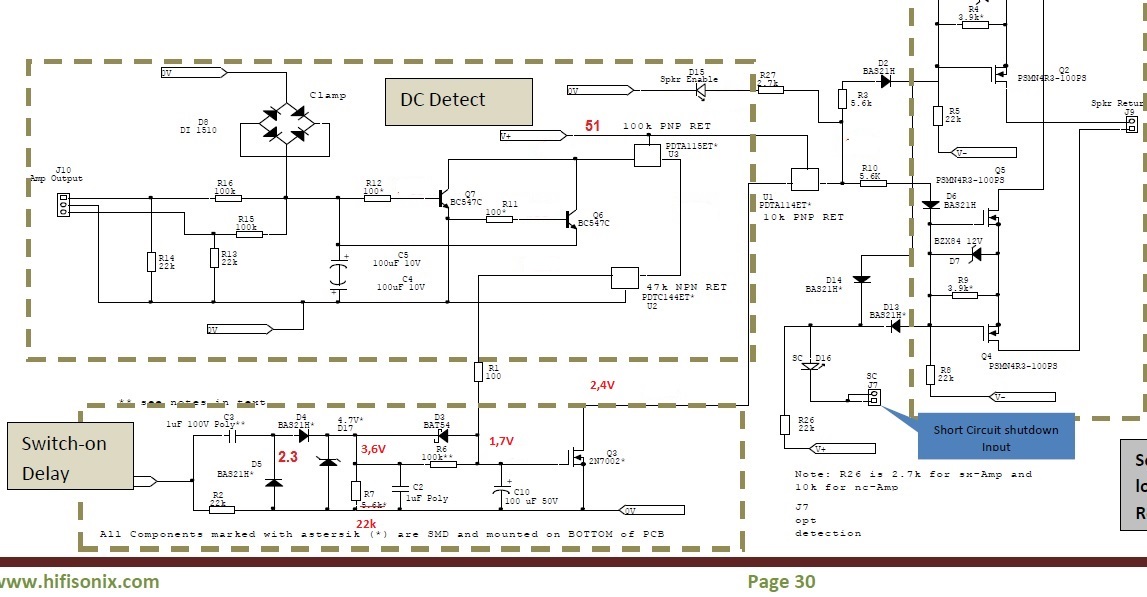

Platon, for your D15 problem, please look at the following
1. make sure C2 and C10 are installed correctly and working - if not, you will not have any delays
2. measure the voltage between 0V and the anode of D17 (4.7V Zener) - it should be between 3V and 4.7V after you have powered up.
3. Connect your meter between 0V and the drain of Q3. On switch on it should be close to your V+ voltage, and then after 5-10 seconds switch low. If it is doing this, then Q1 is probably faulty.
C2 is polypropylene.C10 is correct installed.D17 3,6V. Q3 gate 1,7V.
