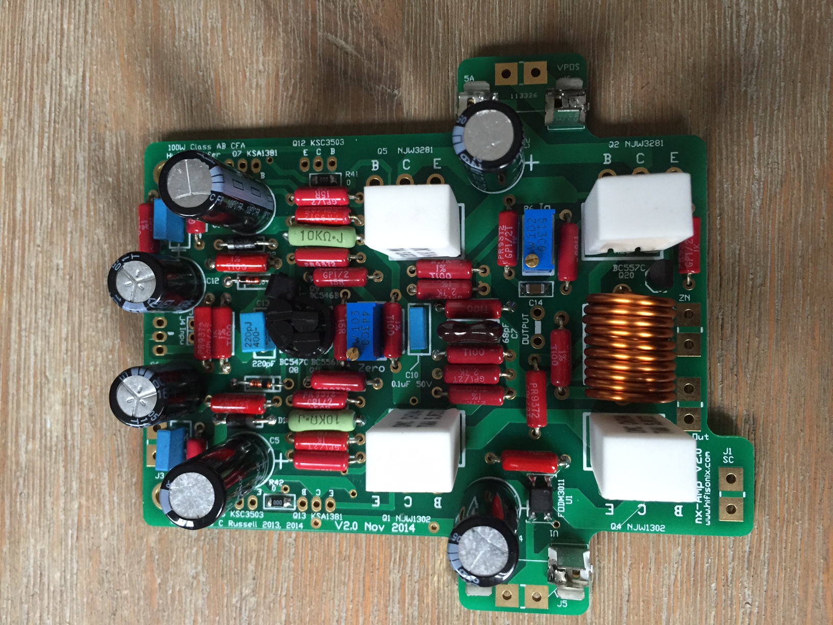

I probably missed something...... Going a bit nuts on the BOM versus the boards. Also with the BOM... it is a bit inconsistant.
I am at a loss concerning R28 and R29(NX)
Line 36 on the BOM says 15 Ohms
Line 45 on the BOM says 120 Ohms
What should I put on?
Cheers!
Cheers!
Ok Thanks!
Almost finished with all the soldering...... This was the last bit.... Just have to take out the 15 Ohm ones now and replace them....
Next stop: Casing!
Next stop: Casing!
