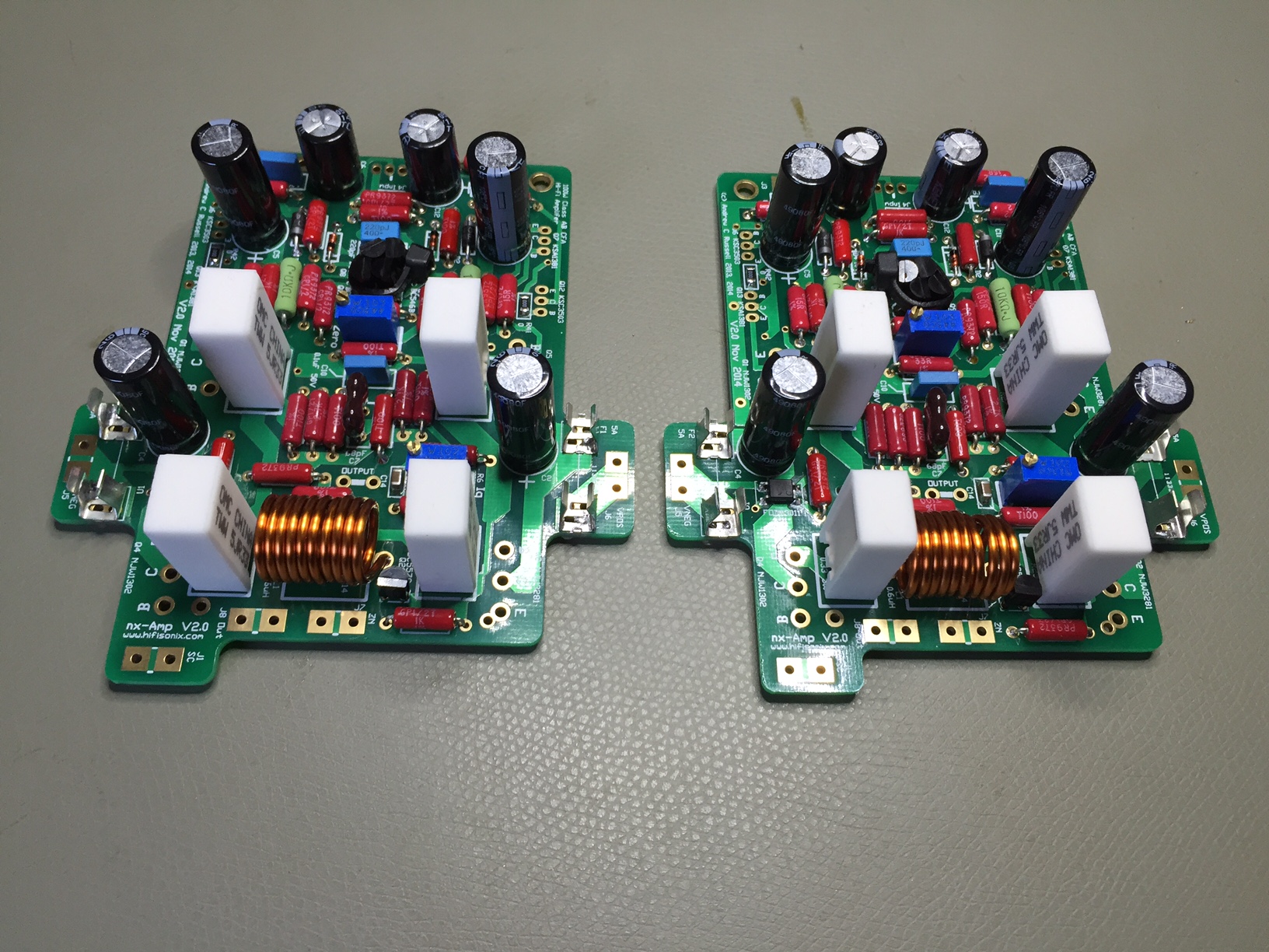

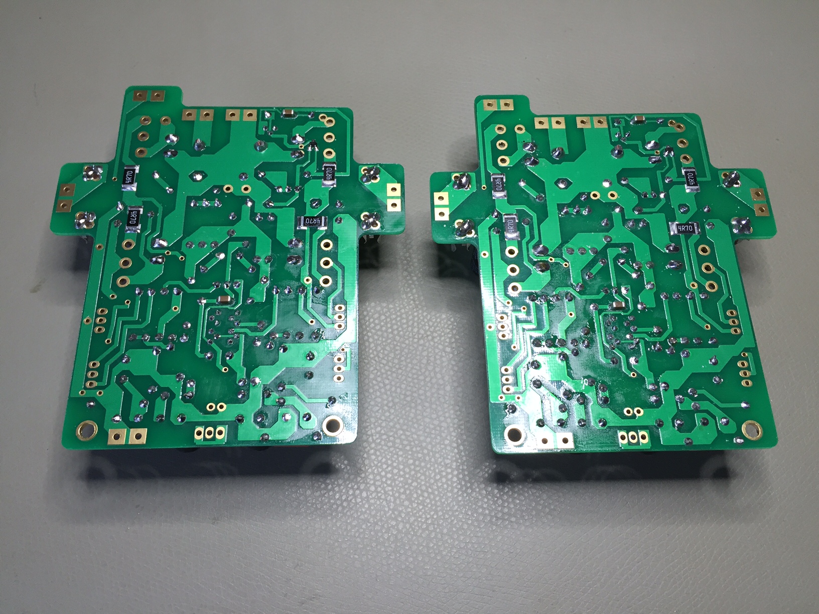

finished PCB's

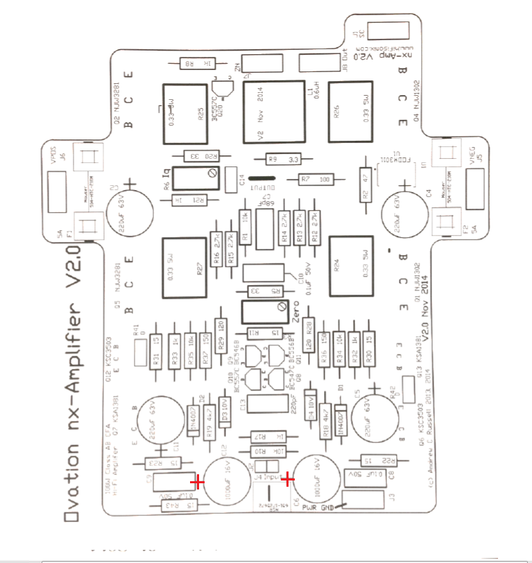

Sorted the misstakes of the C6 and 120 Ohm.... now for the heatsinks.....
I will not use any connectors on my build, only hard connections. That was a tip from a friend of mine. Not the easiest way, but worth it!

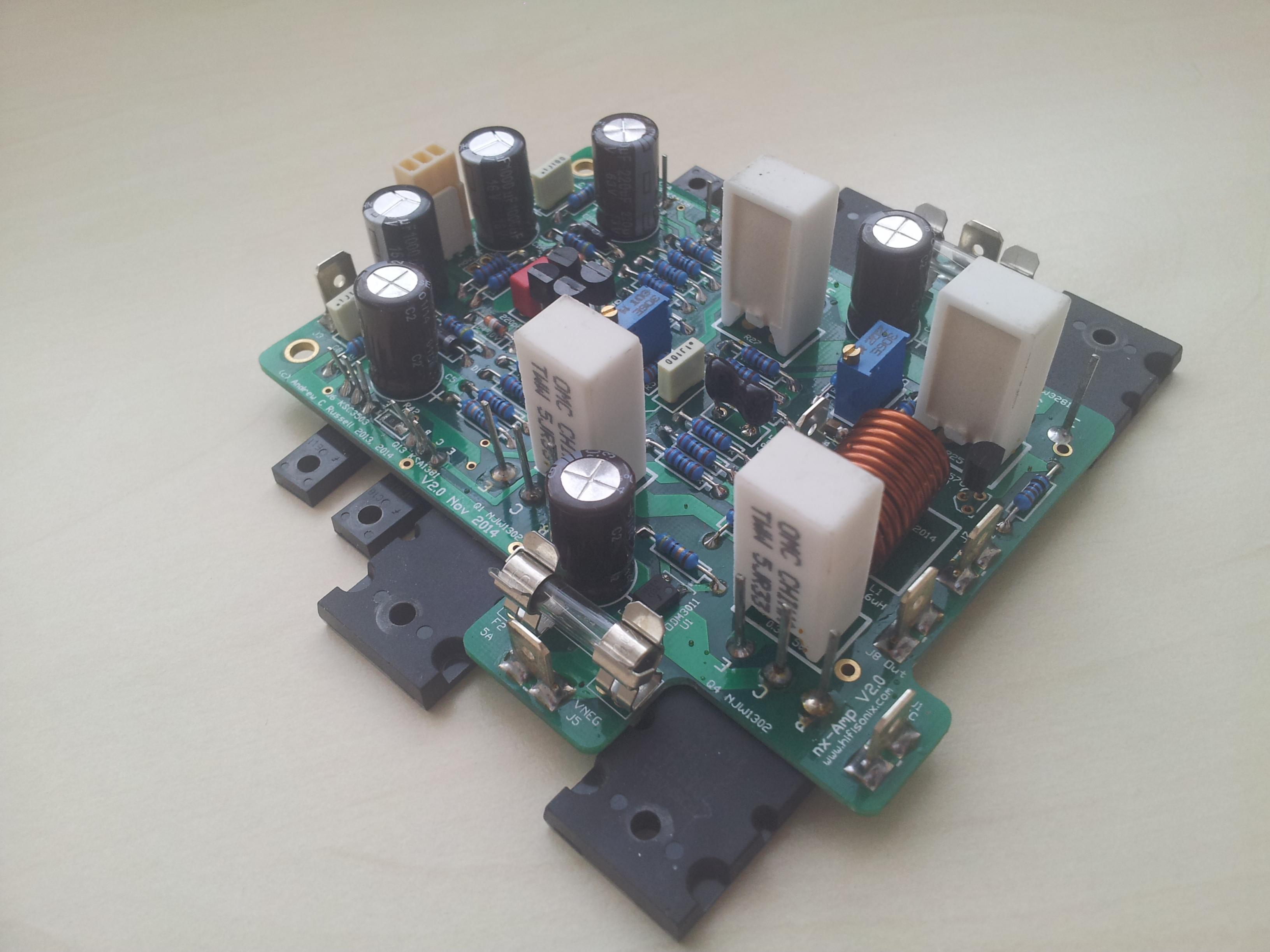

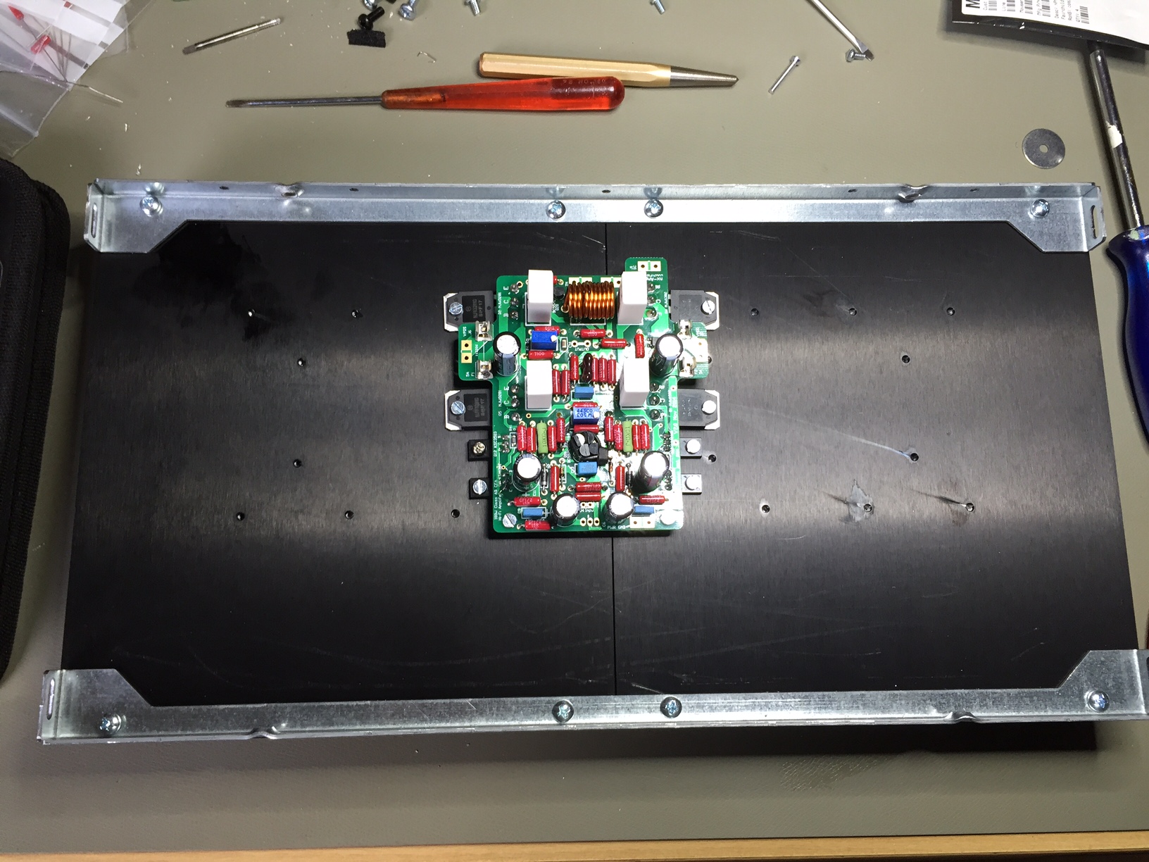

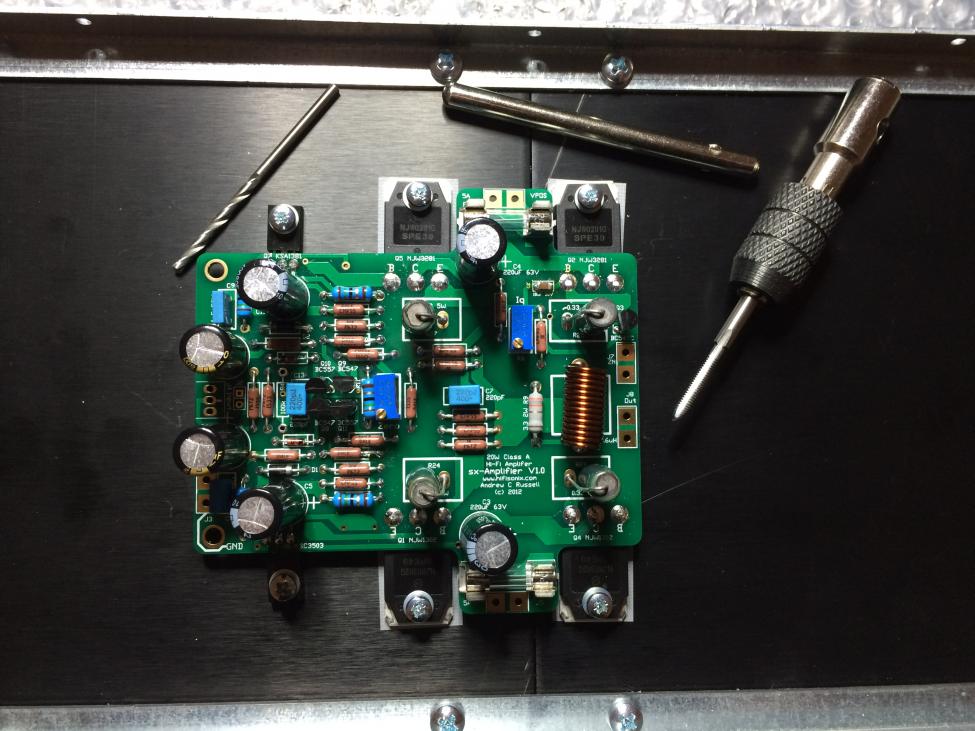

Trying to get the best possible heat dissipation.... This is a puzzle 😀
Any tips are welcome!
You can use a piece of copper heat spender under the transistors.
That would help a lot
6"X 6" min 5 or 6mm thick If copper to expensive you can use aluminium to but copper has superior heat conduct..
Mine is placed like this. (SX amp). It doesnt get warm
My heatsinks are huge. I got the 5U big Amp case... bit overkill I think. So I guess just placing the board in the middle, using both heatsinks equally should do it?
Ofcourse I will place the big trannies as low as possible. I will use Keratherm for good heat transfer.
I love the tip about the copper! Would look very good indeed! Could be I will go for that one 🙂
I don't like the idea of the PCB resting on the trannies.... So I will go for spacers.

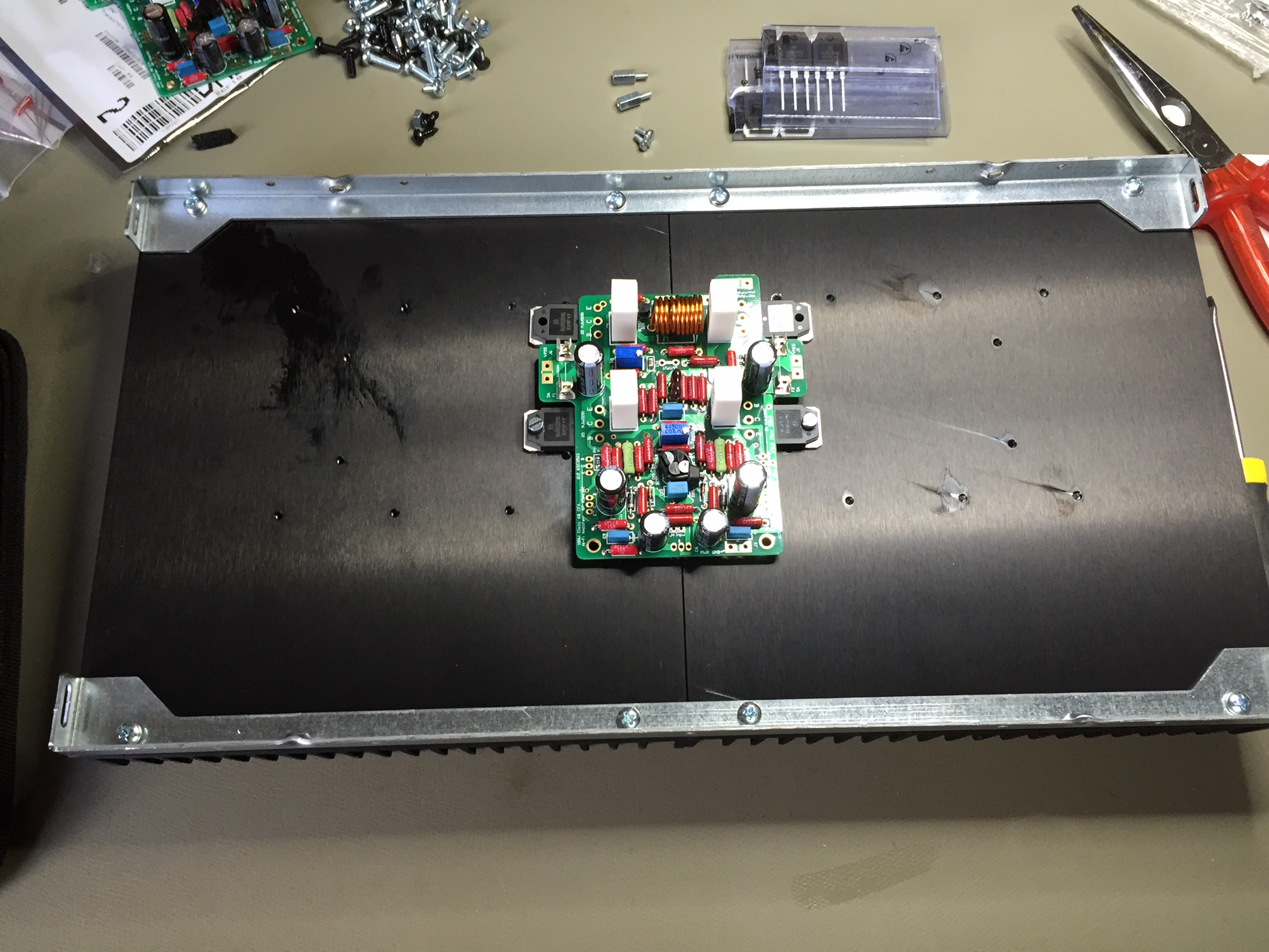

I will try that when I get the new one... No way you can drill out that tap! Much too hardened. Even my cobalt drills won't cut through.... Carma I guess ;-)
Ok, there it is. Number one is on.... But now I have to stop because I broke my M3 tap![]()
It happened several time with me to, especially when I tapped the copper and aluminium together...
We must use proper lubrication and a 1/4 turn forward and back again and again.. No drill driver!!!
Aluminium soft metal and if we tap it faster it will stick and break. When stick does not move neither way..
Incredible hard to remove broken tapper from the soft metal. No drill bit will work because always go to the soft metal when you try it. Not impossible (there is a special tool for that to remove it) but ad rather move the whole PC board a bit and restart the job. 🙂
