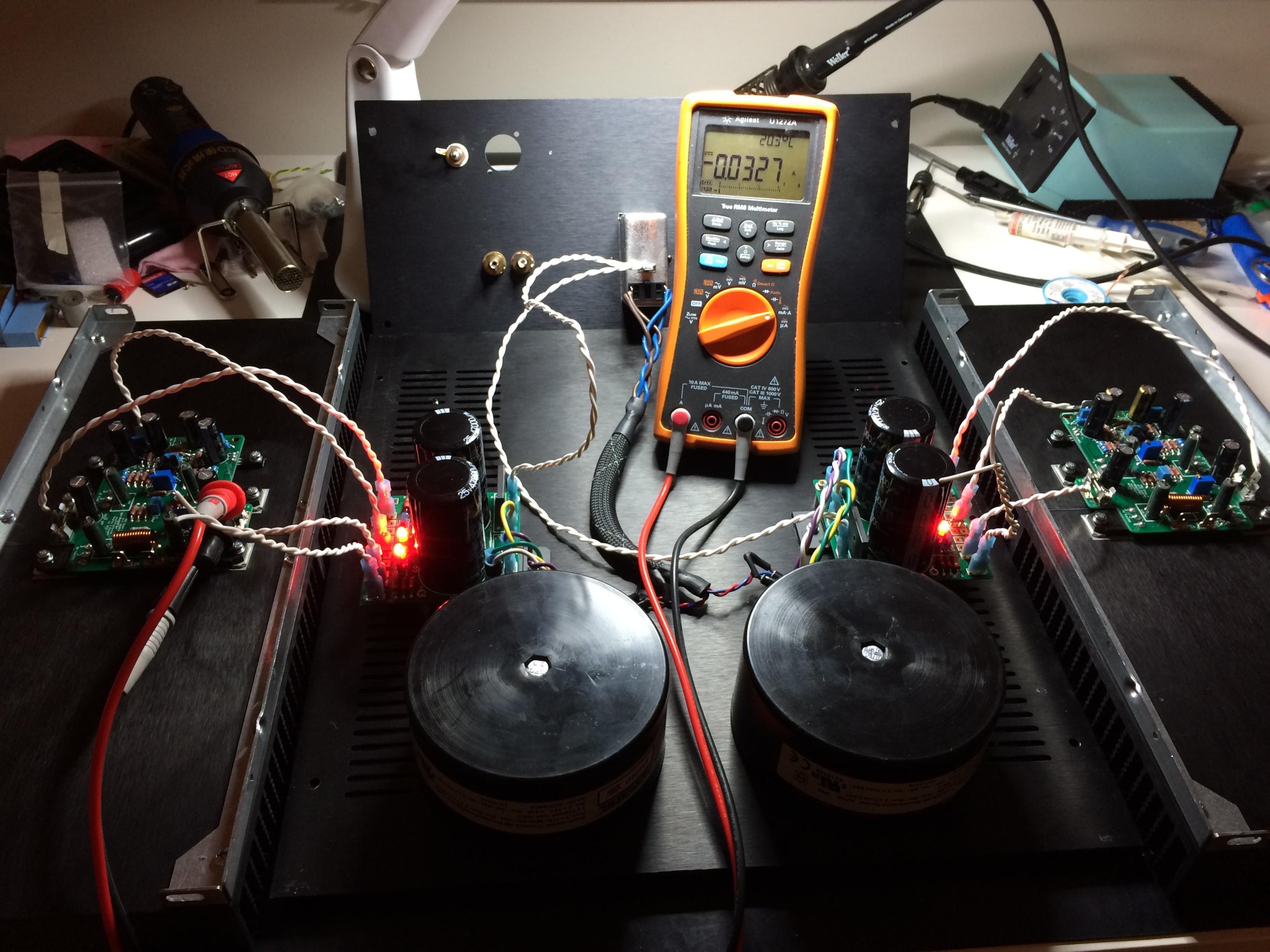

SX Amp is more or less finished. However got an issue when powering up.
Across +V fuse holder I measure 330mA (as it should be) when R6 is at max.
However I am unable to change this measurement when dialing R6.
It stays at ~330mA no matter what I do with R6.
This is for both channels.
I am pretty sure 🙂 everything is as it should be 🙂
Best regards.

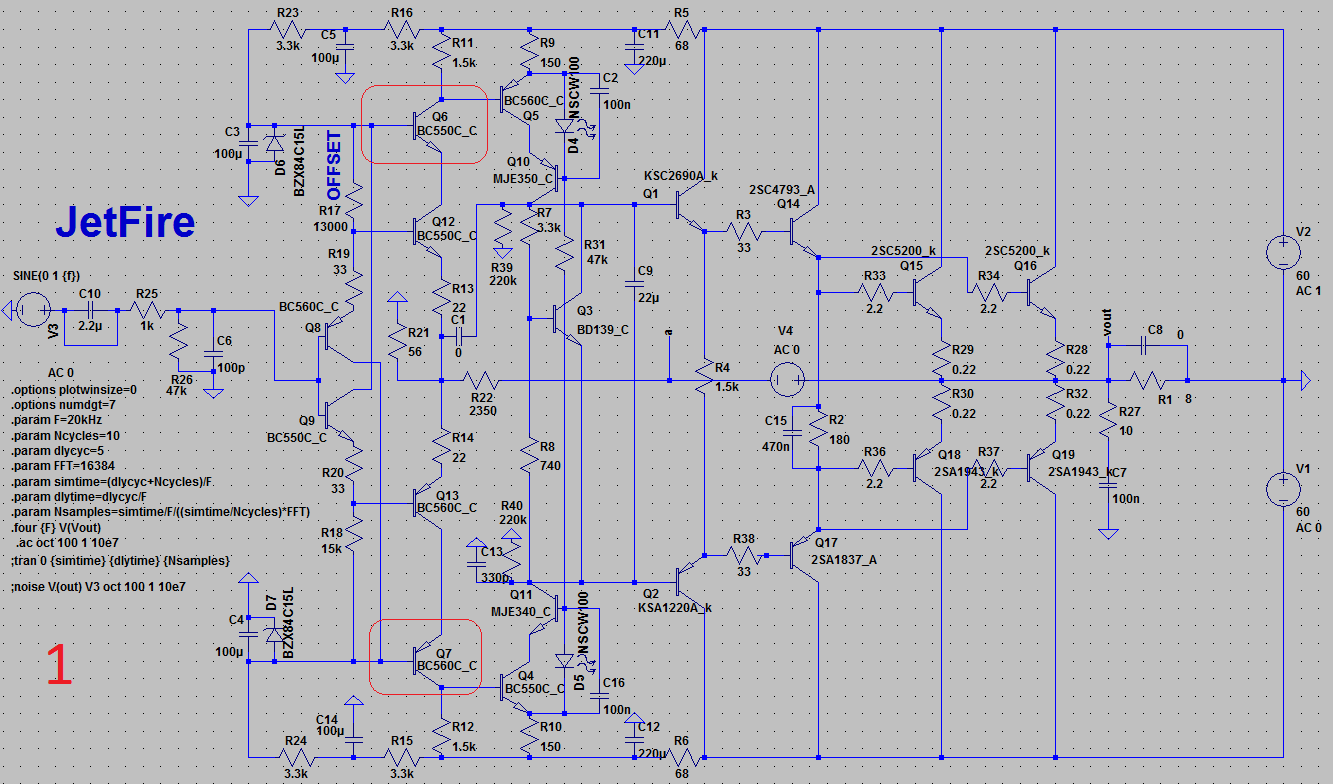

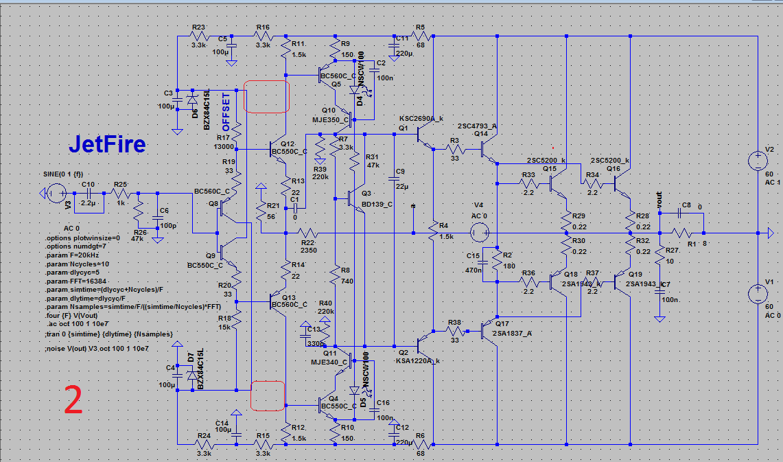

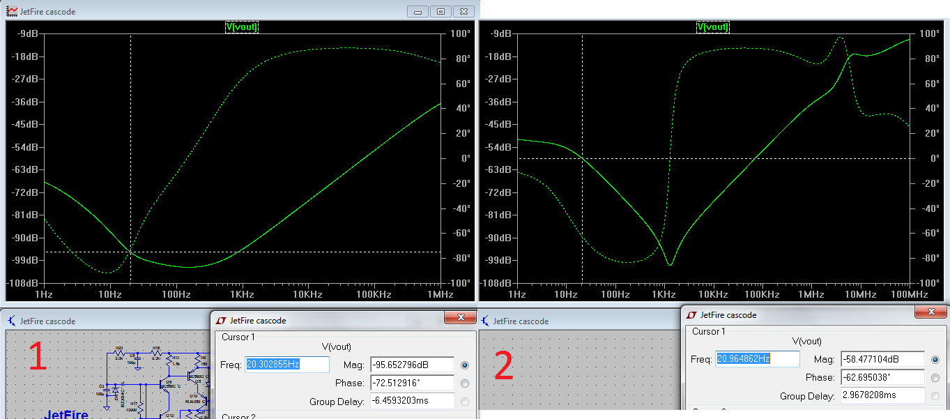

Sorry for spamming in your thread but I am looking a small advice.
I am working on the very simple CFA, very basic one. Bellow posted two schematics:
1.Includes extra cascoding transistor --> the PSSR at the low end looks a lot better.
2.Cascoding transistor is not present --> the PSSR looks way worse in this case at lower end.
My question is noise related: can I connect the bases of the cascoding transistors (marked in red boxes) to the zener reference +/-15V (the low noise zeners bzx55 series) ?
Or better to look for some other voltage reference (resistor divider) for the cascode transistors ?
Big thanks.
Peter

Hello Peter,
yes, you can connect your cascode as shown in your fig 1. I am doing the same thing in some of my new designs. The main advantage is you get the same voltage drop across all the diamond transistors, and if you run them at the same current (for me that's 1-1.5mA), you get good thermal balance and tracking, so the drift is then low. I have not specifically looked at the PSRR improvements you have noted, but based on other designs (e.g. like Blamleess) I would expect there to be some improvements.
