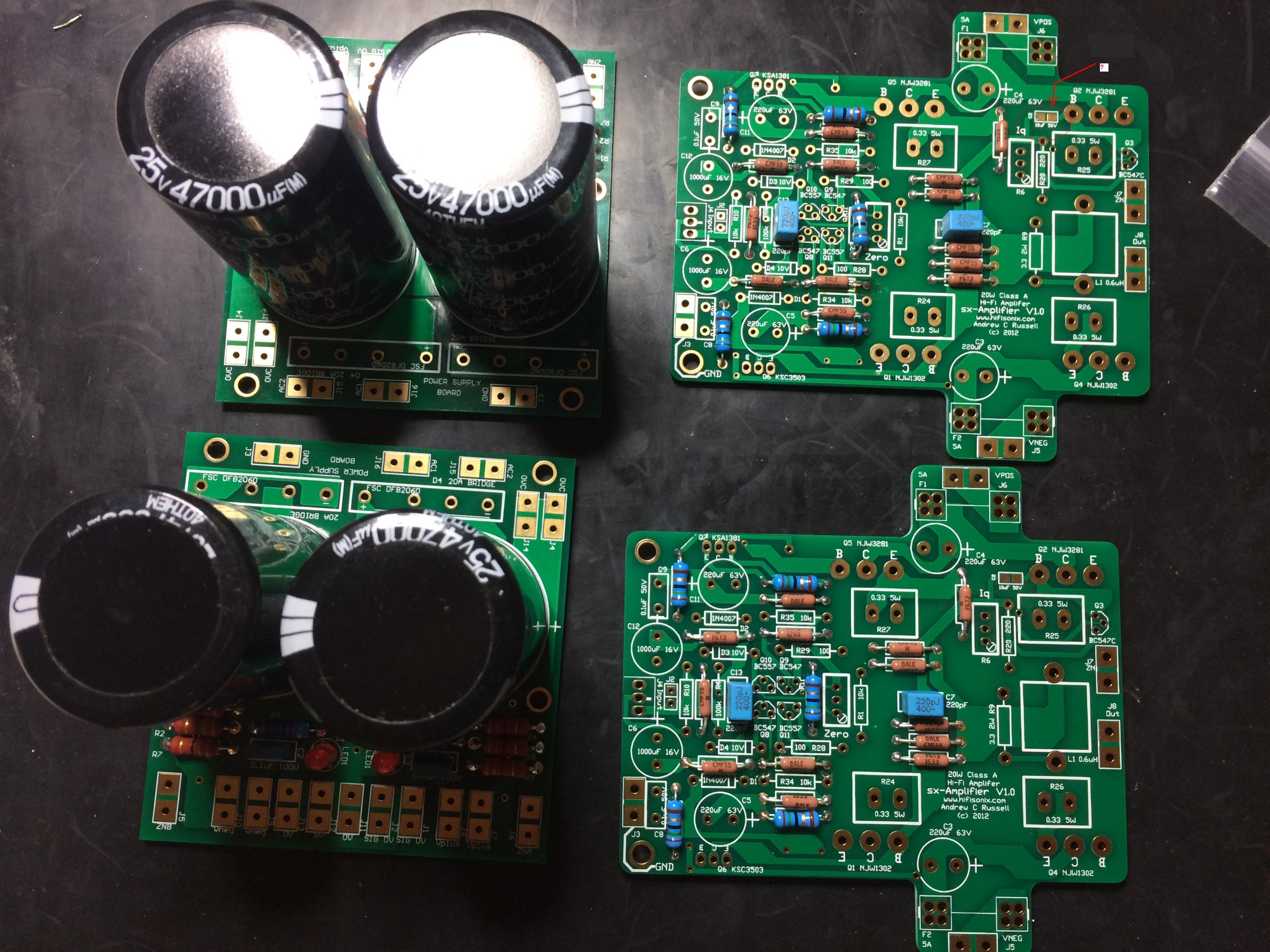

Another small "fault/difference" between the sx pcb and manual.
On the pcb from jims audio it says R20=220r.
The manual says R20=1k
I guess that the manual is correct here.
V2.10 Corrected value of R20 from 220 Ohms to 1k. Added distortion
plots; added single sided layout

However one more thing.
R4 according to pcb and "drawing" of the pcb in the manual says 100k.
The BOM in the manual says r4=15r
According to the schematic is is supposed to be 15r.
I guess it shall be 15r?
It is not mentioned anywhere else in the manual.

bambadoo - correct. R20 was increased to 1k reduce the adjustment range and prevent too much current to flow if you did not adjust R6 for Max (i.e 1k).
I have had the same feedback on the nx-amp - will make the updates when Jim does another batch of boards.
The last post is not editable anymore.

Correct - R4 is 15 Ohms.

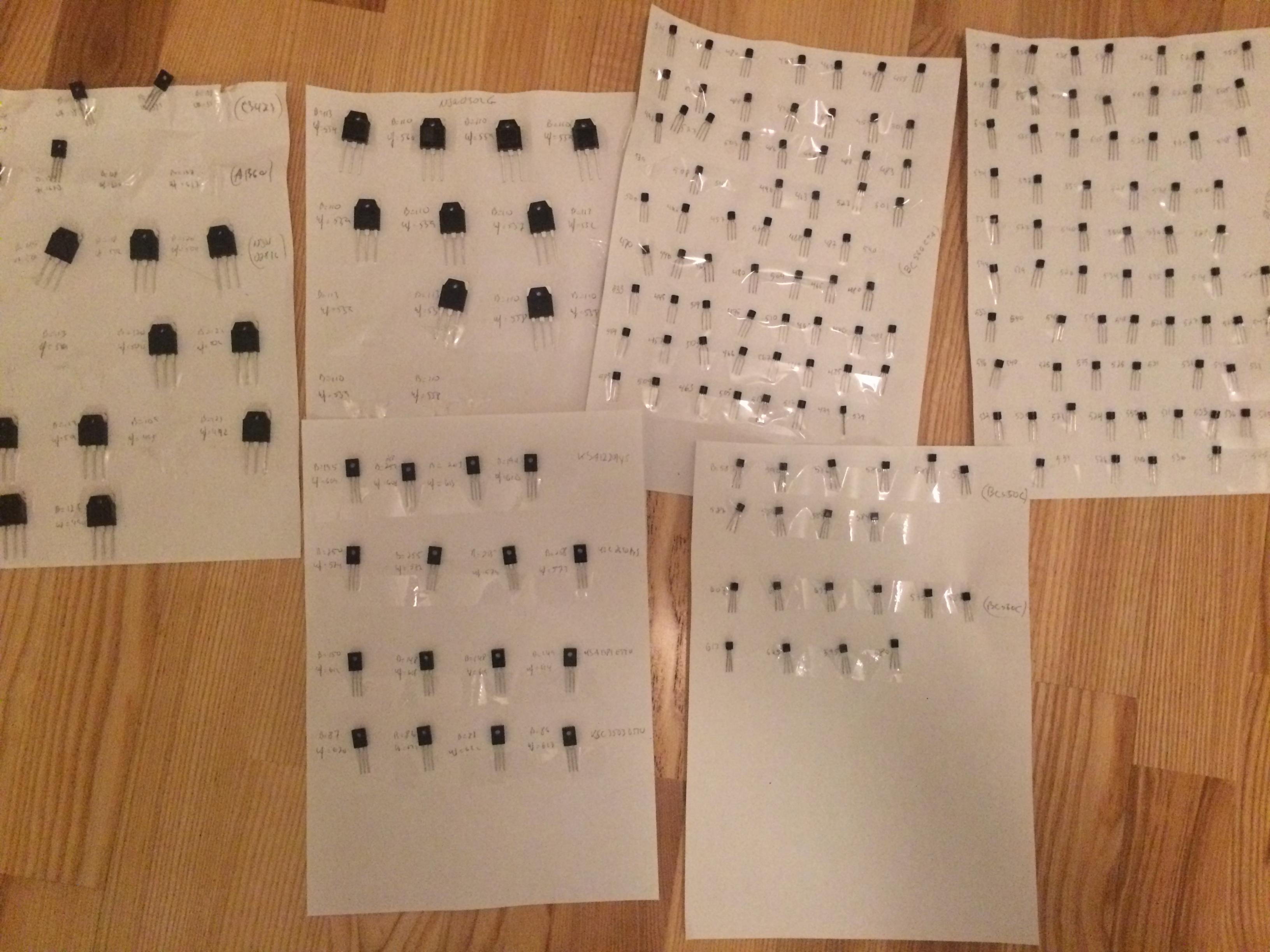

Not happening much but the sx pcbs are more or less finished. Mechanical work to do in 2016
Bastard work matching transistors 🙂

My thanks to builders Vinnie from Italy, and Bambadoo from Norway for picking up the R4 error. R4 should be 100 k and not 15 ohms as I posted in an earlier erratum. This confusion came about from an earlier version of the board. I have updated the 1st post to reflect this.
Separately, it was reported that the offset could not be completely dialed out on some amplifiers. I will come back on this in the next few days.

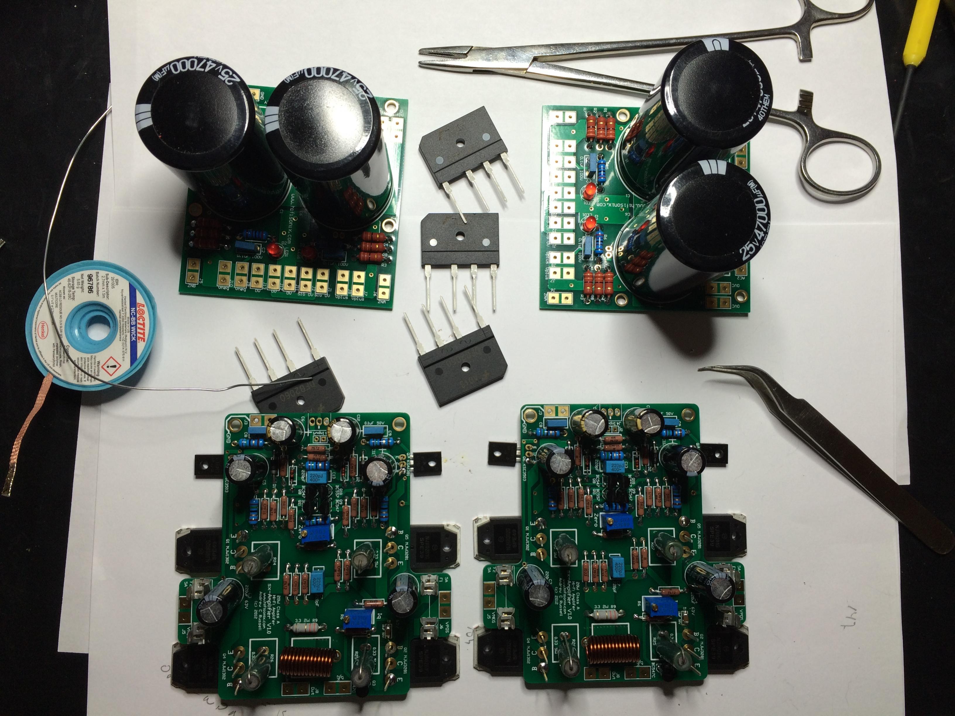

Wow - very nice build so far!
Thanks.. Getting closer 🙂
