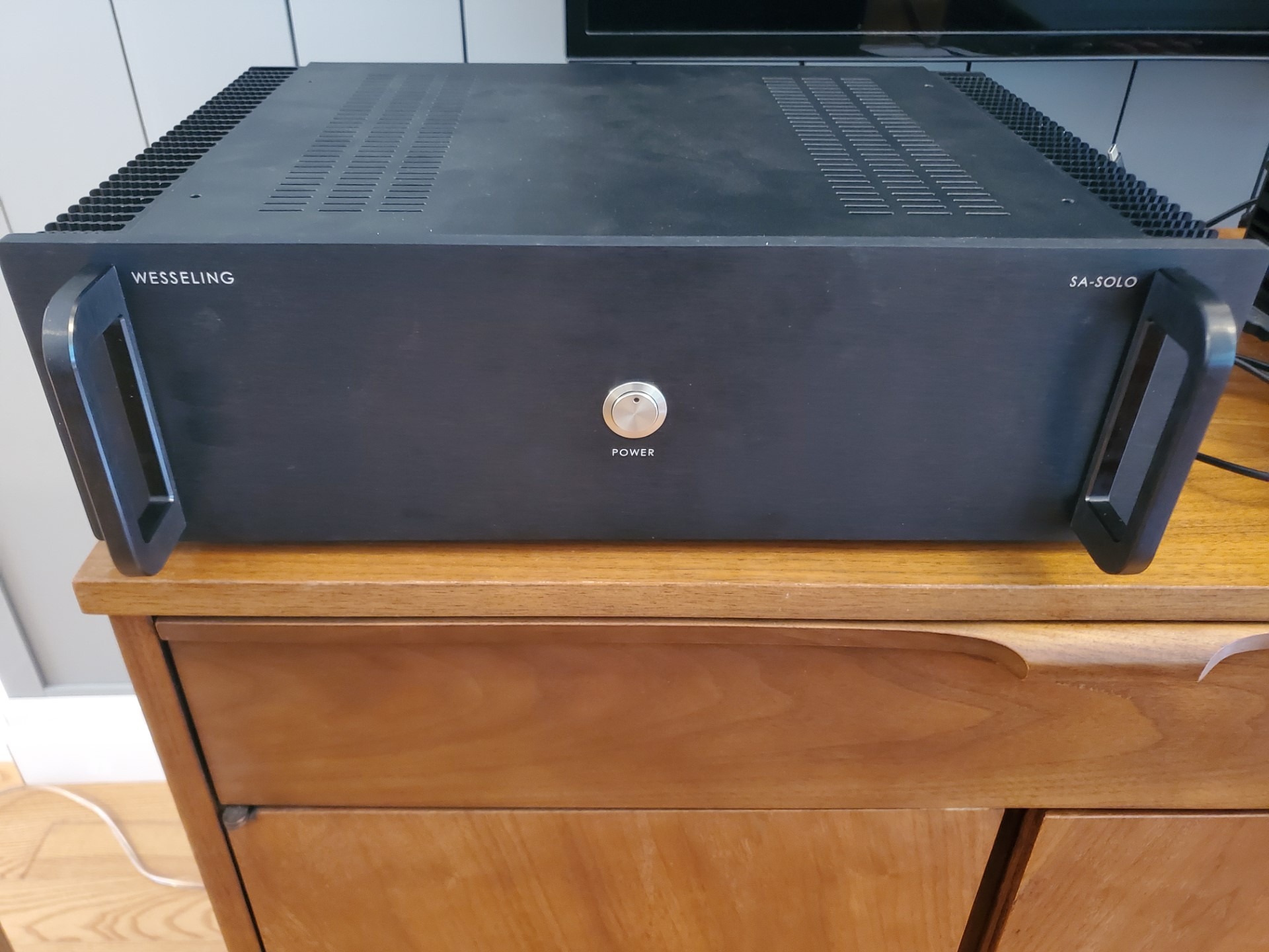

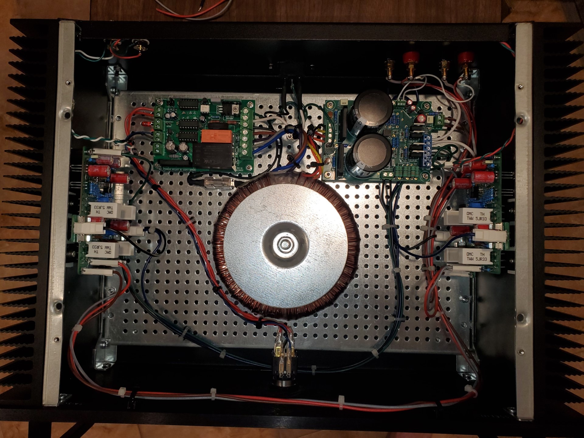

I'm curious what these heatsinks look like and how you determined what part to use. Would we be able to see inside this amp?Finally completed my SX rebuild in sheet aluminium case with porous ceramic heatsinks. It has the ripple eaters in too now. It sounds great.
Details in SS amps
Yes I have posted before on this method for building cases and in combination with Amec thermasol porous ceramic parts.

Thanks. It looks like you can really decrease the overall enclosure size with those ceramic heat sinks. I'm trying to decide on a plan for an enclosure and it was really helpful to see how you have things laid out inside.
What is the jack that is on the left side of the front face?
This was an experiment to see if what had worked with a dissipation of 30W could be pushed to 120W. I tried a number of layouts for different shapes and sizes, settling on this one as I like the overall form. Of course reducing the size of the amplifier and having the heatsinks internal means the heat has to escape mostly by updraft through the case. The inside of the amplifier does not get unduly warm -in the low to mid 40s C.
The jack is a good quality 4pin DIN for headphones. From the transformer dual secondaries, the amp is dual mono so the headphone channels are separate. There is a switch on the back and load/step down for the phones so I don't have to run two class A amps all the time just to listen on headphones for a bit.

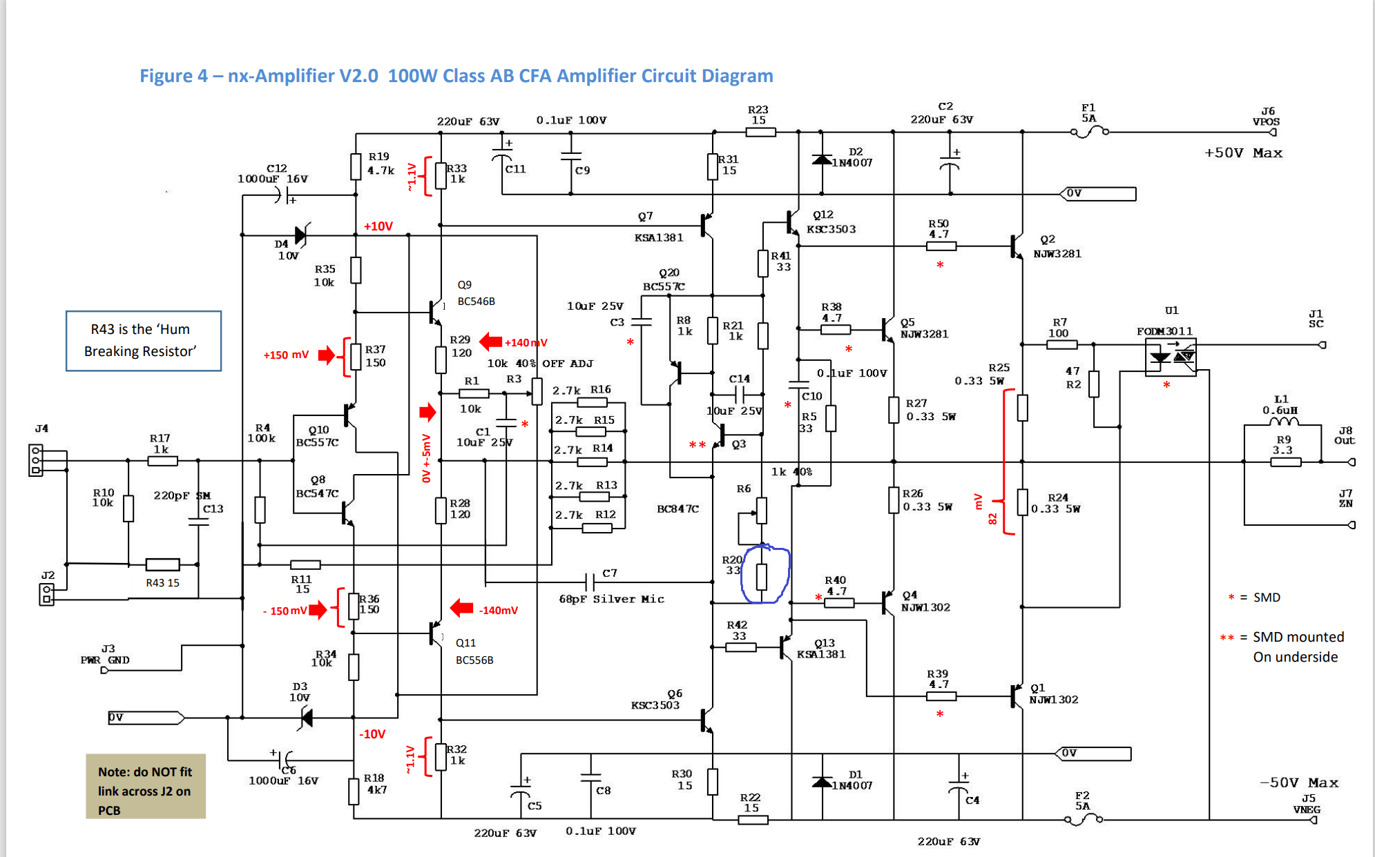

I'm in the process of starting up one channel of a new Ovation NX.
I have 700mv of DC Offset at full pot adjustment
All readings good until I got to measuring the DC offset.
R32 and R33 have 1.08V across them
Q8 is 547B, Q10 is 557B, Q9 is 546B and Q11 is 556B
Any suggestions?
Any suggestions?

Hi Joel,
You should not have to change the value of R1 - under normal conditions it should provide ample offset adjustment. Seems there is some other issue here we should look into. Firstly, adjust R3 so that you are measuring 0V at the wiper. This will allow us to see what the actual DC readings are without interference from the offset adjust circuit.
1. Can you confirm R36 and R37 = 150 Ohms and R28 and R29 = 120 Ohms.
2. Make sure R10 (10k) is in fact 10k - measure between the bases of Q8 and Q10 and 0V for this measurement.
3. If you have a gross Vbe mismatch all in the wrong directions on these devices, it could lead to offset issues on the sx and nx amplifiers. On the nx and sx Amplifiers, the output offset adjust was injected into the inverting input, so the required offset current is higher than is the case with my later designs that do this into the hi-z non-inverting input.
4. With that in mind, can you measure the Vbe across Q8 and Q10, Q9 and Q11 and then Q6 and Q7 as well; remeasure the voltage drops across R36, R37 and R28, R29
5. Also make sure the +-10V supplies (D4 and D3) are at 10V.
6. Can you confirm the volt drop across R24 and R25 is 82mV (do this measurement with no load connected to he output)

0V on R3 wiper = 1.28V dc at the output with no load connected
1. R36 and R37 = 150 ohms R28 and R29 - 120ohms
2. R10 = 10K
3&4. Q8 = ..608V Q10 = .590V --- Q9 = .601V Q11 = .443V
5. D4 = 10.26V D3 = 10.23V
6. R24/R25 = 78mv across them ---- R26/R27 = 81mv across them

That is not correct. I think you have a problem with that device. Can you change it out?
Pardon me. I was on the wrong side of R28. Yes I get 0.44v from Q11 base through R28
I'm measuring VBE on the connecting resistors. I can't very easily connect to Transistor leads.
I changed out Q11 and then realized I was on wrong side of R28
I measured all vbe again- Q11=0.599 Q9= 0.614 Q10= 0.592 Q8= 0.618 - All looks good except DC at output is 1.3V
Joel, have you shorted the input out? Please check that when measuring across R16 (power down with no load connected) you are measuring 540 Ohms and that R11 = 15 Ohms.

For NX R20 is 33 ohms in the schematic and on the regular BOM - circled in blue in the attachment
In the alternative BOM the value is 330 ohms
Is 330 ohms the new value? I installed 33 in the amp on post 2738 and no issue with bias adjust..
thanks!
close to wiring up another nx so thought I should ask.. A friend is taking my other one
