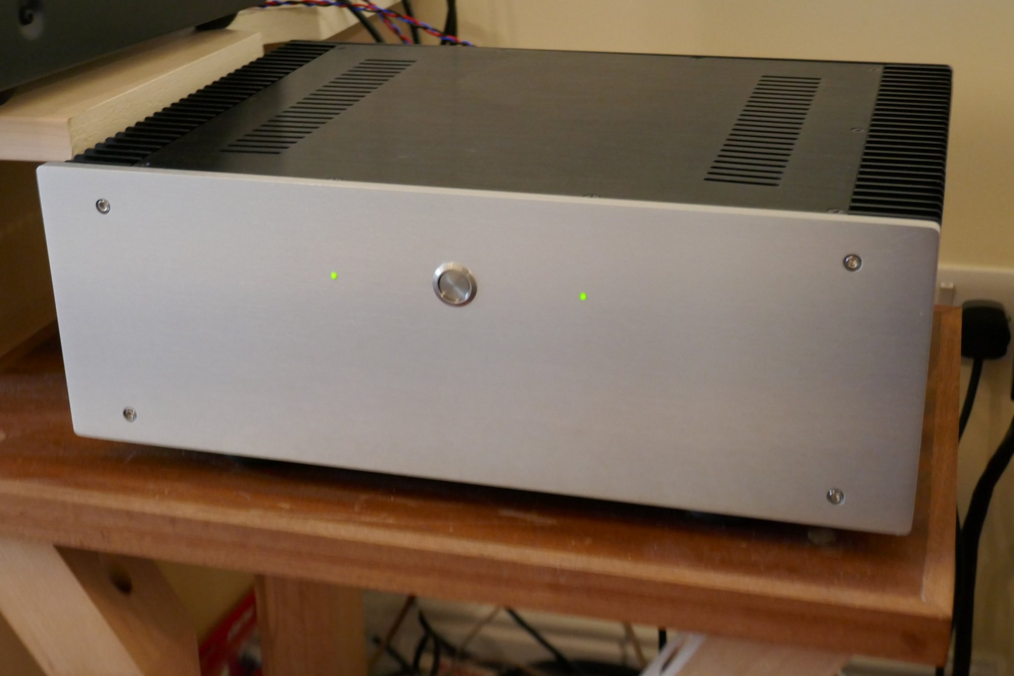

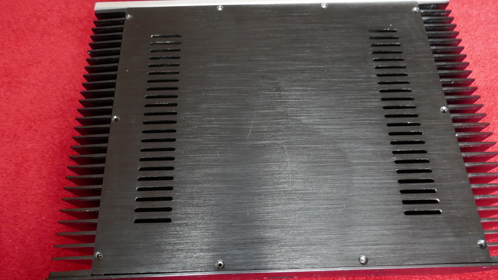

I am making a new case for my SX amp and the existing case will be up for sale - it might help a new builder. It has large heatsinks and only runs to about 40C in the centre. It has a hole in the front panel for a mains switch and two holes for "on" LEDs. The front panel is tapped to hold the little pcbs for these, which I will include. The heatsinks are tapped for the amp mounting and transistor fixing. I will include these screws and thermal pads so that completing a build is easy. Unfortunately there is a scratch on the top panel. The case weighs 8.14kg (18lb) so the shipping cost might put off people outside the UK.
Send me a pm if interested.
