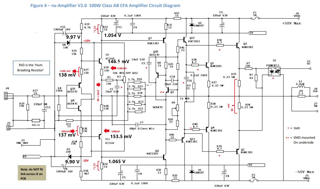

Below is a circuit diagram - you should check all your quiescent DC voltage against this with no input signal.
If the voltages are all ok, try please try this:
1. Connect the PSU to the amp (especially the Zobel connections - do not leave these off. Make sure the wires to and from the amp module are tightly bundled together
2. Run the amp with no load and a 1kHz input signal and see if it swings up to the rails - if it does, I would suspect the driver gains are dropping off at higher currents load currents. Check the 0 Ohm jumpers - make sure they are 0 Ohms and have not been damaged and gone high R during assembly.
Come back and let us know what you have found (are both channels behaving like this?)
Here is the voltages from 1 amp board, and yes both are doing the exact same thing. I have ordered KSC3503D from digikey to swap out the 2SC3503 to see if that makes a difference. With no load the amp still will not go full rail voltage, the scope behavior is the same as with the load like the image I posted before.

Those readings are all ok. Indeed as Thimios notes, VAS current is 26 mA.
I think you should wait until your new VAS devices are installed before doing any more tests.

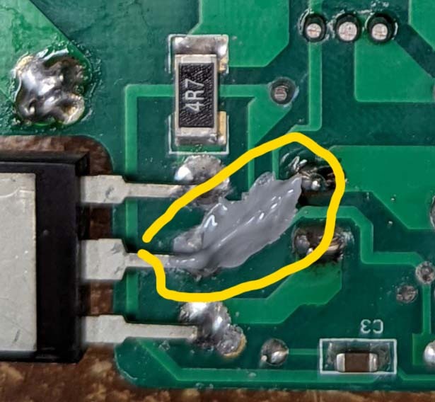

Q3 is underneath the epoxy. The function of Q3 is for thermal sensing of the output so this appears to be an attempt to improve thermal coupling between Q3 and the nearby output transistor.
