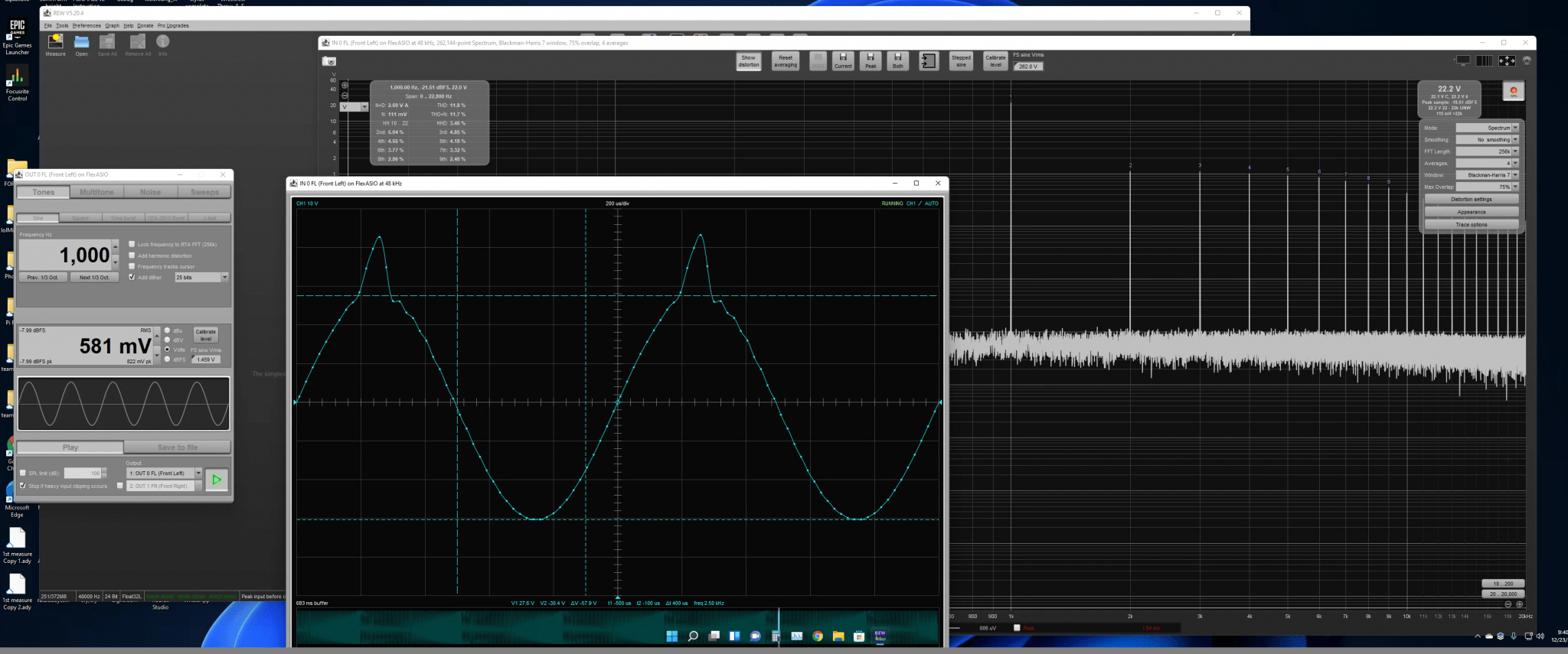

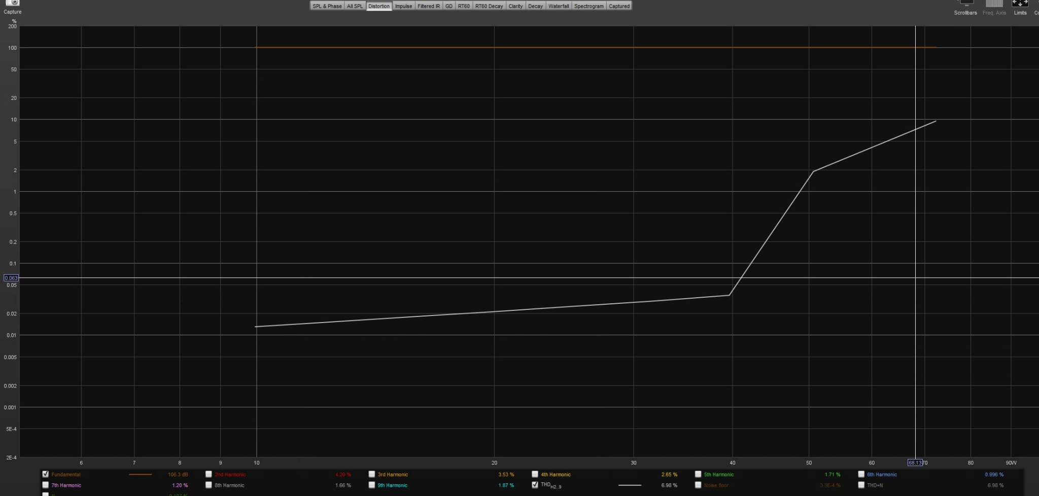

So I just completed building the amp, with boards purchased in 2014 lol. Yes its been a long time. They are Jim's boards Rev 1.0. Biased fantastic and DC offset great, no issue until I tried measuring maximum power into my load bank. Both channels are clipping around 40 watts, I have double checked all my calculations and connections and everything seems good. Low power distortion is spot on. I am using a 800va Transformer and the Rails are +-46.2 vdc at the amp when its clipping, so voltage seems good. I'm kind of at a loss on where to check now?
Thanks!
Thanks!

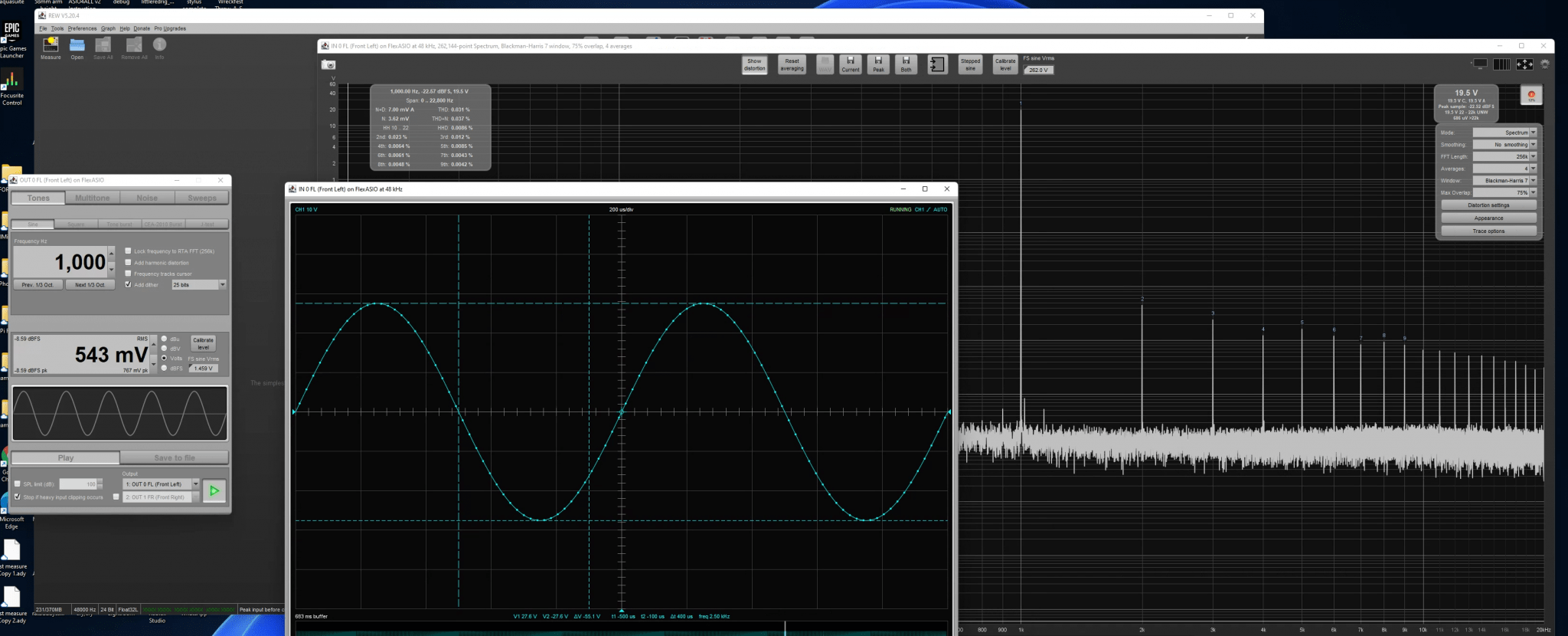

I'm using REW for the calculation to watts. But it's clipping just before 19 vrms output into 8 ohm load. Which is 45 ish watts. Also on the scope it's the top of the waveform that goes crazy. Both channels are the same and if I switch to 4 ohm load I'm clipping at the same Voltage but around 90 watts RMS. So basically half the wattage I should be getting.Can you post up your calculation?
to check your working
(((Vpeak * 0.707)/Rload)^2)* Rload
40 V peak (=80V pk-pk) into 8 Ohms is about 100 W RMS

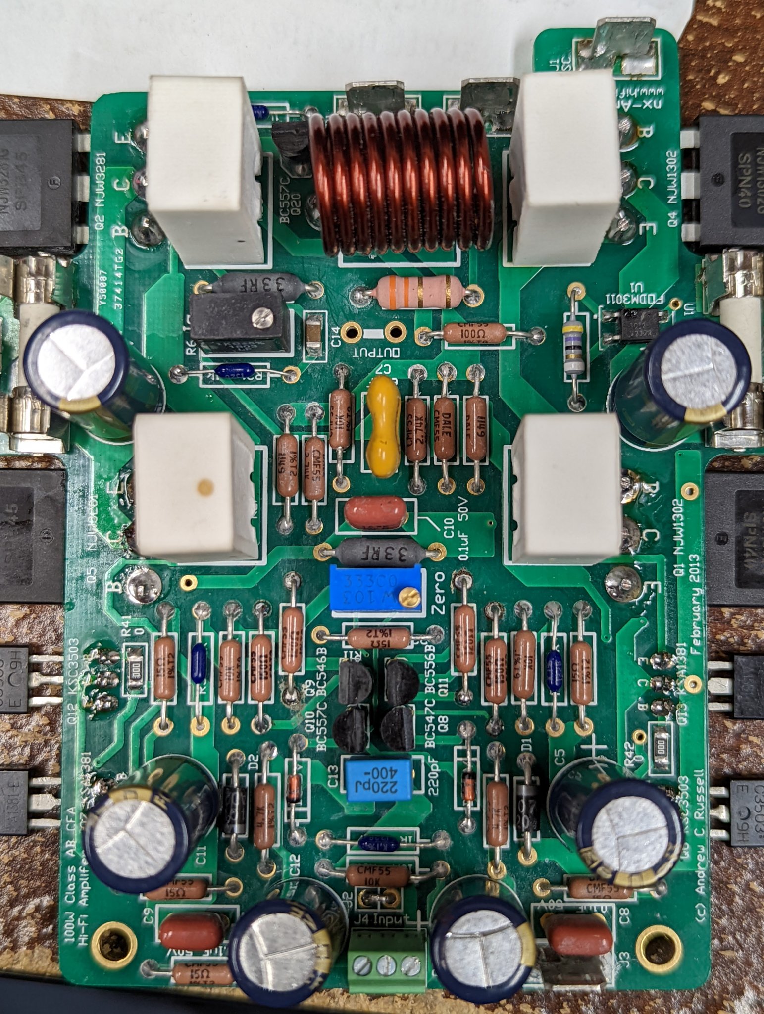

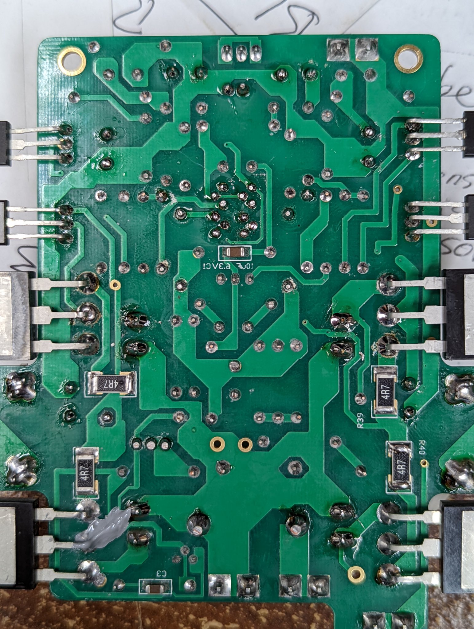

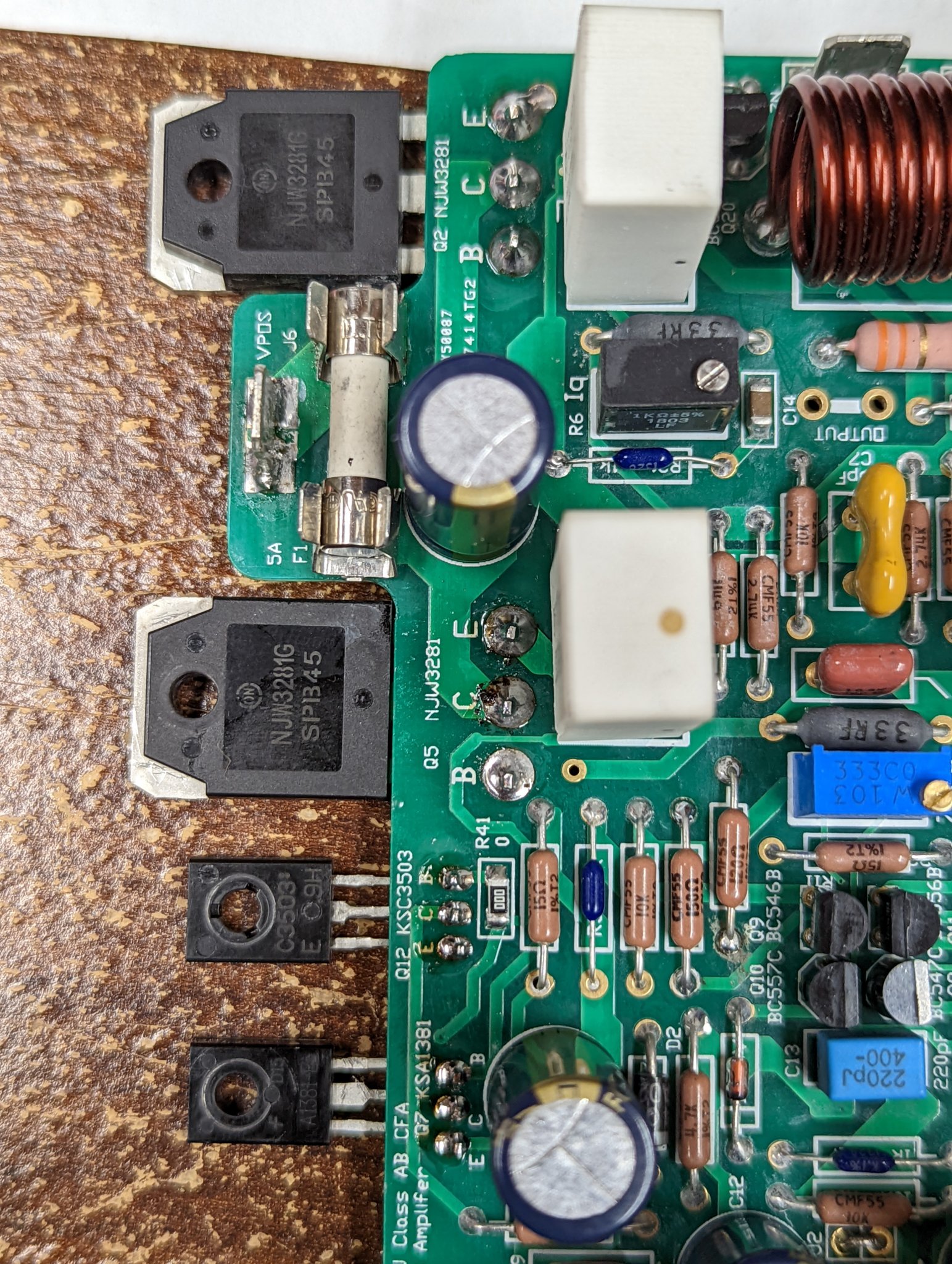

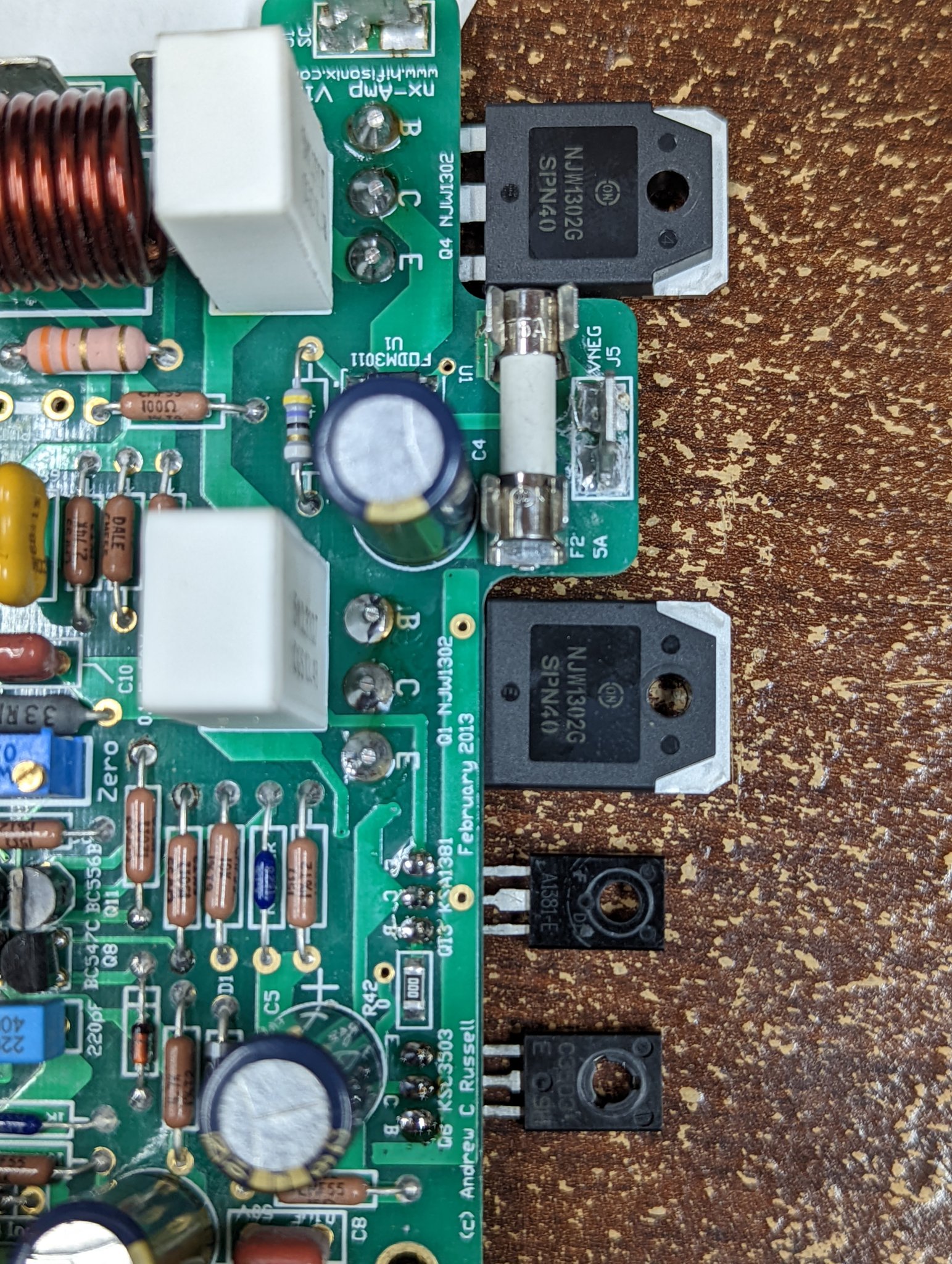

I can confirm that R22 R23 R30 R31 are 15 ohm, and measure the same. I just pulled all transistors to double check and they are all good. I used the updated 120 ohm and 150 ohm resistors, hopefully that is not an issue since this is a REV 1.0 board. I also replaced the 547C and 557C transistors with 546B and 556B except Q20 which is 557C. Also here are some pics of 1 board.
Ok. Tomorrow we can do some voltage measurements to check what’s going on.I can confirm that R22 R23 R30 R31 are 15 ohm, and measure the same. I just pulled all transistors to double check and they are all good. I used the updated 120 ohm and 150 ohm resistors, hopefully that is not an issue since this is a REV 1.0 board. I also replaced the 547C and 557C transistors with 546B and 556B except Q20 which is 557C. Also here are some pics of 1 board.
Merry Christmas I know it's a busy day and time of the year but if you get a free moment to guide me on some test points so i can get some data and see what's happening with the amp boards. Thanks againOk. Tomorrow we can do some voltage measurements to check what’s going on.

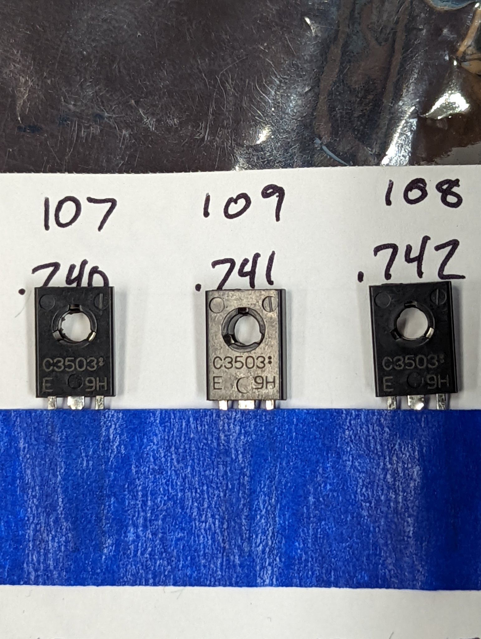

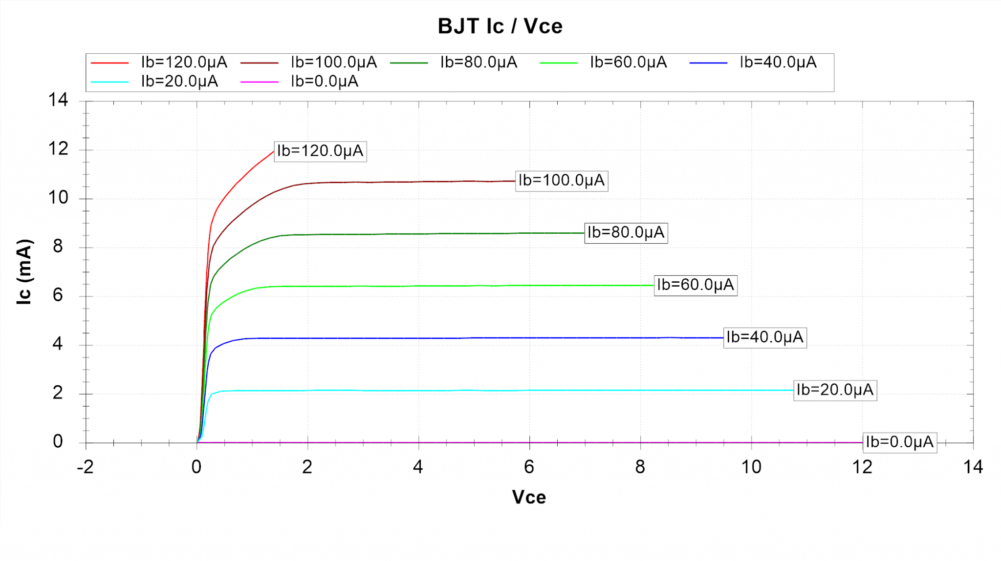

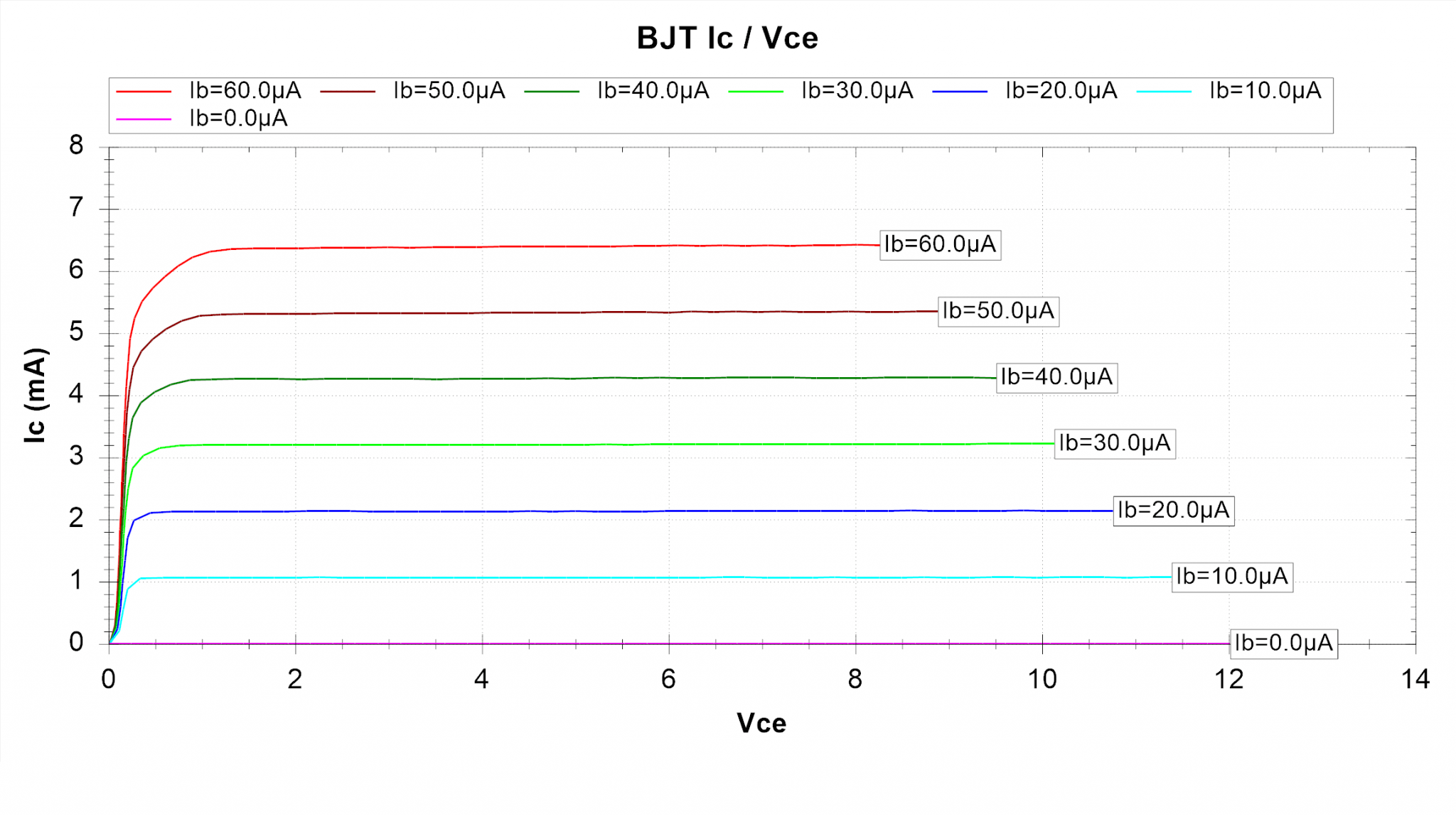

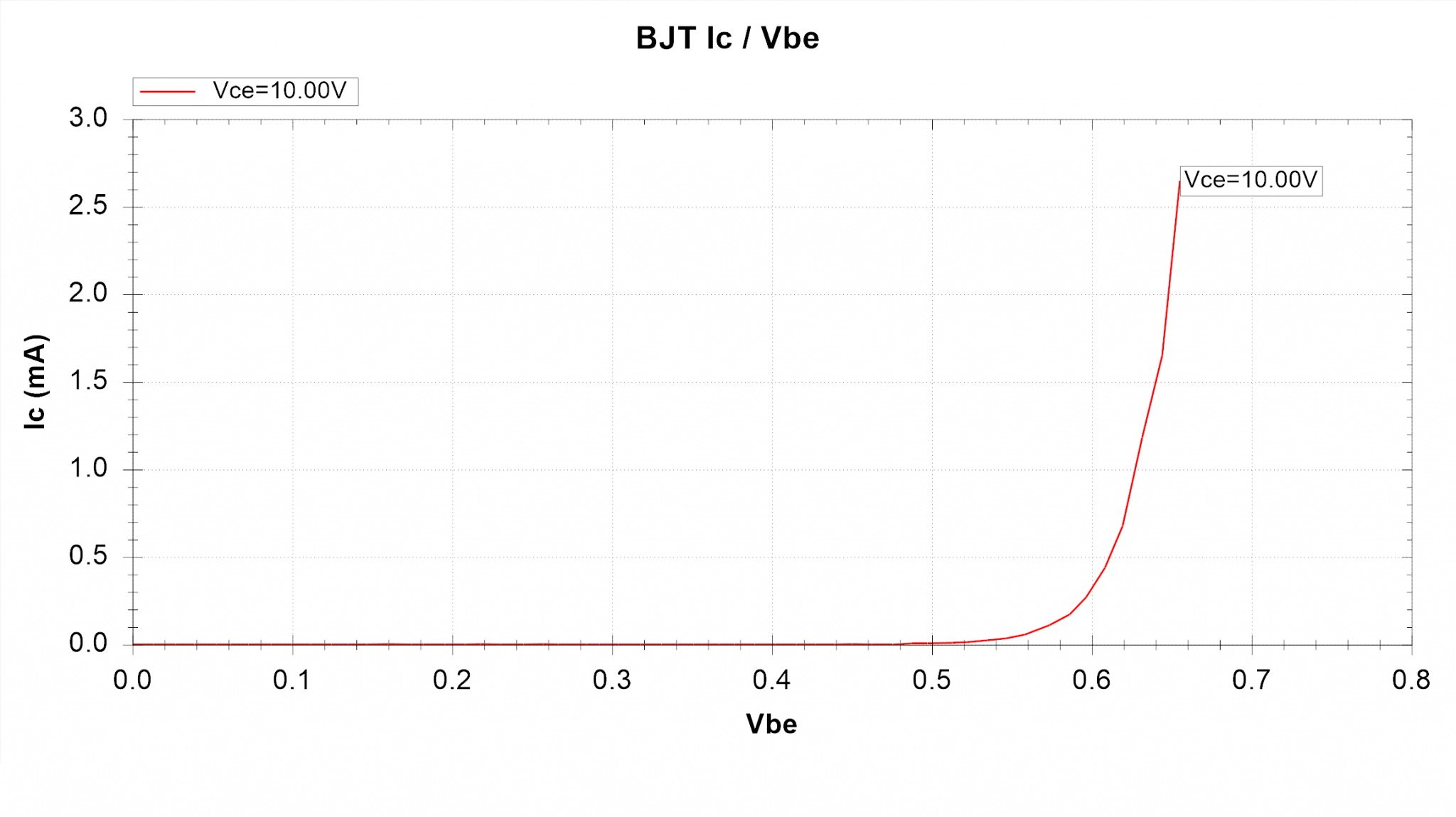

Is there a possibility if the 2SC3503E transistor is possibly counterfeit it could cause this issue? Reason being is I looked back through my records, and this is the only component I purchased from ebay. I'm not sure how to tell if they are, but here is a picture, and some data from my Peak Atlas DCA75 Pro
The gain on that looks a bit low (I get ~108). But, you also don't know how the device is behaving as the Vce increases as ther amp output swings between the two rails. The +ve side spike almost loops like the device is 'snapping' to some kind of short circuit mode.
I earnestly recommend that you never ever buy parts off eBay - always stick to mainstream disti's like Mouser, Digikey, RS etc. You do pay more, but you know what you are getting.

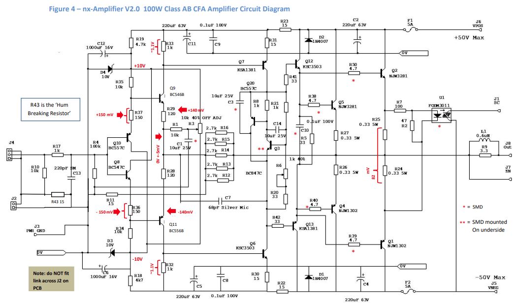

Below is a circuit diagram - you should check all your quiescent DC voltage against this with no input signal.
If the voltages are all ok, try please try this:
1. Connect the PSU to the amp (especially the Zobel connections - do not leave these off. Make sure the wires to and from the amp module are tightly bundled together
2. Run the amp with no load and a 1kHz input signal and see if it swings up to the rails - if it does, I would suspect the driver gains are dropping off at higher currents load currents. Check the 0 Ohm jumpers - make sure they are 0 Ohms and have not been damaged and gone high R during assembly.
Come back and let us know what you have found (are both channels behaving like this?)
