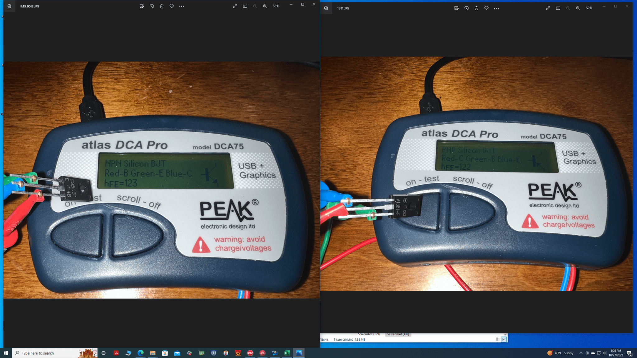

For NX, Q8 and Q10, Q9 and Q11 - BC546B and BC556B, I can only match to within about 30mv. what would the distortion look like? HFE is a close match
I have a supply BC547B and BC547B as well but can only match HFE to within 100

this will not alter the distortion by more than a few ppm - its mainly the distortion profile that changes. If you match them perfectly, the 2nds cancel and you are left with mainly 3rds and 4th. If they are badly mismatched, you get higher 2nds. In any case, its mostly low order and drops off very steeply after 4th.
We are talking about c. 50ppm at 80W here on +-45V rails into 8 ohms - worst case c. 70 ppm.
You should try to match your small signal transistors a bit closer in my view - however, the mismatches you are seeing will not prevent you amp from working well.

3 different Omni Semi's complimentary batches that I have all show 30mv average VBE span from the NPN to PNP.
Average around 762mv vs 788mv.
This is with Atlas DCA Pro where its displays Vbe at IB=5.0ma
Am I missing something? Are my my batches typical or atypical? would be nice to solve this
