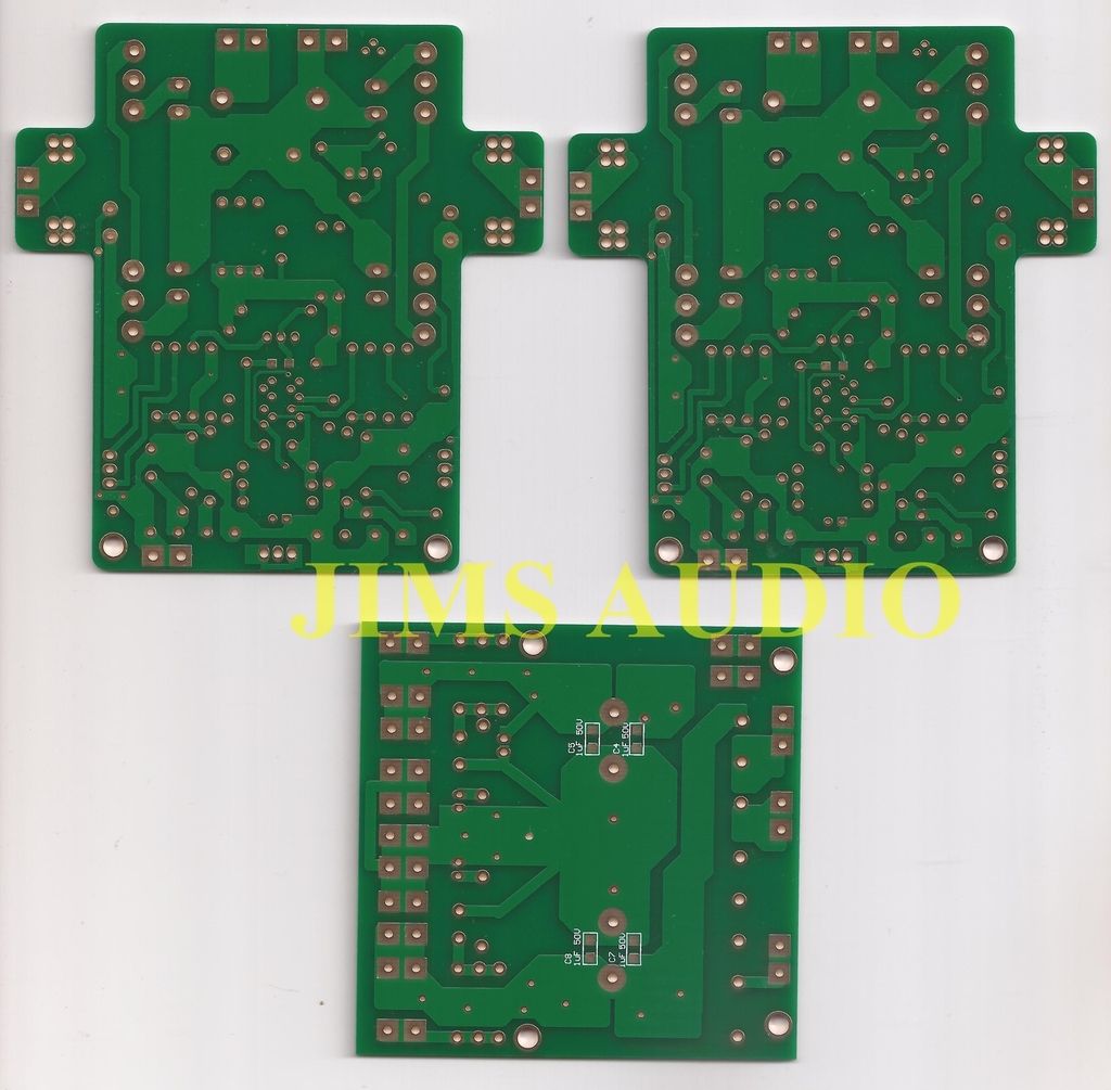

A couple of minor issues in the sx doc.
It says in the BOM that q3 is a smd transistor bc847T115. (847BOT)
However I cannot find any traces on the pcb for smd transistors. Only Q3 I can find is a bc547c in to92 package. And the manual states earlier that Q3 is bc547.
Also the fuse holder clips in the BOM. 504-htc-201m. I guess this is the htc-210m? And that we need 4 of them for each pcb, not 2 like in the BOM?

The bc846 is on the bottom. Near Q2 base and collector pads.A couple of minor issues in the sx doc.
The other pair, under R8 & R11, are for the MLCC 10uF smd caps.

No, this is for the SX amp, not NX. This is how the pcb is from the bottom side.The bc846 is on the bottom. Near Q2 base and collector pads.
You can't lose the base stoppers, they are huge!
