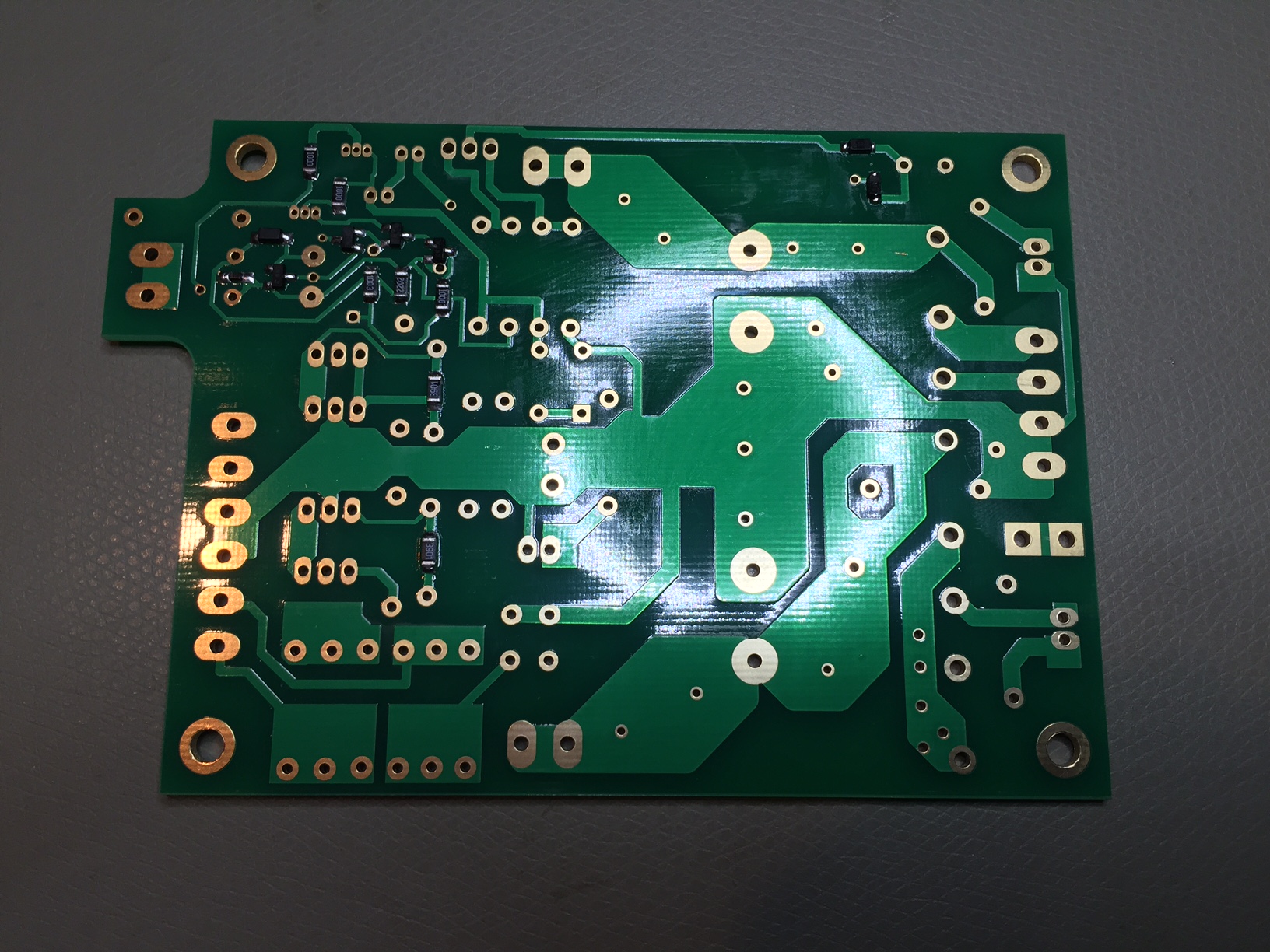

SX amp
Some comments about the SX amp and manual. (Jims Audio pcbs)
For the SX-psu , C4,C5, C7 and C8 are not in the BOM. These are of course mentioned in the manual at page 32.
I measure ca 6mm between the outer parts of the pads and 2mm across, so I guess 1uf mlcc in 1206 or 1806 package will fit?
And C1 in the BOM (Designation C1) I think is not marked on the pcb. I think it is the 2 pads on the back of the pcb (if I read the schematics correct.
C2 on the SX pcb is not mentioned in the BOM or in the manual.
There are 2 pads (for smd component) on the back of the sx-amps pcbs which I cannot find any reference for in the manual.
Whether they are necessary or not is not up to me to tell but I think it wont hurt 😉Referring to Fig 14, the transformer AC secondary’s are fed into a 25 A PCB mount rectifier D4.
C4, C5, C7, and C8 (1 uF 50 V MLCC types) provide local decoupling for the large electrolytic filter
capacitors C1 and C6.
On page 35 in the manual it says:
I am unable to find more than 2 places where I can solder some smd components. There are no references to the 4.7 ohm base stoppers elsewhere in the manual. Nothing in the BOM or the schematics either.The sx-amplifier boards utilize some SMD components. I did this because they are convenient
and save a lot of space. Having said that, it’s the 4.7 Ω 1W base stoppers and two decoupling
capacitors that are SMD.

The small caps on the underside of the board are 1206 size multi-layer ceramic capacitors (MLCC). Mouser, RS, Digikey all carry them.
C1 on th sx-Amp decouples the offset adjust. It's not critical. It's a 10 uF device and 25 V should be just fine (1206 MLCC). There are no 4.7 ohm base stoppers on the sx-Amp - these are only used on the nx-Amp (1W 2512 IIRC ).
the NX 4r7 are certainly big and the pads evens bigger................. There are no 4.7 ohm base stoppers on the sx-Amp - these are only used on the nx-Amp (1W 2512 IIRC ).
Seems so wrong to call them SMD, but the "S" means surface and not small.
