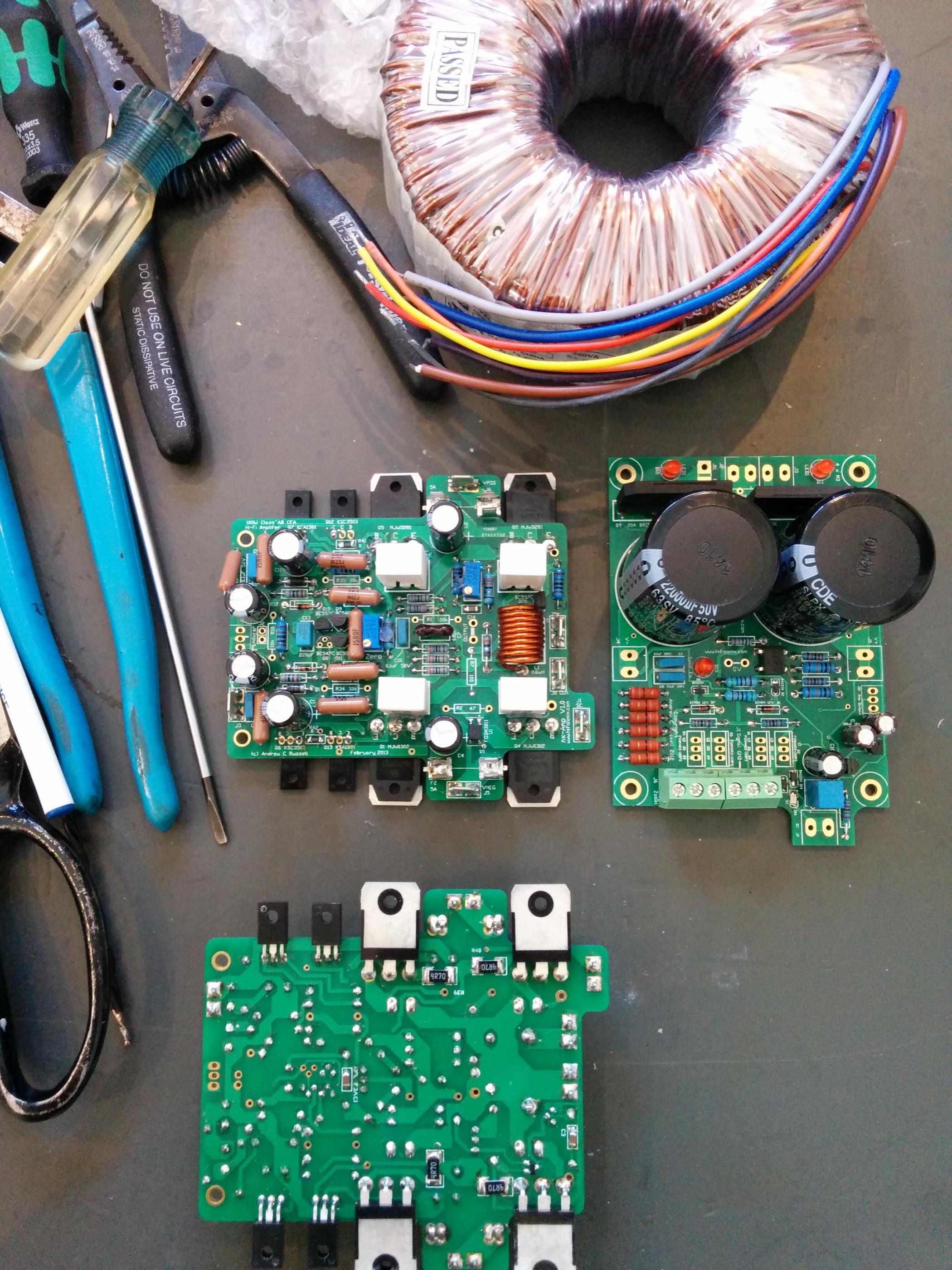

Ordered chassis today, and, Last few parts I missed if first round..
Boards, mostly all stuffed..

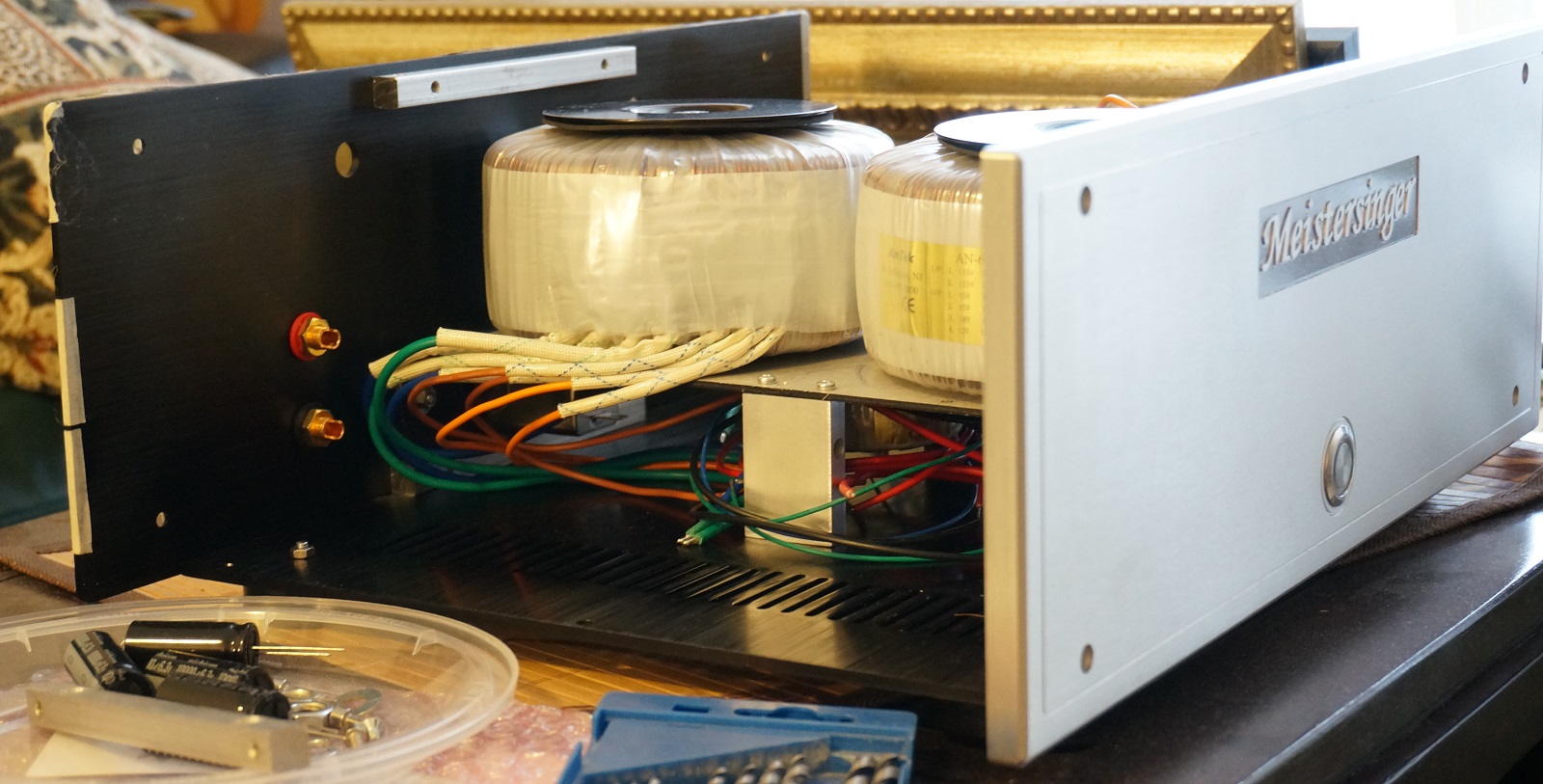

Hey you copycat! Same chassis as mine! 😀 😀
I'm sure you will love this amplifier. Right now I'm using mine with dual PSU but I'm stacking two 500VA transfos and it causes some noise so I will have a custom made PSU from SumR shortly.
Show us some pictures!
Do

Dual Mono. Nice! I was thinking of that.. Maybe next time..
The chassis looks good.. I think I'll go with a light in front, as well..
All my pieces should arrive, next week..

"I'm sure you will love this amplifier. Right now I'm using mine with dual PSU but I'm stacking two 500VA transfos and it causes some noise so I will have a custom made PSU from SumR shortly."
Is it mechanical or electrical ( hum) noise?
You might want to try wiring the primaries so the radiated fields cancel.
Hi Bonsai,
It is not mechanical, with 500VA per toroid were not even asking much of each transformers. I have plans to replace those transformers but how would you wire them? Right now they're on top of each others but with both wire side together (one transformer normal and the other upside down so that all wires reach properly. They're Antek transformers so not the best but ok.

I have the exactly same size chassis, from China too, and I'm doing dual-mono with two 600VA Antek transfoes. I understand why "pinnocchio" stacked his power trans -- not enough room in depth for two when a power switch and an IEC socket are in place. So I built a deck to raise the transformers and clear the interference. The deck is quite simple to build, one piece of angle aluminum each bolted on the inside of the front and back panel, then a piece of aluminum plate rest on the angles with a couple of supporting blocks placed midway along the span. ......Just in case it's useful for someone.
