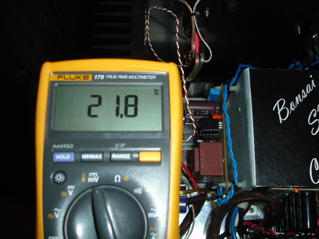

First ,room temprature

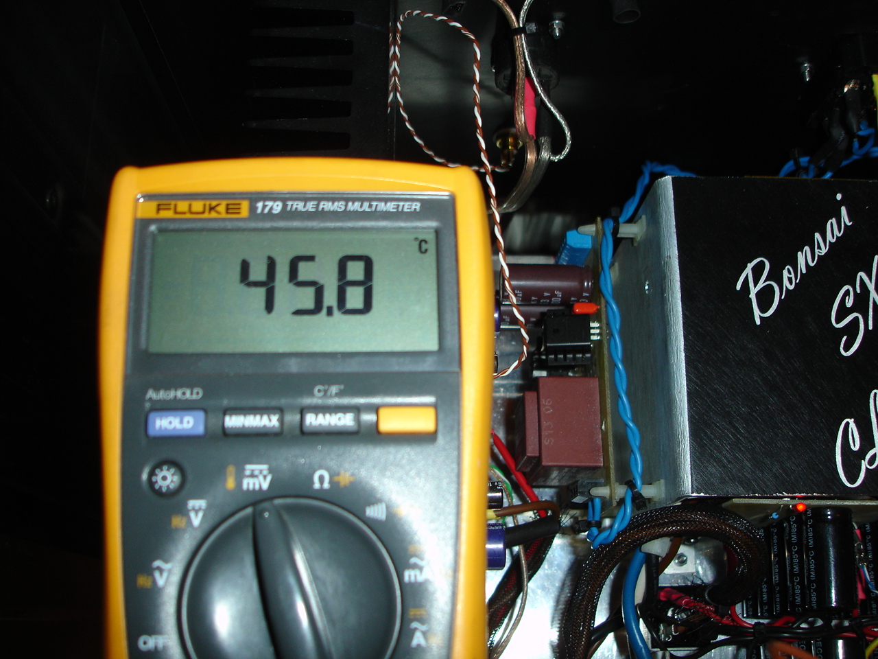

Second ,heatsink temperature.
Hello Thimios - what is the time difference between the two measurements?
If thats your final temp - its good. My amp runs at about 55 C (over 60 when the weather is hot) so you should be good to go.
The first picture isn't the amplifier temperature but the living room(house) temperatureHello Thimios - what is the time difference between the two measurements?
On the second picture is the heatsink temperature after 5 hours continuous function.

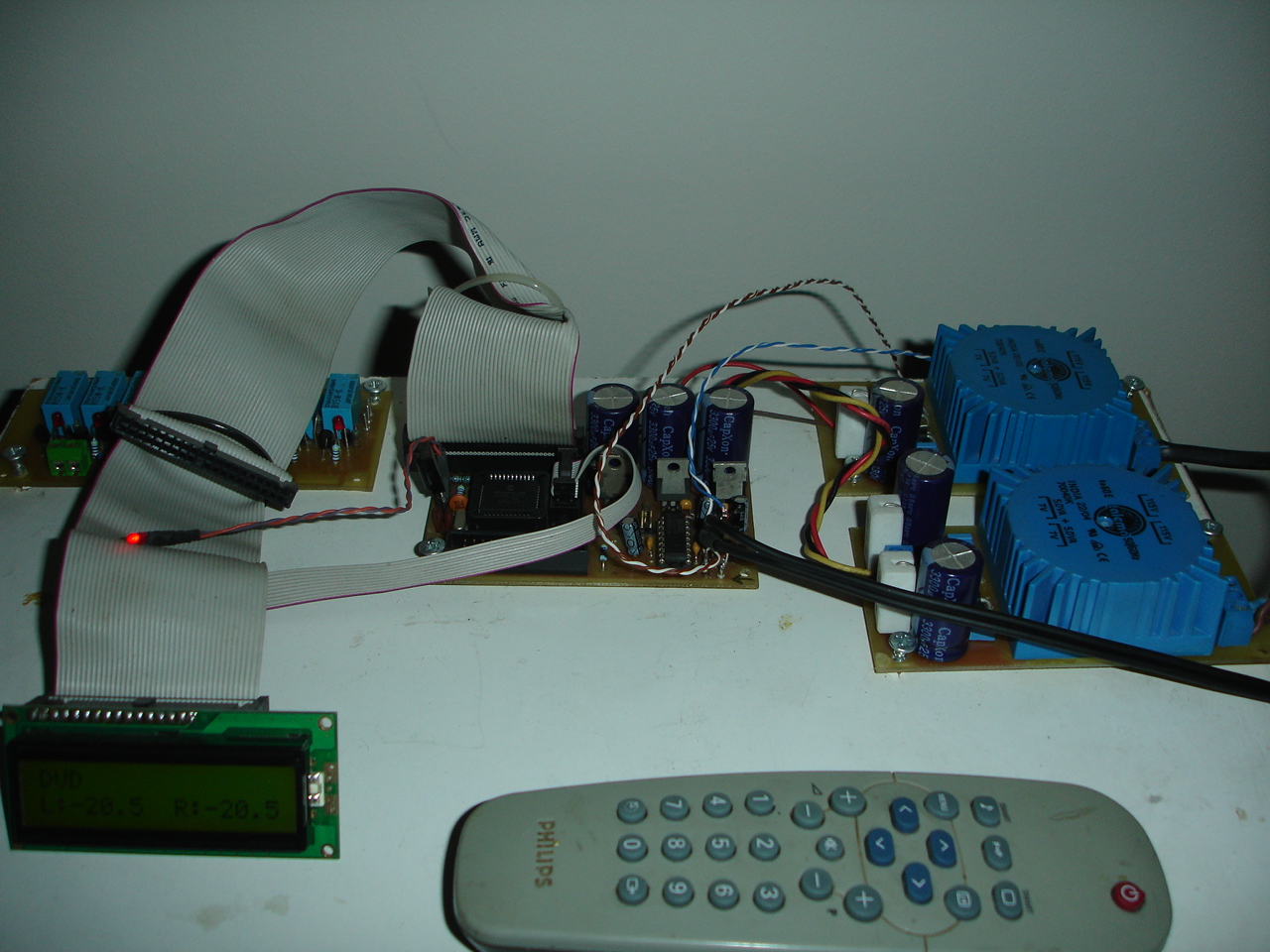

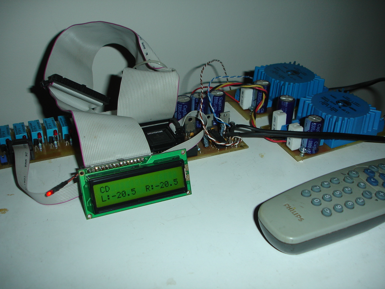

Today is another listening day.
A PGA2311A based preamplifier (posted in Elektor) drive the SX amplifier.
Away sound!
Death silent even with ear in woofer!
Wonderful sound ,i listen again and again the (Pink Floyd) "High Hopes.
