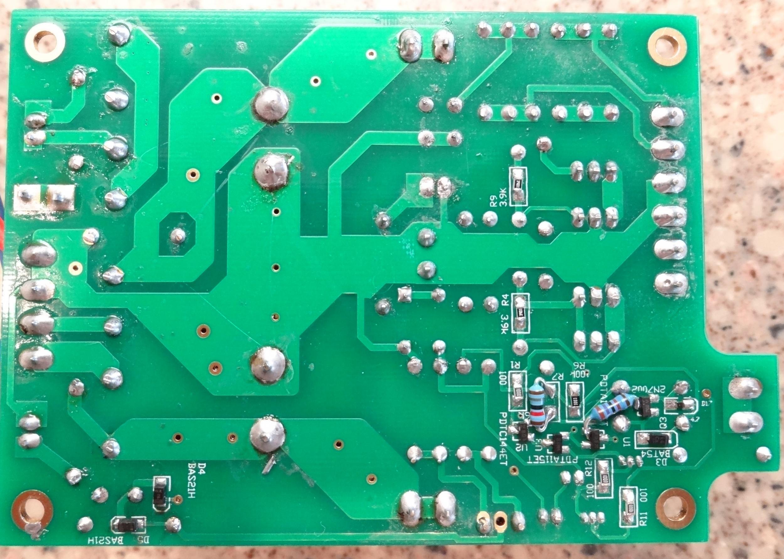

Hi Bonsai,
I actually was following the test procedure but stopped. Here's what was done:
Changed R6 to 100k
Changed C3 to 1uF
Changed R7 to 18k
Changed U1 to PDTA144ET.256
Changed all LED resistors to 10K
Rail voltage is at 51.5Vdc unloaded
Q6 and Q7 collector voltage both show +50.5Vdc referenced to GND
Q3 show only +0.75Vdc at the Gate referenced to GND
I did not lift R1 since Q6-7 collector voltage was ok
There is no DC at J10 pin 1 & 3 since nothing is connected.
Here's a magnified picture of the under PCB
Here's the top

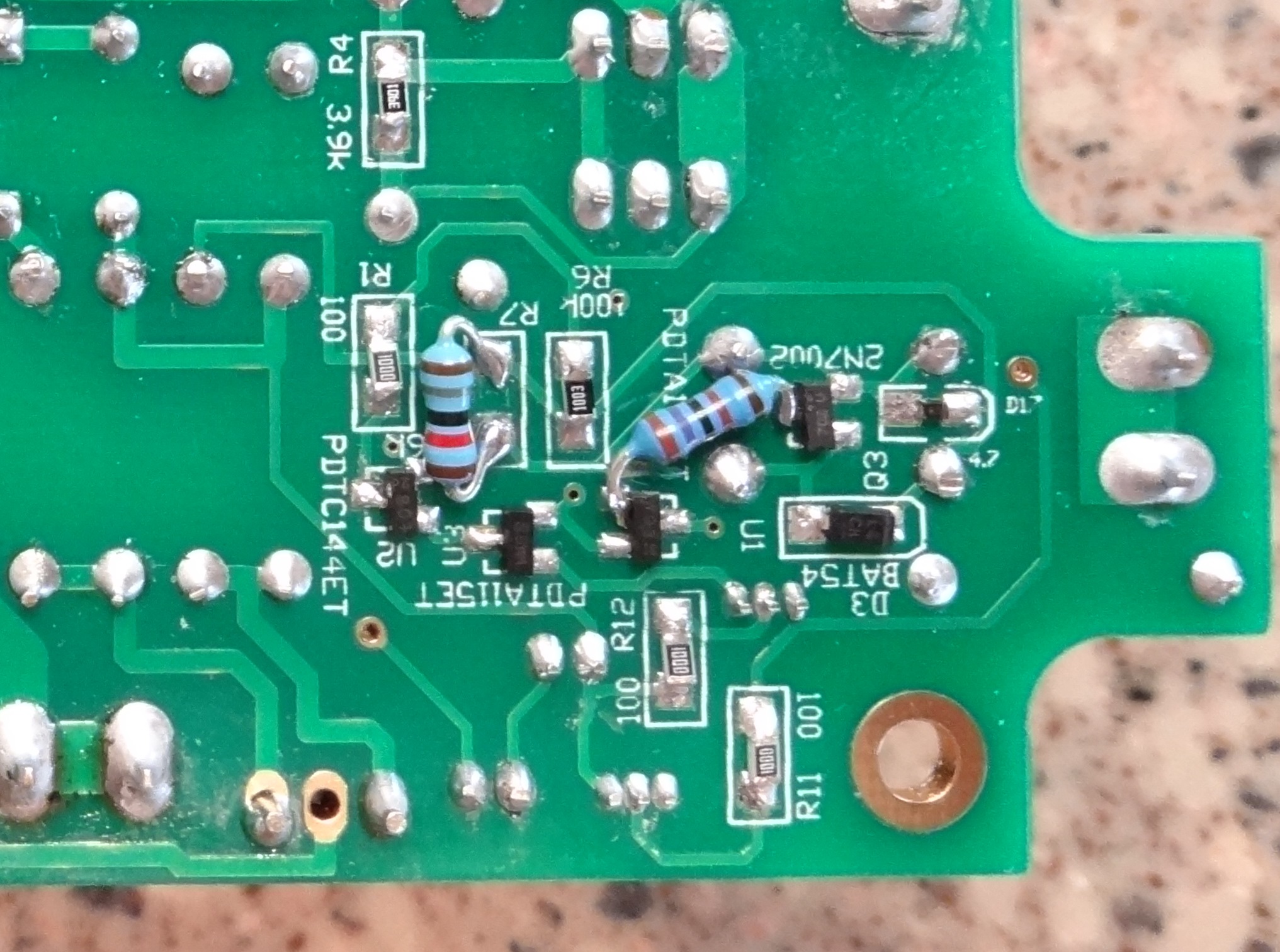

Hi Do,
I seem to remember needing to make a trace cut and some resistor changes on the bottom. I used through hole parts because I don't have a supply of SMD parts and didn't want to wait at the time since we were working our way through it. I haven't read the documentation on Andrew's site about the changes for the PSU but I'm pretty sure we had to cut one trace between U1 and Q3 and add a resistor there. Maybe it got changed later, I'm not sure.
My PSU works properly now so I am adding some pics for your use if necessary.
Blessings, Terry

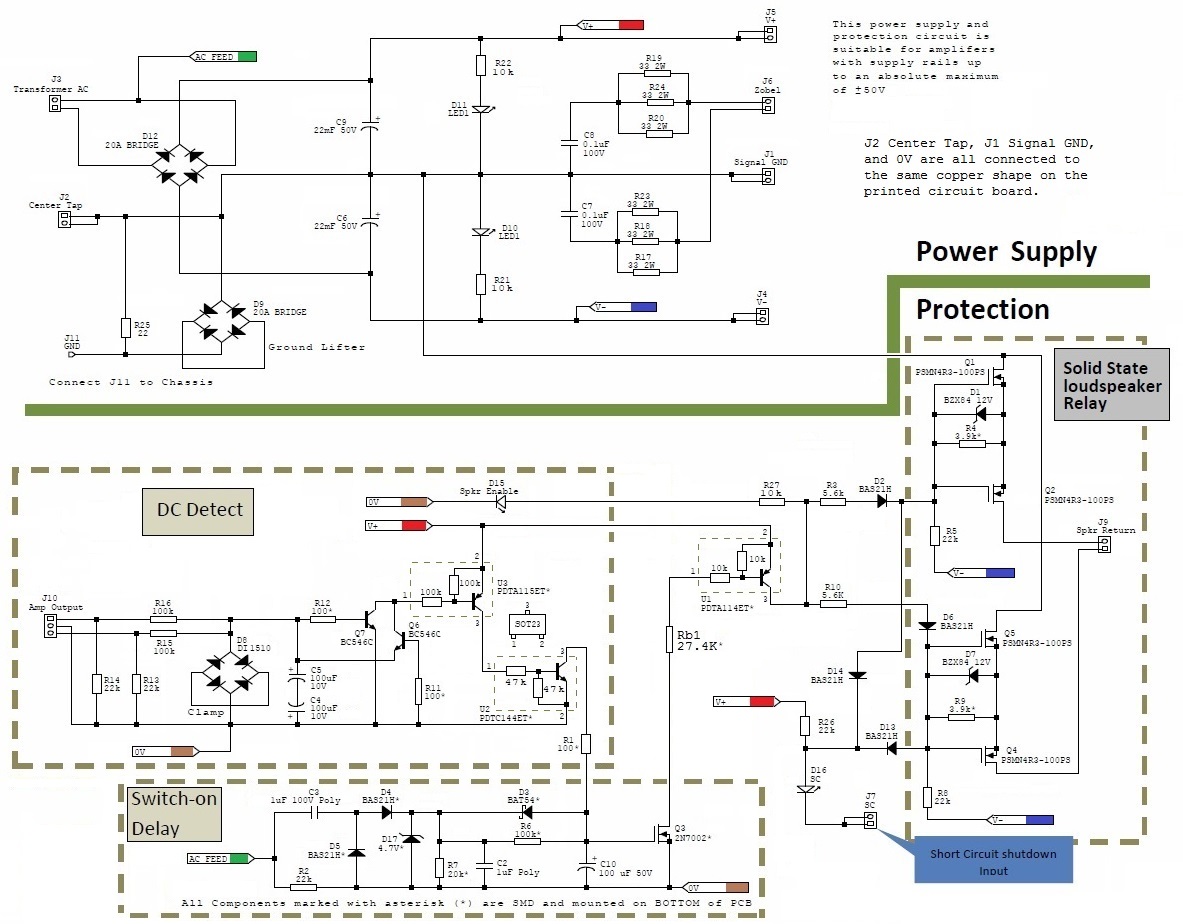

Why do you think the voltage at Q6 and Q7 collector is OK? It is below the rail voltage by enough to possibly turn on U3 partially. Measure the voltage across R1 and if it isn't zero then the DC detector is pulling the gate of Q3 down.
Q3 needs more than 0.75V gate voltage to turn on fully. The gate voltage is not simply DC as you would see if you measured with a scope. With low gate voltage on Q3 the LED should be off.
Back when I built my NX I edited the power supply schematic to help me troubleshoot. This version of the schematic is attached in the hope that it helps you as well.

Where is the 27 K mod going? Is there a trace need to be cut?
Just one trace needs to be cut. You can see the 27K resistor I added in the pic above. It attaches to U1 and Q3. Easier would be to use an SMD resistor and just scrape a little solder mask off on either side of the cut. I just didn't have any and didn't want to place an order for one or two parts.I'm attaching a pic that shows which trace to cut.
