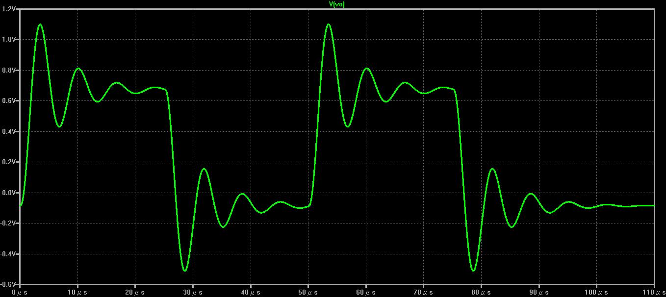

However, the 10khz square wave on the 8 ohm parallel with 1.2uF with my previous 1uh was better damped...

If you are measuring after the inductor it will ring - the output inductor and the cap form a resonant circuit. Without the inductor, you still get ringing in a real world situation as the speaker capacitance and cable inductance also form a tank circuit.
If you the amp before the inductor with 8 ohms and test with a square wave, you should get no overshoot ( nothing connected on the inductor output side)

Hi Bonsaï
Ok I will try your test.
Just to ensure I have the same performance as your built NX amp do you have a scope screenshot of a capacitive load test you have done f.or comparison purpose with mine...

I will have to try to find it fab. But, it's easy to calculate:
Fo = 1/(2*Pi * sqr(Loutput*Cload))
Where Loutput is the output inductor in Henries and Cload is your load capacitance.

I mean the amount of damping of this frequency...
Fab
Here are two pictures. The first is what the sim predicted when a high value cap (I believe it was 1uF) was connected after the sx-Amp output inductor across an 8 ohm load and the second is the actual measured ringing. This is a worst case scenario. In practice, the ringing will be much lower than this because most speakers don't have input capacitances of 1 or 2 uF - although electrostatics are sually very high (which is the historial reason for the 2uF//8 Ohm torture test)
Its difficult to predict how much ringing will take place without understanding what the speaker load looks like. The best way to assess this I'd say is to get a speaker LTspice model and then drive it with a sqaure wave source with some inductance (the speaker cable) in series and take a look.
But, you really dont need to know this (i.e. damping) to be able to design an amplifier. The important things to remember that a metre of speaker cable is 'approximately' 1uH, and in a typical installation you will have therefore 3-4 uH of inductance in series with the speaker. Its this inductance and the speaker input capacitance that causes the ringing - not the amplifer being unstable or anything like that. ALL amplifiers driving the kind of load I have just described will show this behaviour.
If you remove the inductor i.e. short it out, or link straight across it on the pcb, all that will happen is the ringing will move up in frequency - the speaker cable and the speaker input capacitance still ring.

Than we could perhaps put link instead of inductor? Will the amp in that case be unstable with some types of cables like braided Kimber, etc?
You can link the inductor out and try it. For most general dynamic speakers, the sx and nx amp will probably be OK without the inductor. I generally keep PM and GM well above 60 degrees and GM well above 10 dB - usually 15 dB because I don't believe in taking any chances. Both the sx and nx Amps will drive any load without stability problems if the inductor is in place - i.e. unconditionally stable designs.
Hi Bonsaï
When I connect the 1uf cap at the 8 ohms load which is connected at about 6 inches wire length from the amp speaker terminal then I get a similar waveform as yours.
