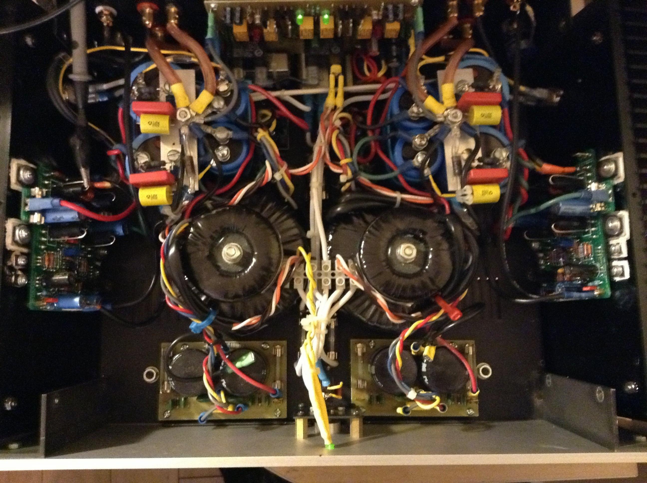

Power amp ....completion...
I have used a previous DIY amp project and replaced the amp boards with the NX ones... However I have not used the. NX associated PS board since I already had a power supply. The only thing that s still bothering me is the lack of over current protection (as in the NX PS board) in case I do a short at the speaker terminal... :rolleyes:
I intend to use the triac on the NX amp board eventually ...

Wow - those nx-Amps look lost in there! Looks pretty compact - how does it sound?
fab
Joined 2004
It is a dual mono amp configuration so this why it looks so crowdy...
Still no sound test yet b/c first its too late and my wife is asleep and second since I had no 10uf film cap I have used 3.3uf but now realize that I should probably change the 10k input resistor to 47k to prevent low frequency phase shift...:rolleyes:
Or should I simply remove the 10k resistor ?
Fab
www.hifisonix.com
Joined 2003
Fab, you cannot remove the 10k resistor - and I would not recommend you change it to 47k either.
If you use the 3.3uF, the - 3dB point will be about 5 Hz versus c. 1.5 Hz with the 10uF.
I think for testing you can go with the 3.3 uF, but I'd put a 10 uF film cap in there when you can get one.

For the input resistor , is it for lower noise and DC offset reduction since the 100k resistor is already at the base of input transistors? But there is already a pot to correct DC offset...
A lot of other amps do not have this added input resistor or it is a higher value like 100k:confused:
Should I use 47uF electrolytic bipolar cap like Nichicon muse (which I have in stock ) instead of my 3.3uf film cap without changing any resistor?
Fab
www.hifisonix.com
Joined 2003
Fab, ignore the 100k resistor for now. Indeed, you can take it out if you like. You cannot however change the 10k resistor - this is where the input transistor bias currents come from and it sets the input resistance of the amp.
If you have. 47 uF cap, thats good and certainly will give your amp LF extension to well below 1 Hz. There is a lot of debate around the audibility of capacitors, and especially electrolytics. Self has no problem with them, RC and JC feel differently. I'd try both and see which you prefer.
The cap should fit from the 10k resistor to the output of your preamp.

I am interested in a bit more information on the input network. Under quiescent DC conditions what is the base current in Q8 and Q10? What is the DC voltage across R10, the 10K resistor at the input? If you have a LTspice schematic file for the amplifier would you post it here?
www.hifisonix.com
Joined 2003
Bill, I'll post it up tonight.
The emitter current of the two input buffer transistors is set at around 1mA and the transistor gains are typically 500 or so (BC547C and 557C). Some portion of the bias current flows between the bases of the transistors - a bias cancelling effect - and the rest is provided by the 10k input resistor. So, the maximum bias current you are likely to see in practice flowing through the 10k resistor is somwhat below 2uA, giving a worst case input offset of about 20mV (I am talking here about an offset caused by input bias current only and not any arising from Vbe mismatches). In practice its going to be much lower than this due to the cancelling effect I already mentioned.
Note that the 100k resistor is actually not needed - it is a place holder from when I was considering making the input AC coupled. I will probably mod the layout to provide this facility, but for now, its DC coupled.
