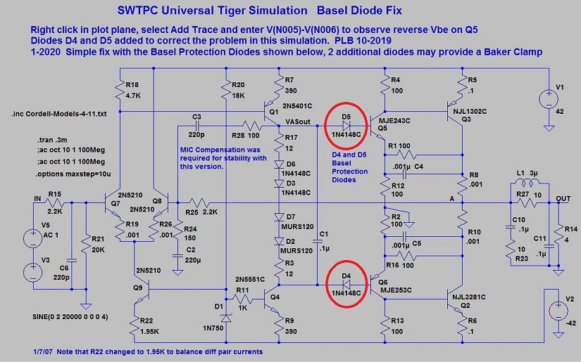

Thinking about the reverse Vbe problem again and I decided to try to find a solution
that does not involve clamping to correct the problem. The problem is that while a
Vbe junction is a diode in the forward direction it is a very poor diode, with very low
breakdown voltage in the other direction. This led to the idea of putting a "good"
diode in series with the base so that the combination has a high reverse breakdown
voltage. It works, the simulation is attached.
I changed the compensation to MIC just because the sim is otherwise touchy it has
nothing to do with this diode modification. I also had to adjust the output bias to
compensate for the two additional diode drops. I like this, simple and easy to do.
It also is the start for a Baker clamp on the drivers and I'll be looking into this also.
The attached .zip file has the sim and Cordell's model file, it is a newer version with a
few more models added.

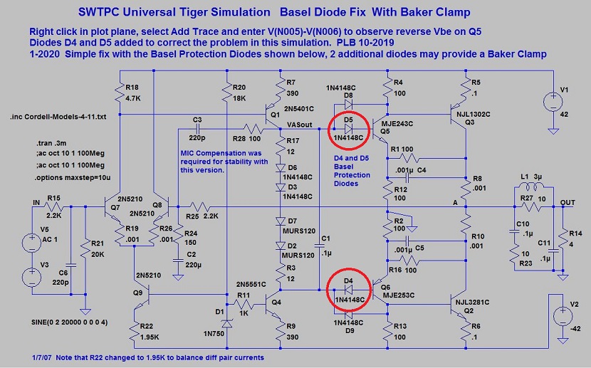

Anyone have a favorite low forward drop diode with 90V or better reverse breakdown
and low capacitance to use for a Baker clamp? D2 here is the one I'm adding to fix
the reverse Vbe issue, D1 needs to have a low forward drop to work properly:
Baker clamp - Wikipedia
One concern is that with the diodes added there is no path to turn off the driver
transistors and I'm thinking of a small capacitor or bleeder resistors - thoughts?

I have not tried the series diode mod in a real hardware but the simulation looks good.
I'm calling it the Basel protection diode. It is for CFP output stages with gain similar to the Tiger topology, schematic is attached. Two diodes are all that's needed as shown below:

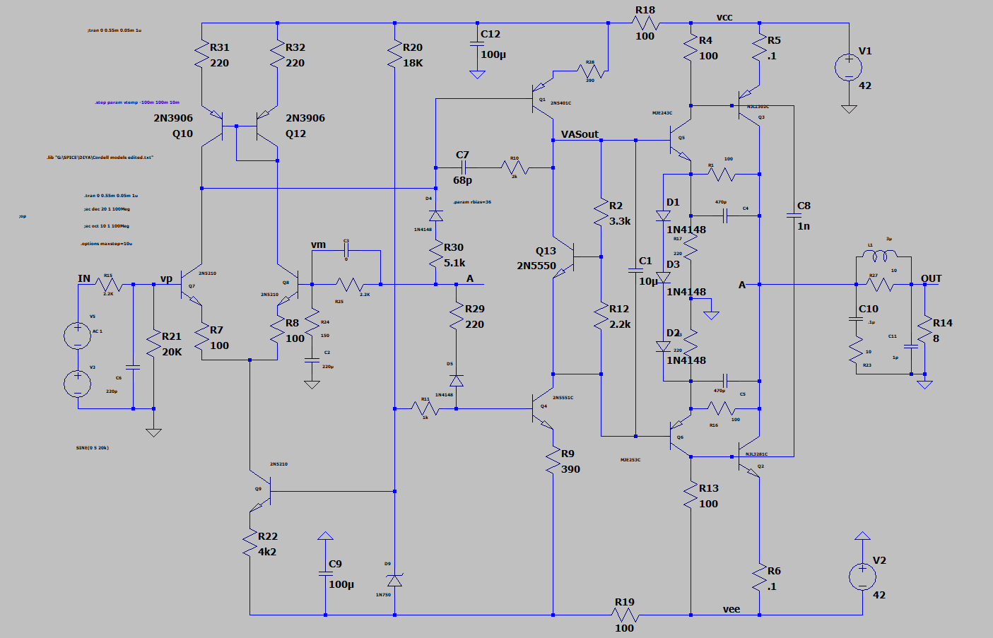

I'm taking a look at this again and ran my last simulation with the diode fix to correct the
excessive reverse Vbe - that seems to work fine. That sim drives the output into clipping
and I also took a look at the current in the output devices. The cross conduction coming
out of the clipped period has a max current of 18A - could it get any worse? One advantage
of the Tigers is that they could drive the output very close to the rails, just about 2 V below.
I decided to look at the Bryston 3B that I also have posted here for ideas expecting to see
at least some cross conduction and what do you know there is none. But it only comes
within about 5 V from the rail, that's quite bad.
I believe that I used different output models for the two sims and that's something that I
should correct to see if it is a model issue helping the Bryston.

I've come to the conclusion that the Bryston output stage is the best way to have one without
cross conduction and high power in the resistors. It could be built with single polarity top and
bottom output devices if desired.
I'm interested but not sure if I'll run every simulation that you offer.
Please start new thread(s) with the emphasis in the title, EF, CFP3 etc. I don't like threads
that wander all over the place.
New designs are good, but what I wanted here was simple mods that could be done on an
existing UT board.
- SWTPC Universal Tiger Improved And Simulation
