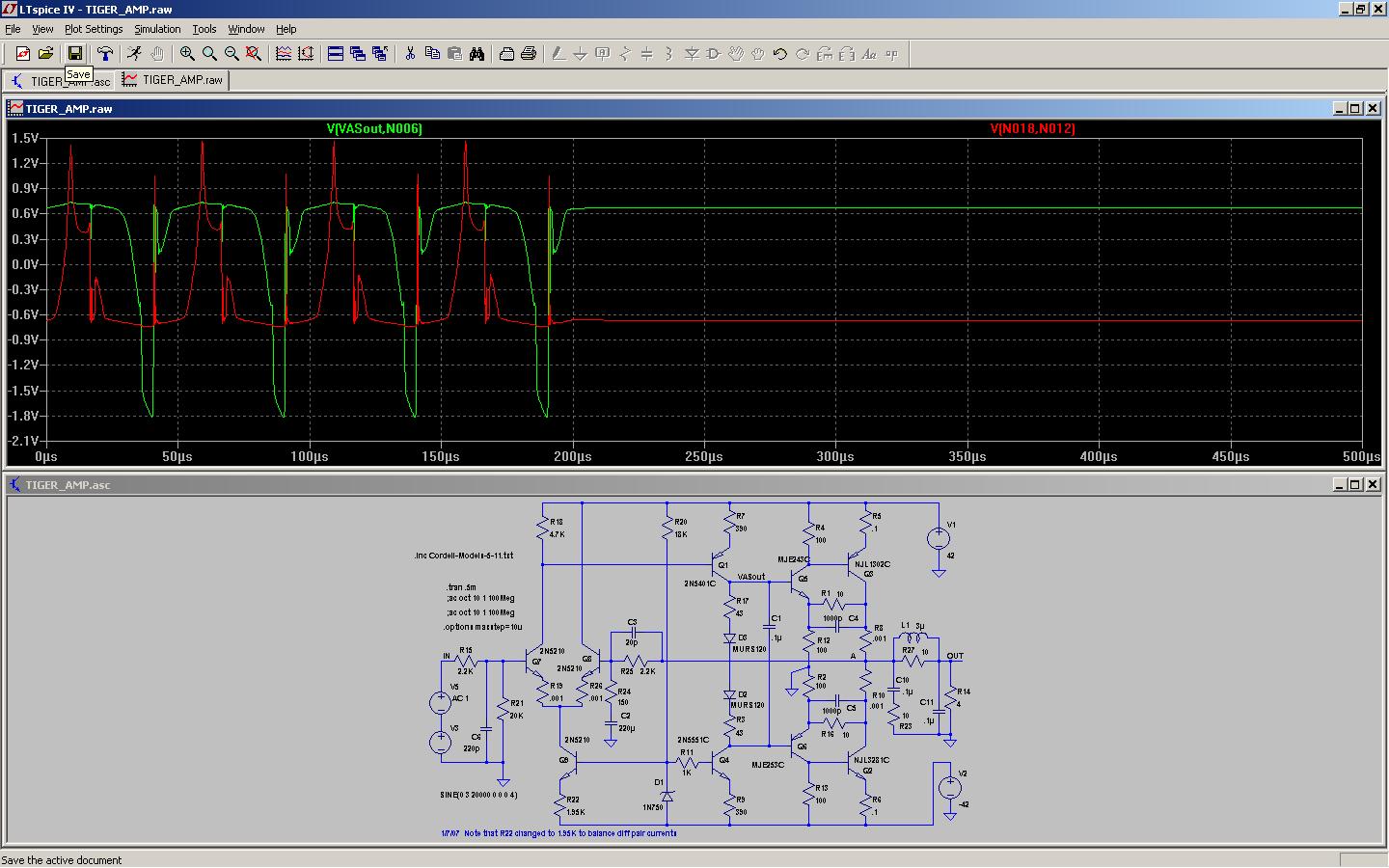

Hmmm, yes those oscillations are not good, perhaps another issue but I have subsituted all the devices so it is hard to say for sure. The oscillation bursts come at the zero crossings and the outputs do turn off completely once the other turns on, so it might be due to low Ic beta and Ft droop in the outputs. I don't fully trust the sim with the higher speed outputs in place, perhaps base stoppers would help. Let me see if the MJL sim does it also.
Zoomed in on the oscillation and I measured a period of .10 uS which is about 10 MHz. I don't really trust the sim much at this frequency since all of the device lead and board routing parasitics have not been included. It is interesting that it oscillates anytime the output device current changes abruptly, from off to being driven in the crossover region, and even coming out of sticking.
Just looked at the VAS and it is there also, so does this mean it is a global loop issue?
It seems that if you reduce C3 to 50p and it mostly goes away. There is ringing left
that seems to be the loop trying to correct for clipping and crossover distortion.
Increasing R8 and R10 to .22 does the same.

We should look at the loop gain and then we can make better decisions as to how to fix it, but I don't think I'll spend a lot more time on this since a solution is also needed for the reverse bias issue on the driver B-E junctions.
I think I've had enough Tigers for tonight!
Edit: Just noticed C11 with no series resistor, this will resonate with the output inductor - might be part of the issue and does not look right to me.
Hi Pete,
I ran the sim and yes -18V Vbe of Q5 at clipping. If you plot the base current of Q5 you will see a very nasty oscillation going on as well. Q6 is ~+15 Vbe with base current oscillation as well.
David.
Hi Pete,
For tomorrow then,
This is differential probes of Q5 Vbe (green) and Q6 Vbe (red) with R1 and R16 reduce from 100 ohm to 10 ohm. The voltages have dropped to under 1.8V Vbe.
David.

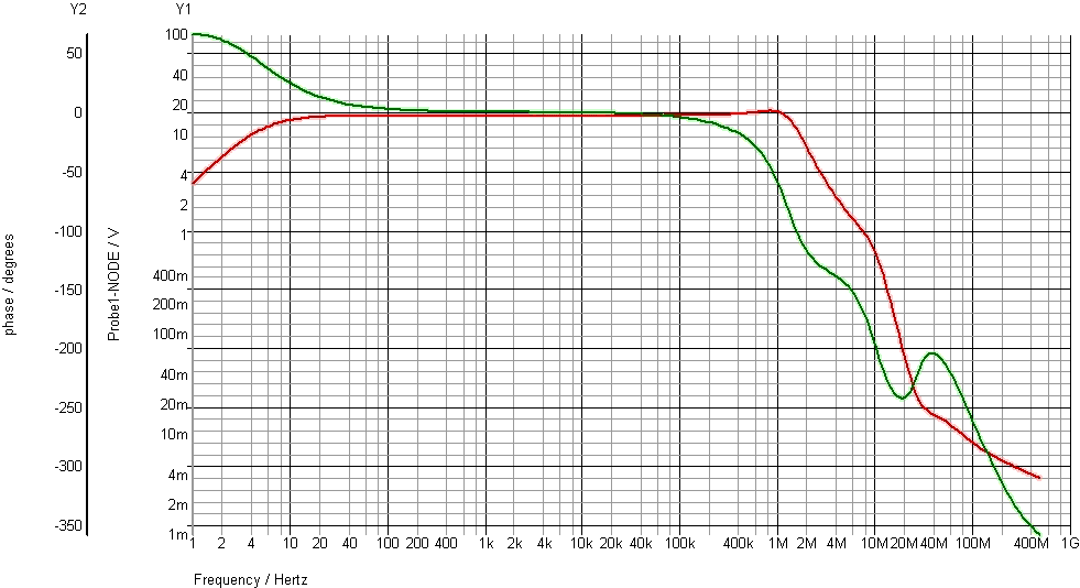

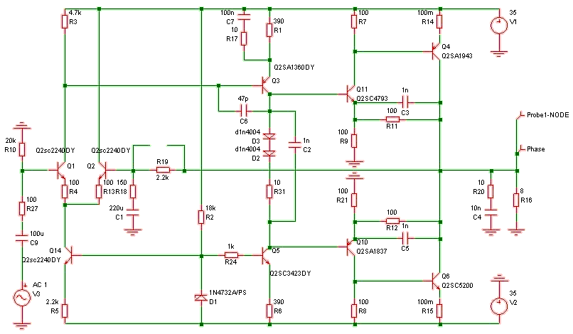

Out of curiosity, i made some sims and it appears that stability
seems good provided :
1. LTP use 100R resistors for degeneration.
2. A 47 pF compensation cap is added to the VAS.
3. The subsequent nasty pole, created by the use of a 390R
resistor connected in serial with the VAS emitter, is rejected
at an innofensive frequency by bypâssing it using a RC circuit
consisting of a 100nf +10R ..
These very slight mods allow to suppress the lead comp. cap
that goes to the inverting input.
Of course, it can be tweaked further..

Nice work David, but consider that as you reduce R1 and R16 to zero it just becomes a standard CFP without gain in the output stage. Perhaps a compromise value that allows 3-5 V reverse Vbe and a bit more gain.
Hi Pete,
Yes I agree a compromise value is needed. I like to make big changes to study the effect and then refine the change based on the new information. I'll try to be more scientific.
David.
