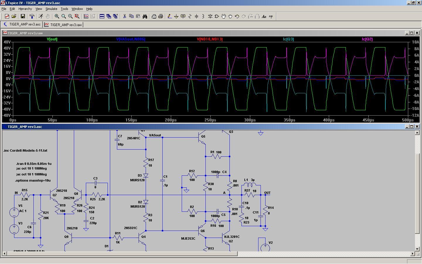

Where we are?
Here's a post of a Tiger amp with some minimal mods...they help a lot with cross conduction, and excess reverse Vbe on the drivers, and honor Pete's gain of two int he output stage request. The clamping diodes are shown a bit differently, but it's actually the same connection as earlier.
I'm sure that there are other ways to tweak, but this seems to simulate ok.
Reality will depend how good the models were.
There is still, if you overdrive heavily, too much reverse Vbe...
So..we could fool some more with other clamping ideas, or put an appropriate limiter in front of the amp...

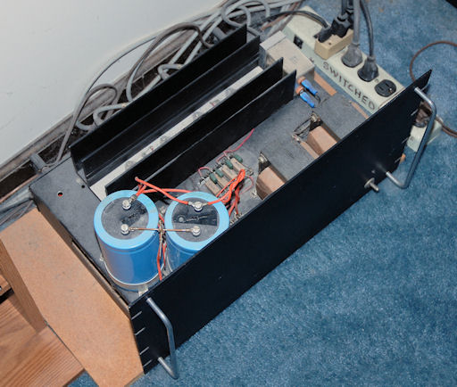

Here's a shot of my dusty and much neglected Tiger. I built it from scratch using only the magazine articles well over 20 years ago. The boards were etched from the published patterns and all the semiconductors are the original part numbers. There's a large hole under the heatsink and the boards are directly under the output devices. The filter caps are 19000uF each and it uses two transformers because I didn't have one with a suitable center tap. The chassis is a 10" high rack panel attached to whatever industrial surplus I could find at the time. Heatsinking is generous, again using whatever extrusion was available from the scrap pile. The amp has been in daily service since it was built and I've only managed to blow it up on the test bench, never in the system. If I built one today (I wouldn't) hopefully it would be more compact and not have bare power terminals! It does live in an inaccessible location.

A Baker clamp protects from going too far into saturation, not for the reverse bias condition.
I tried a simple Baker clamp with a silicon diode and it did not work probably due to the high currents in the drivers and outputs.
You didn't specify if you intended the clamp for the VAS, drivers or outputs.
Here's what was said on the baker clamp idea earlier:
http://www.diyaudio.com/forums/solid-state/41926-universal-tiger-3.html#post2204629
The other thing is that while some fixes may seem to work ok in sim, with a resistive load, the amp also worked pretty nicely into a resistive load, but liked to fry a lot when a speaker was connected AND you merely unplugged the input while it was on, or plugged in the input. Sim that! 😀
I don't have a good answer, btw... on how to "fix it".
Oh the other thing is that once you take the output stage down to a gain of 1, it's kinda a different amp? And wouldn't you want to run a follower output and a different driver stage, etc etc at that point?
_-_-bear
Those issues actually do show up in simulation. Lighter loads allow the outputs to go deeper into saturation where they stick and cross-conduct even more. A speaker with the impedance peaking to 20 or 30 ohms will allow deeper saturation without the diode fix shown in this thread. You wonder why it blows up when you pull out the input plug - I think it is safe to say that the hum or RF picked up clips the output putting far too much reverse Vbe on the drivers, also shown in this thread, destroying them and making the amp go up in smoke. This is my theory and I'm sticking to it until a better one surfaces.
The cross conduction is, for a 20 KHz signal a fairly low percentage of the period, but as you go up in frequency the rep rate of the cross conduction goes up and it become a much larger percentage of the period which would lead to destruction of the outputs. RF is a very bad thing for this amp.
On top of it, we are finding oscillations due to the global feedback loop. I think that these are device dependent however it seems to do it with more devices than not. I thought I found a set of devices that worked way back years ago when I simulated it and checked the loop gain. We will have to revisit this and check the real hardware.

Hi Pete,
The diode fix seems to fail on Q5 when the input is set to 5V.
The reverse bias of Q5 Vbe is a bit over -12V.
David.
David.

I thought I had previously tried it with 4 ohm loads but now when I run it I notice that it also fails with low impedances, and does virtually nothing with a shorted or very low Z load.
Years ago, I notice that the independent feedback circuits for the pos and neg halves of the outputs could be combined by simply connecting the driver emitters together and I wondered why they didn't do it that way. This solves the reverse Vbe issue since each junction protects the other from reverse Vbe. I believe that they used two feedback sections in order to provide more stable bias in the drivers and a compromise for an already built UT might be to put a 10 ohm resistor from emitter to emitter and then rebias it of course. Also check for bias stability, another area that probably needs attention.
This is similar to the 2 10 ohm resistor arrangement that you showed.
Hi Pete,
I'm not sure if this is what you had in mind.
This solves the problem with the reverse bias but does nothing for cross conduction in the outputs.
The circuit I proposed resolves both but limits the current to the drivers and thus the output transistors. It works fine for this sim, but if you were to use larger outputs that require more drive current the resistor values in the diode-resistor string would have to be so low that 10W components would be required.

David,
The 10 ohm resistor between the emitters will cause bias (quiescent) current stability issues. Now the gain to the difference of the voltages in the Vbes and the bias setting diodes is about 10, where it has been about 1. I think that will make the bias difficult to set with any stability over temperature.
Dan
