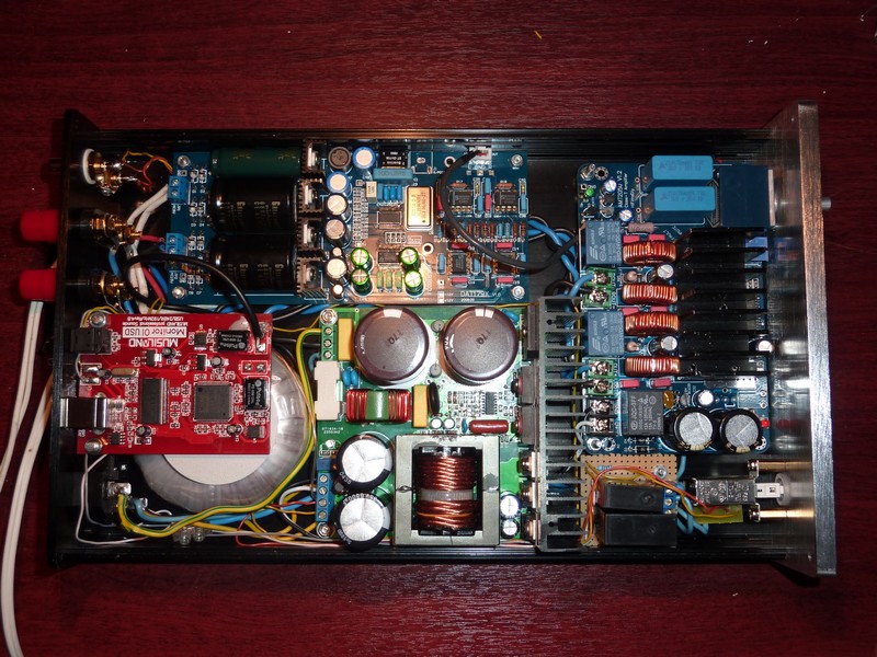

Cristi SMPS500 paired with Hifimediy T1 amp paired with DAC PCM1798 paired with Musiland monitor USD paired with toroidal transformer paired with two triggers. (same box)
