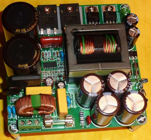

Quoted from the email which i sent you today, might be useful for others too till i get the manual ready:
the size of the power supply board is 264x140mm and the height is about 55 mm.
the output voltage for the current version is not adjustable, it is proportional with input voltage, +-5-10%.
the caps from the secondary side are low ESR long life electrolytics, chosen depending on the working voltage and required minimum capacitance. there are 8 capacitors for the first tier rails and another 6 caps for the second tier rails.
the output usable power in audio applications, with a crest factor of 3 or more is 3600W, for continuous operation, the maximum continuous power is about 3 times smaller. the average efficiency is around 90%, with peak efficiency of 92.5% at 40% load, for the 230V version, 2x80V output and 2x120V output. switching frequency is fixed, around 100KHz.
The rectifier bridge of the SMPS3K6 is rated at 50A and can withstand the average and peak current required by the power supply. please note that this power supply is intended for audio applications where the crest factor (peak to average ratio) is at least 3. The average power consumed by an audio amplifier is at most 1/3 of its rated output power, so the power supply can be thermally designed to withstand 1/3 of this power but electrically able to sustain the nominal and maximum power. in other words, with a bigger heatsink and forced air cooling should be able to deliver the rated power. I used a E55 transformer on the current boards and on the earlier prototype ETD54. any of them can sustain the required power. Double stacked EE65 cores are only required if the output power is huge, around 6-10KW or the switching frequency is very low, 20-30KHz. i also use 6x2200uF capacitors, so in total 13200 uF as can be seen in the picture.

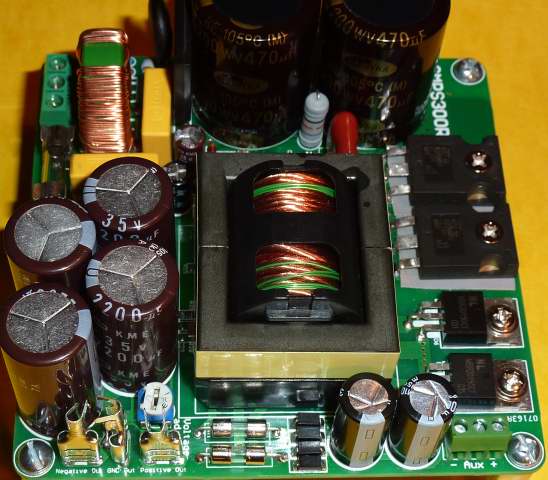

Need a little help hooking up the SMPS300R
Hi everyone,
I recently purchased a SMPS300R to power a Sure 2 x 100 class d amp board. I couldn't find any documentation on the Connexelectronic web site and none came with the PSU. The Sure needs a single supply and the description on the Connexelectronic web site states that it can be configured as such, but without documentation I'm at a bit of a loss on how to hook it up and adjust the output voltage. I've attached pics of the mains side and the output side of the PSU and of the power in side of the amp board. Any help would be greatly appreciated
PJN
Hi everyone,
PJN
I'm writing the manual in the little time which i have these weeks, till then i will answer the questions regarding the power supply.
the output can be configured to deliver either dual voltage or single voltage. in case of dual voltage, there are 3 teminals, Positive out, Negative out and GND. in case of single output voltage, the Positive terminal is connected to Negative terminal, and the current capability is doubled, the rectifier diodes have the cathode connected to output. so, either positive or negative terminal can be used for positive only in single voltage mode and GND remains the same,
the mains input voltage shouls be supplied on the mains connector, the green connector from the first picture. the first terminal is protective earth, then AC voltage which can be either 230V AC (Europe and most of the world) or 120V AC (USA and Canada). for 120V a jumper must connect the pads between the two yellow capacitors. on the backside of the board is easier to connect or remove.
the small 3 pin green connector next to the two 1000uF capacitors is the auxilliary voltage output.
Hi Cristi,
Thanks for your quick reply. I can be a little dense so just to make sure that I fully understand you :
- For the single voltage output I jump the + and - outputs together and run the ground and either + or - to supply the amp board.
- For the AC supply the first terminal(the one closest to the edge of the board) is the earth.
- I have 120v so I need to jumper out the two yellow caps. By this do you mean to say to solder a wire between the two terminals on each individual cap effectively removing them from the circuit. Or do I need to solder wire jumpers from the terminals of one cap to the terminals of other cap ?
PJN

Hi PJN,
my advice is to be EXTREMELY careful with mods on a circuit involving deadly tensions,
and on the AC side you're dealing with 120/220 V that can kill you istantaneously.
A relative of mine died this way some ears ago.
If you shorten + and - on the DC side without additional mods you simply horten the SMPS and in the best case you can buy another one, in the worst a huge flame will burst from the transformator directly in your face.
Said that, try to get some advice from a pro (Cristi seems very occupied and I hope he will help us out with some nice scheme), here on the forum or locally. I'm not an electrical engineer and my grandfaer (who was) always told me: in doubt don't touch.
Good luck.
Hi Portomomo,
I have great reservations modifing a PSU that I know nothing about. Christi is the designer and I'll wait until I clearly understand his instructions. Some things were not totally clear to me in his last posting so I'll wait until he can clarify everything for me before I try anything.
PJN

For the single output voltage version, the positive and negative terminals are already connected with a small jumper, either "positive out" or "negative out" can be used as positive since they are connected, and GND remains the same.
the 110V jumper pads can be seen when looking straight from above the pcb tru those yellow caps, they are separate pads, not the caps pads. only when the mains supply voltage is 100-120V they should be connected, for 220-240V they should be left unconnected.
the supply connector has the first pin connected to earth thru the small brass spacer, then the next two pins are the AC input.
i hope is clear enough, if not i will explain again. i will try to finish the manual asap and there i will explain in detail.
