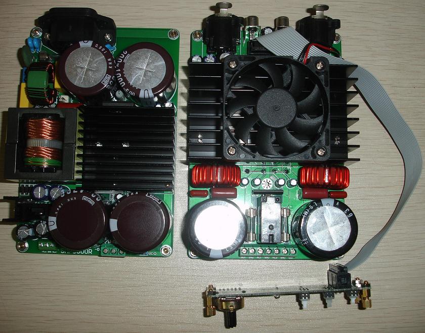

Which of your smps would be suitable for a stereo UCD400 amp running at 4ohms?

For a stereo UCD amplifier i recommend to use a SMPS800R or A1000SMPS.
The UCD400 module ON/Off switch pin must be pulled low to activate the module. the easiest way is to connect this pin to GND. supplying voltage from aux output is not the way to do-it. there are two ways to implement the turn-on. the best one is to use a general purpose NPN transistor with emmiter connected to GND collector at ON/Off pin and base to +12V aux tru a 10K resistor. in addition, a 1k-2k2 resistor between base and emmiter should be connected and if delayed turn on is needed, a 470uF cap as well in parallel with BE junction. another way is to use a 12V zenner diode and a 220R resistor between -Vaux and On/Off pin, the diode should be connected with the cathode at module tru resistor and anode at -Vaux.
The HxR regulators serve other purposes, they supply the small signal stages with a very clean and stable DC voltage which increase the amplifier SN ratio and reduce THD. for best performance, consider using them as well.
