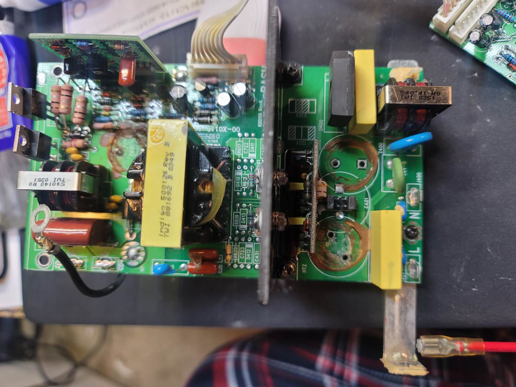

Hmm.... Seems that i have the same problem with my Mirage S10. After a lot of reading it seems the company Bash who makes these amplifier boards decided to use an adhesive on them which over many years hardened and became conductive. So i spent about an hour removing it as carefully as possible using a Dremel and a small carbide that is similar to an end-mill in design. I pulled the big caps off the board during this process and tested them, and the 1,000uf registered as 400uf and the 470uf cap measured in low as well. Not surprising considering they're made by XC and MHC.
So i just placed an order with Arrow for 2x IRF740 Mosfets, 1x Nichicon PW 1,000uf 250v cap, 1x Nichicon KW 470uf 100v cap, a few assorted resistors which i chipped with the dremel bit, 1x 10a 25c 10ohm thermistor, and 1x GBU6G-BP Bridge Rectifier. I probably don't need the rectifier or thermistor but i'd rather be safe than sorry. Grand total in parts, about $14.
The PCB is Bash 600123.
I thought i should report back in and let anyone who has run into this issue know that... IT'S ALIVE!!!!!
The Mirage Omni S10 subwoofer is back from the dead! I ended up replacing the two IRF740 mosfets, both the 1,000uf and 470uf capacitors, and the 10 ohm inrush current limiter (there was a small black mark on the original, which upon close inspection was a blow-out).
I would have replied earlier to this thread but I made a horrible mistake when removing the mosfets. Being the total hack that I am when it comes to this kind of stuff (100% poorly self-taught), i managed to tear out the via/eyelets and had to repair them.
So to anyone with one of these subs that instantly blows its fuse when connected to power, you'll likely be able to fix it by replacing the two mosfets, inrush current limiter, and the fuse. Considering how old these subs are, might be good to replace the caps as well. I plan on replacing the rest of the smaller caps soon.

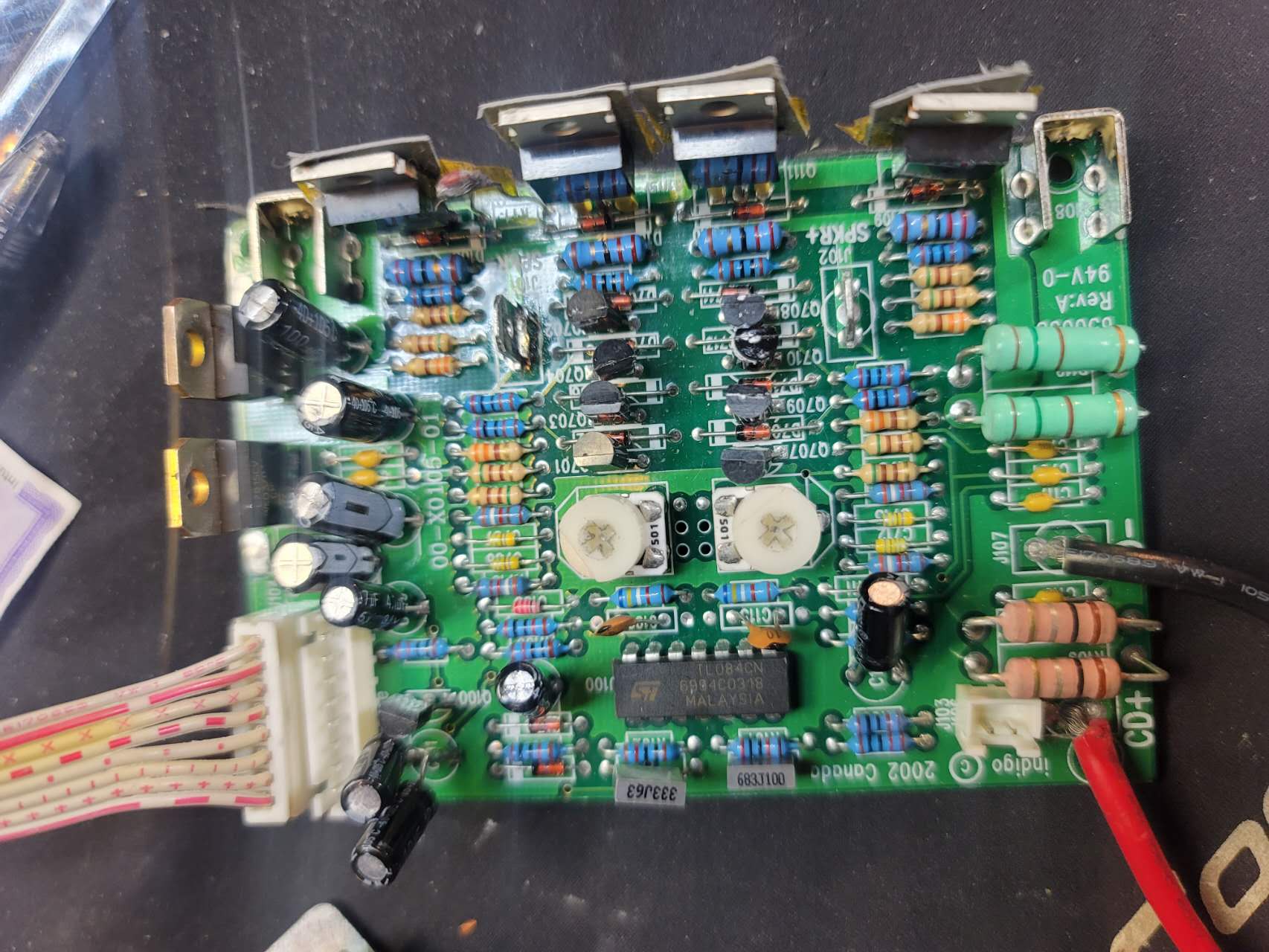

Started Googling a board assembly and as brought to this thread. Seems to be a mix of old and newer posts.
Just picked up an Axiom Subwoofer. Was stated to be DOA. Cabinet in very nice condition, Woofer checks out a good. Using a spare plate amp the woofer did it's thing.
The guts of this are a board made by INDIGO ( which is what I went hunting for information on). The stenciling on the PCB reads
"INDIGO MAIN 600049" and "REV7"
I asked the fellow I got the sub from about any history as it looked tampered with. He explained he sent it to a guy to have a look at for potential repair, and the guy couldn't figure it out. In the certer of this PCB are pair of transistor type devices and a 100uf cap. The cap looks sketchy and one of the leads snapped off when I was assessing the soldering. Further inspection of the underside of the PCB shows some horrific attempt as reflowing the solder on the transistors and some heavy blackening of the area associated with the 2 transistors and cap. I've ordered replacement components for those and some others - refreshing all the caps while I've got it apart, and the 2 power devices on the edge of the PCB. I don't know what if anything was repaired, and I am beginning to wonder whether a substitution was done on those two transistors. hunting for a schematic to identify those, if possible.

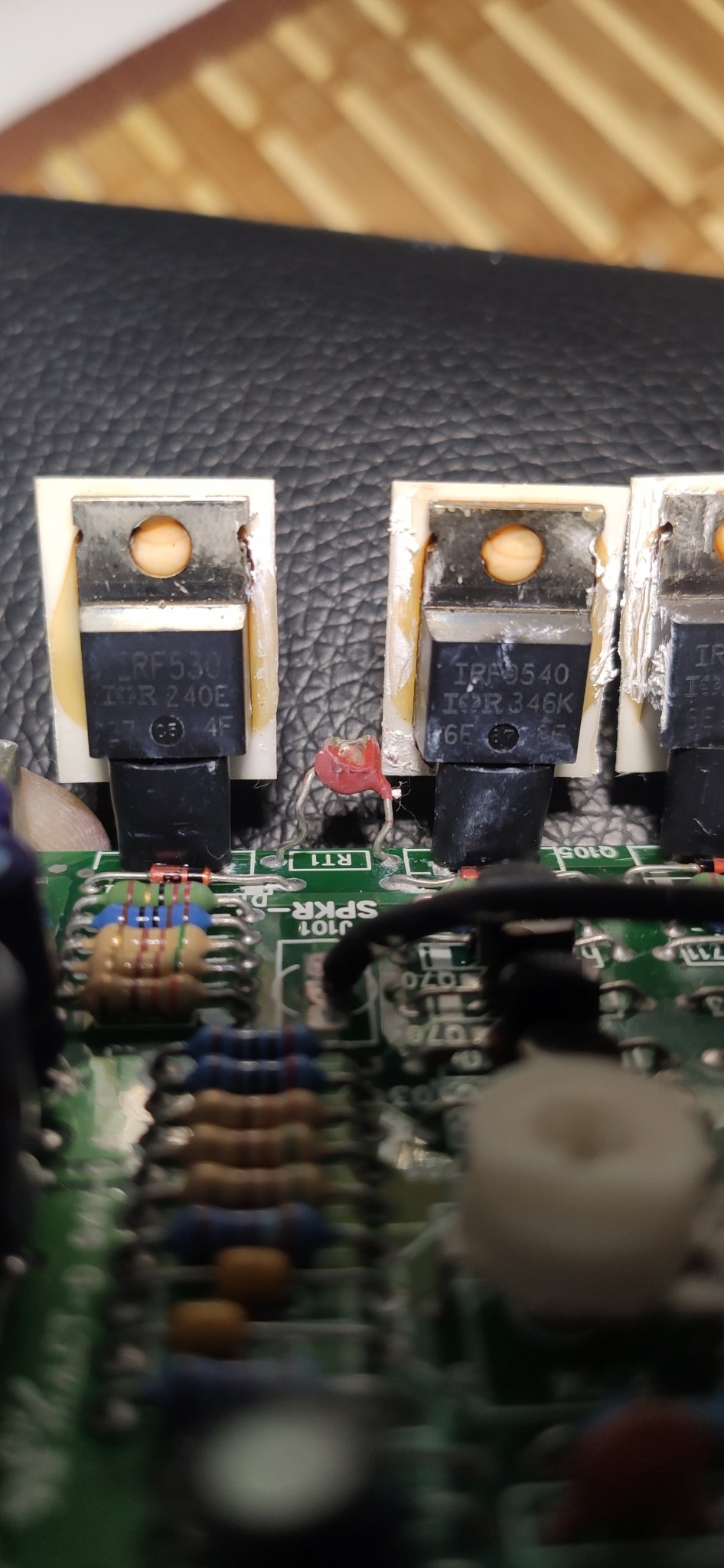

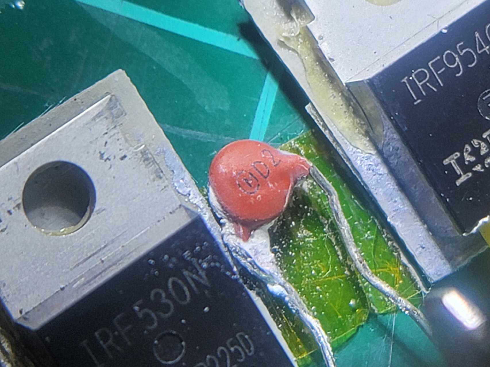

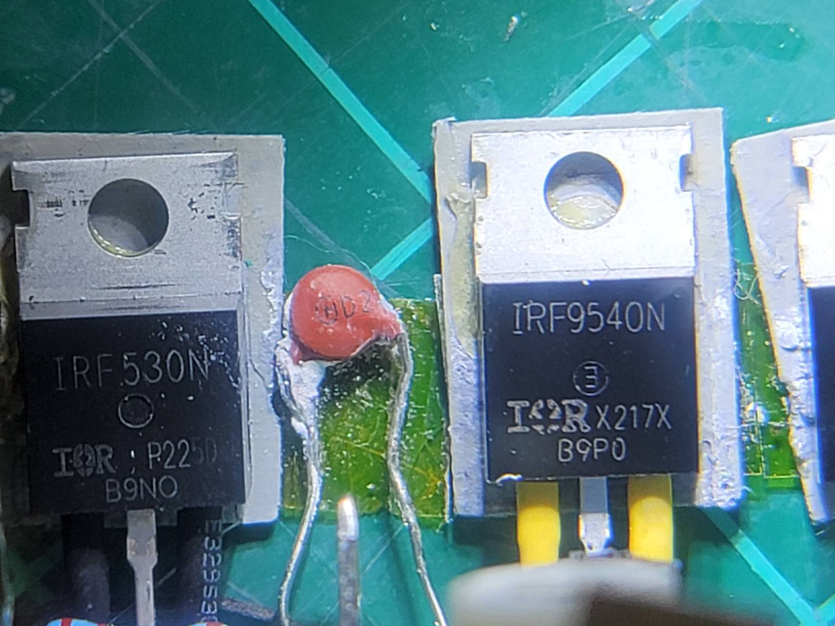

Upon looking to diagnose the problem on my HSU Research STF-2, I stumbled on this page. Oddly enough, the SFT-2 appears to use the same layout as most subs. So far changed out MOSFET IRF530N , IRF9450N, IRF740, replace cap 1000uf 200v & the pair of 220uf 250v. Before all the other MOSFET replacements, I changed out the main caps and adjusted the potentiometer, and got it working, but noticed it running real hot. Dialed back the adjustments and lil more and ran it for a few mins and everything went dead. I changed out the fuse and they kept popping. Finally, I've gone ahead and swapped out all the MOSFET and replaced the pair of 220uf 250v (old use stock). I can't get sound from the source to speakers or subs but do notice a loud fluttering and an obvious short indicated on my dim bulb tester. Kind of stumped on where to proceed next on troubleshooting and finding the short. Any help is appreciated. Thanks
