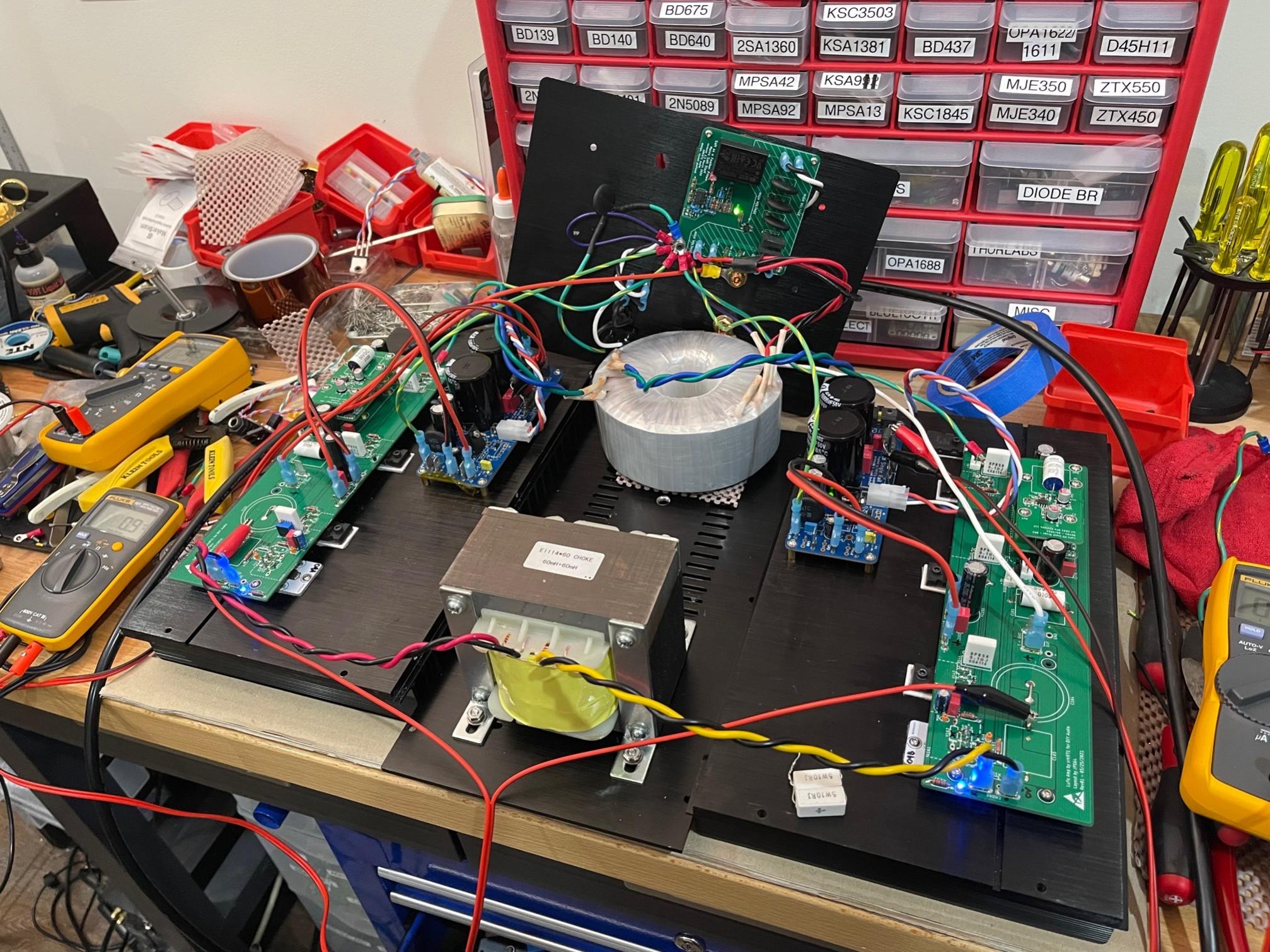

All good suggestions, guys. My next step was to bring trafo outside chassis. I’m quite sure that works as that simulates the flat splayed out arrangement earlier before I buttoned things up.

Have you tried powering the modules from your bench supply? That would tell you something. Also, wondering if the toroid leakage field is getting induced into the choke (they are very close)? Mumetal might help there.
I think it’s the proximity of toroidal and inductor. And I did think of mumetal but that only can do so much when the two are this close together. I actually put my very last piece of mumetal in between the trafo and the SLB (that’s all I had enough for). It dropped the noise a tiny bit. But a small piece placed between the trafo and inductor actually made things worse. Like it diverted the field and concentrated it.

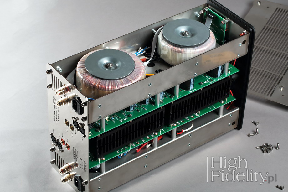

The aforementioned Grandinote Shinai amplifier has two independent mono amplifiers in one chassis and it was perfectly quiet; toroidal power supply transformer almost next to toroidal output choke; working with the same 3A quiescent current.

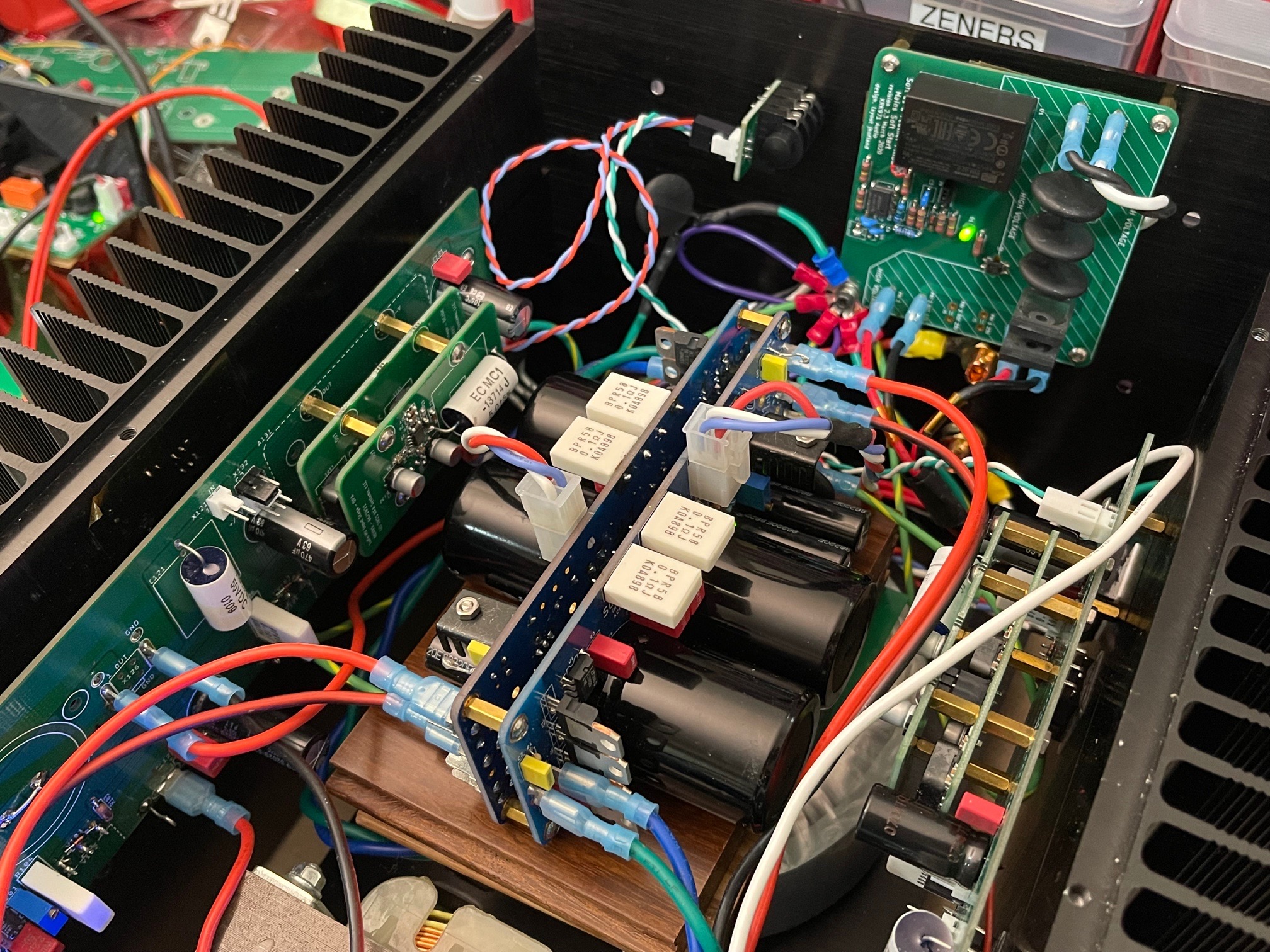

Looks like a steel tray holding the trafo’s above the amp might have some shielding to it. On the SLB PSU, I am using LT4320 active bridges with low RDson MOSFETs so very little heat dissipated on rectifier. The CRC needs to be looked at as it was designed for 5A continuous and had high ripple current rated caps to withstand the punishment. I measured the temp of the first cap at 51C. Still well below rated temp but everything inside the chassis is going to be about 50C given that’s how hot the heatsinks are running.
Edit, that photo shows the amp on its side. There are two banks of toroidal inductors and power trafos. Note that they are mounted with as much space in between them as possible.

From what I see (post #134) the power supply transformer and choke are too close; seems less than an inch; that's bad layout but difficult to correct as the depth of the chassis is the limit.

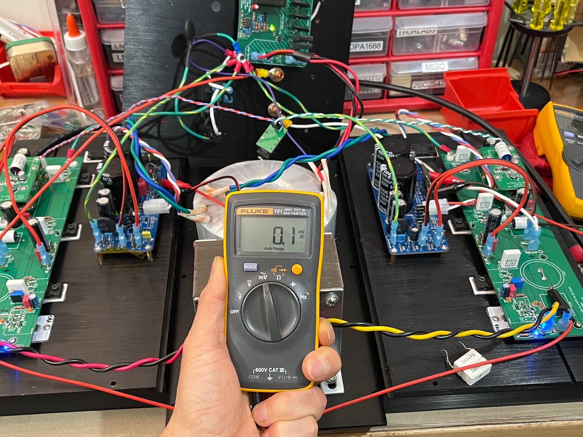

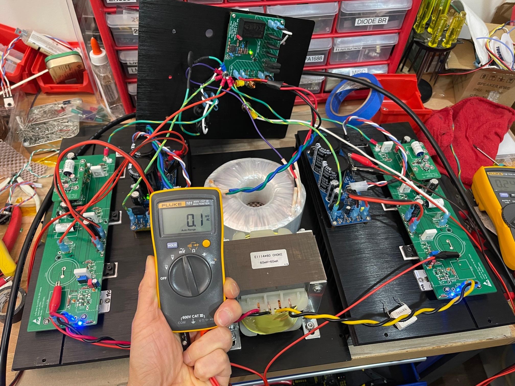

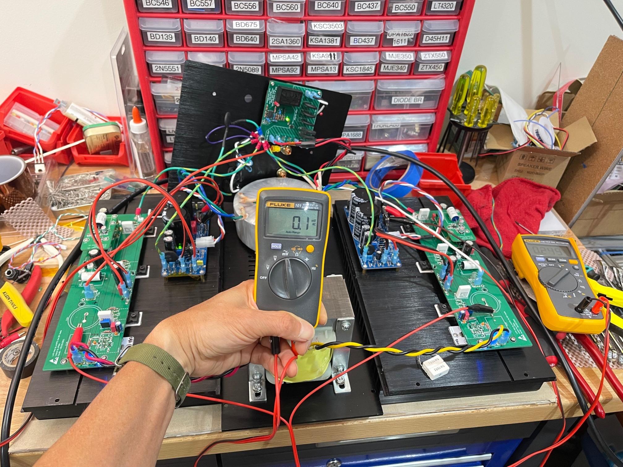

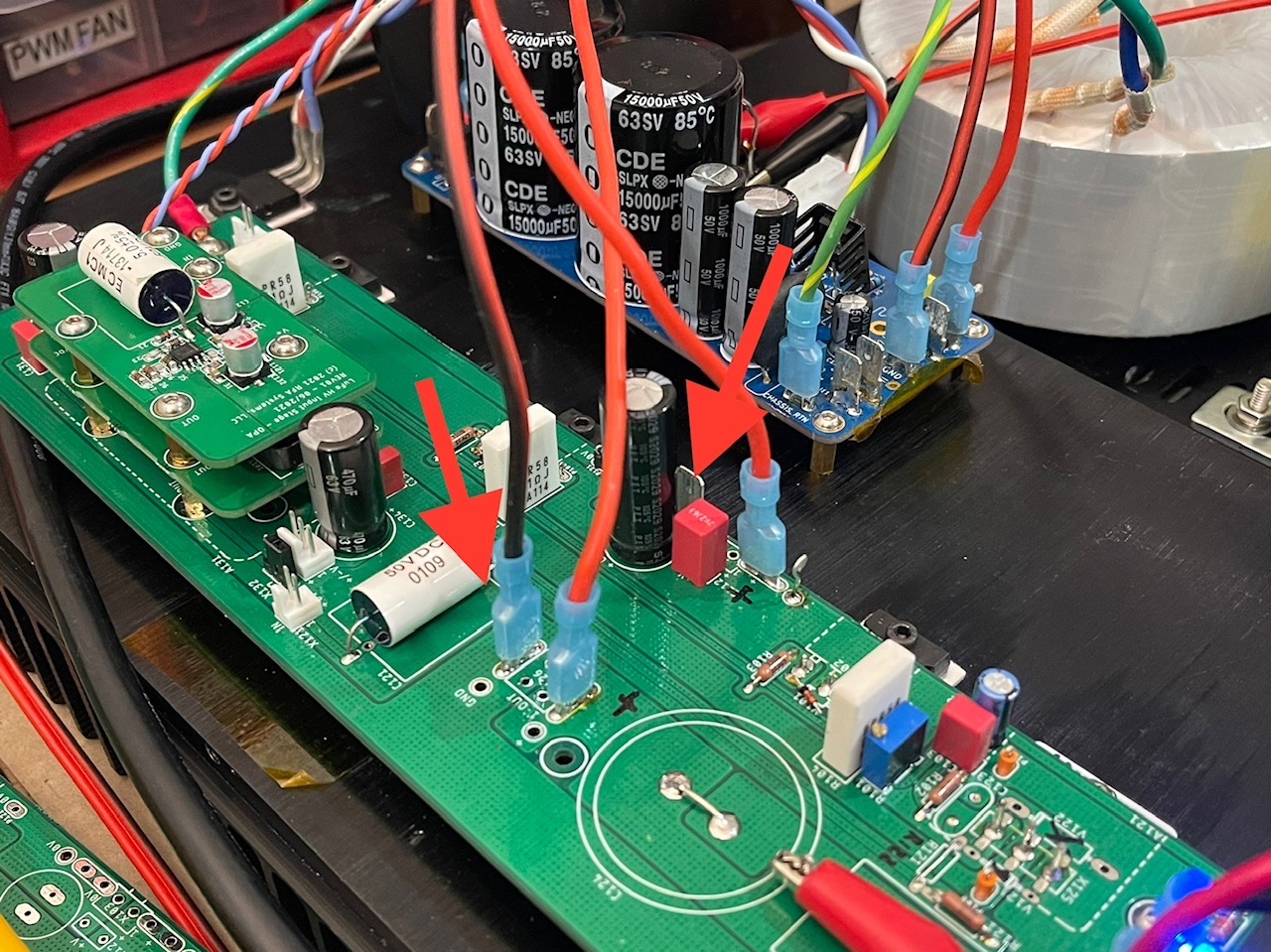

Some good progress last night. I splayed the amp open and flat. I looked at the effect of noise/buzz/hum as a function of various things. It looks like a second SLB so that each side has its own PSU seems to help a lot. Moving the toroidal trafo close to the inductor had no effect. So it looks like a ground loop due to a common PSU was one of the issues. The biggest issue, however, was a ground loop when the audio inputs from the balanced TRS connector was attached. Studying the layout of the board, JPS64 designed the layout with a star hub grounding topology at the speaker output ground for the LuFo. This ground was not used in balanced mode, and the power supply input ground was not at the star hub. We are dealing with large currents here and moving the connection for the PSU input ground to the unused star hub ground location solved the ground loop hum from the audio inputs. In flattened configuration with linear trafo next to inductor, dual SLB PSU’s, and moving ground to star hub ground location results in a quiet amp. The noise as measured with Fluke 101 measures 0.1mV rms and speaker is quiet with ear pressed to cone. This is looking really promising but pushing everything back together as a small “box” may prove to reintroduce EMI induced buzz/hum. We are making progress though.
Photos show noise as measured on Fluke 101 in mV AC mode (closely matches audible buzz/hum and 0.1mV is acceptable close to silence). Photo also shows where ground pin was moved from and to.

Dual SLBs probably also has the benefit that you're not exceeding the output current limit of the SLB anymore, right? 😉

With dual SLBs being used for a single channel, there are many ways to manage the ground connections. I imagine some experimentation will be needed. There may also be a couple ways of managing the ground loop breaker NTC thermistor(s).

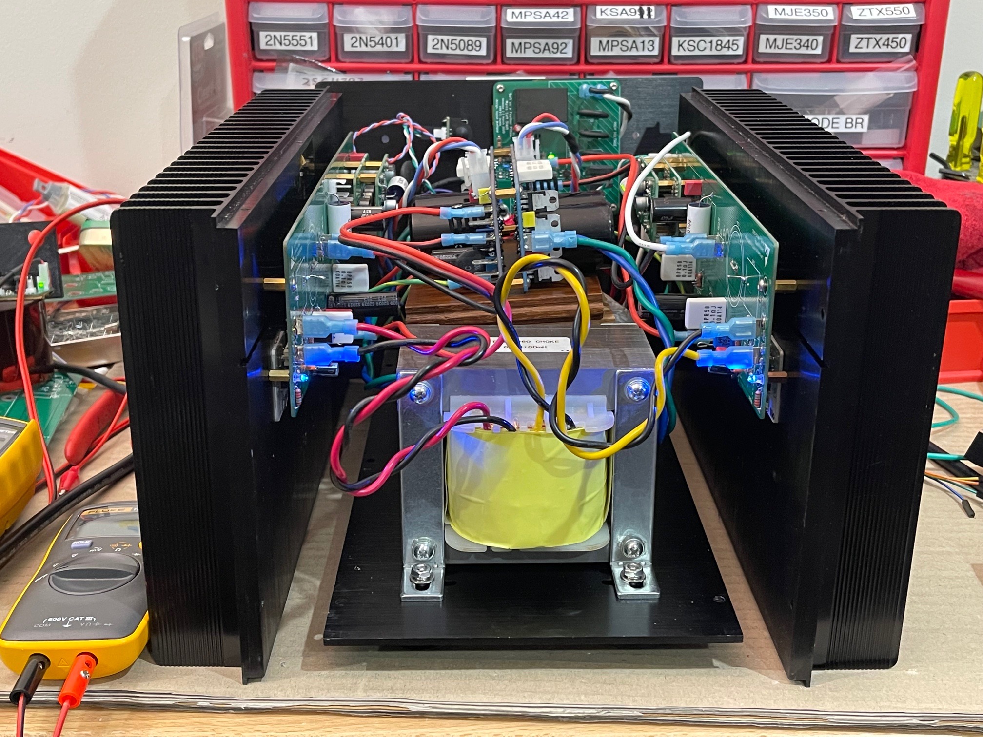

Yes, the SLB is designed to provide under 2mV rms ripple at full rated load of 5A. So 3A load should be ultra quiet (1mV or less) as far as linear PSU’s go. Also, the ripple currents in the caps will now be well under the design (optimized from simulation). The specified caps have an 8A ripple current rating, 2x higher than the predicted simulation value at 5A.
Putting the two SLBs back to back and sideways allows it to fit in this tight chassis. A dry fit without all panels bolted together is yielding higher noise already than when laid flat. Fluke 101 now reads 0.4mV rms. I can hear a little buzz - much less than before. So now the ground loop is solved but there is some spatial EMI effects of the amp going from flat to compact box. More debugging ahead.
We could try flipping the floor panel orientation 180deg. As I recall, that dropped the noise about 0.4mV or so last time. It moves the linear toroidal to the front away from the front end boards.
