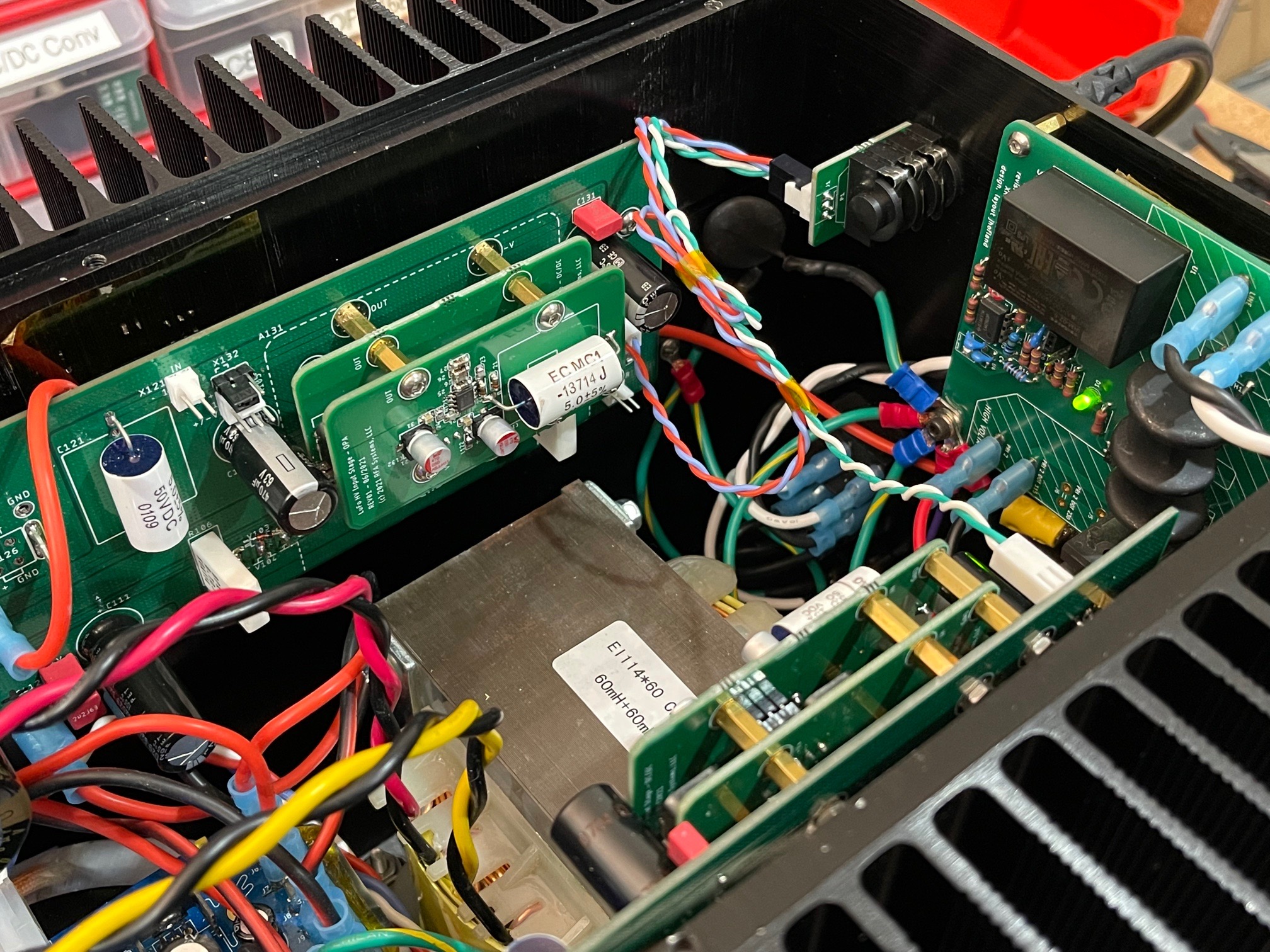

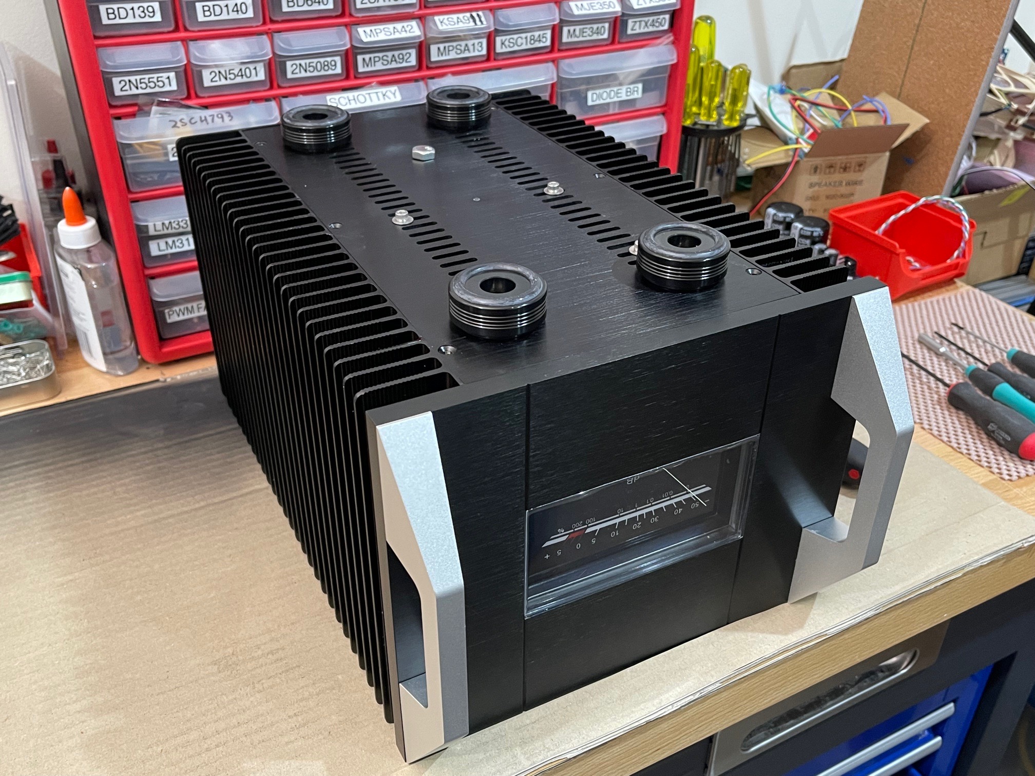

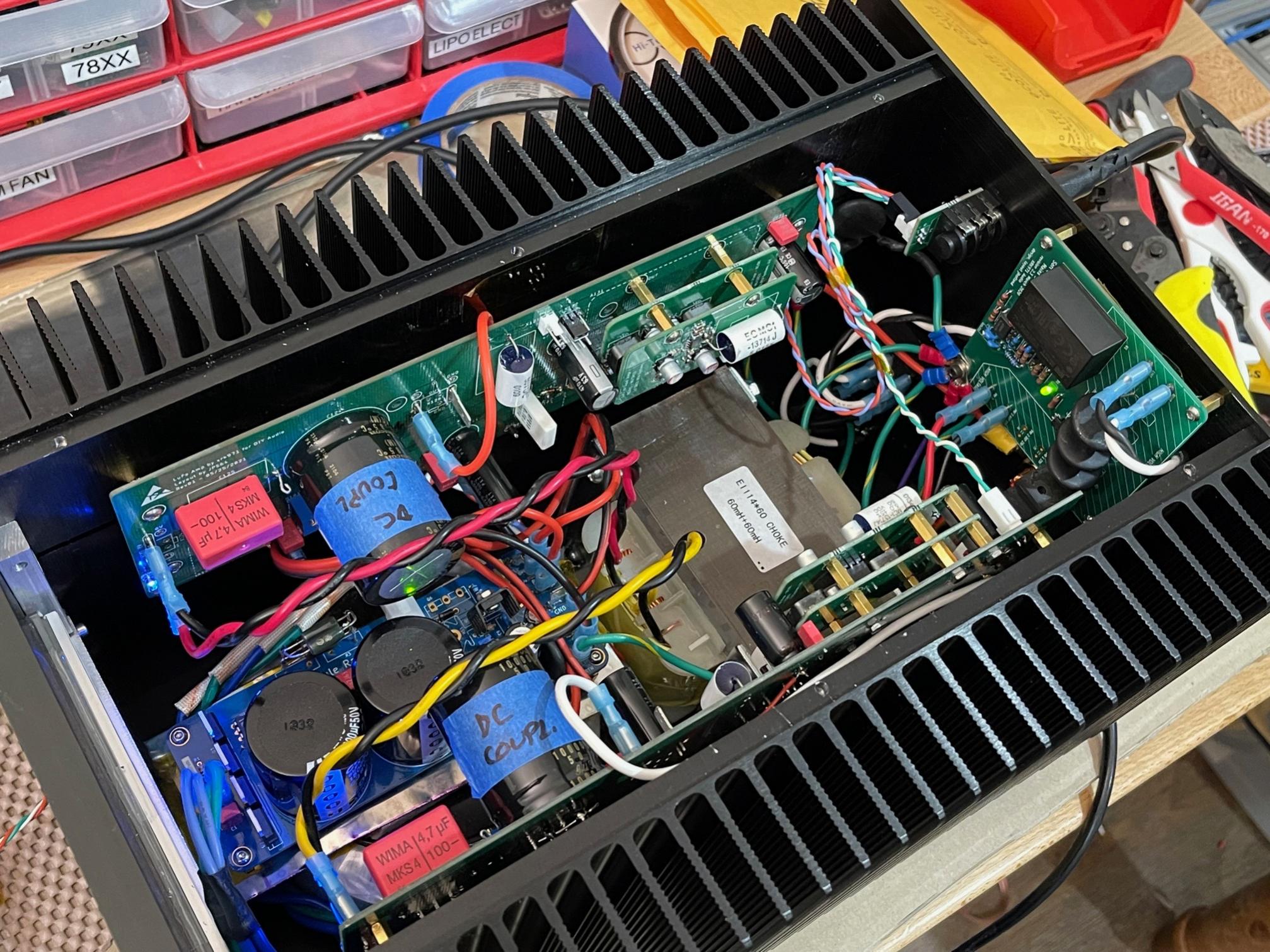

So packaging the amp tonight. I hate chassis work - but this one isn’t too bad. Most of the holes have been precut already. Some needed enlarging.
A couple of posts back I posted some video clips of a couple of tracks I use to listen for bass dynamics. One is the popular “Chocolate Trip” by Tool and the other is “Hey Now” by London Grammar which is very tough on an amplifier as it has infrasonic bass simultaneously with vocals. There are other tracks, one of my favorites is “Cornbread Fish & Collard Greens” by Anthony Hamilton, and another is “Man from Molise” by Pino Palladino and Blake Mills, and “Exit Chapel Perilous” by Tipper.
As far as comparing with my other amps, I am trying to box this amp up so that I can bring it over to the main rack to connect to the AB amp switcher box to do a fair comparison.
You better start working out in the gym because these beasts are HEAVY METAL. 🙂
Deceptively compact yet dense.
I have not seen you case up most of your projects. My hat is off that is a piece of artwork.

I wonder how hot they run. 28 VDC rails at 2 x 3 amp means about 170 W of heat, and the chassis is not huge (260 x 200 x 363 mm). Do you need a fan, or is passive cooling good enough?

I am not using any fans for the assembled chassis. I had them when they were lying flat on the bench. I have not connected the VU meter yet, but I’m sure they work nicely as visual indicators with a nice glow light in the back. The driver board has pots for setting the gain. Not sure I would rely on it to show how much power is delivered though. More of a visual effect thing.
@Cambre, My heatsinks are 350mm long x 200mm high x 40mm deep fins with 10mm thick baseplate. It is running at 48C for 25C ambient temp. So that’s 23C rise. 3.1A x 28v is 86W. Based on that, my heatsinks appear to be 0.27C/W rating. That’s very good for a passive radiator. If 55C is the max safe temp I could tolerate 30C rise or 110W max dissipation per side.

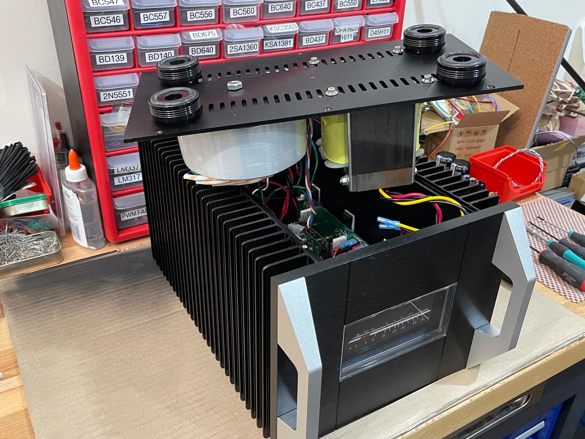

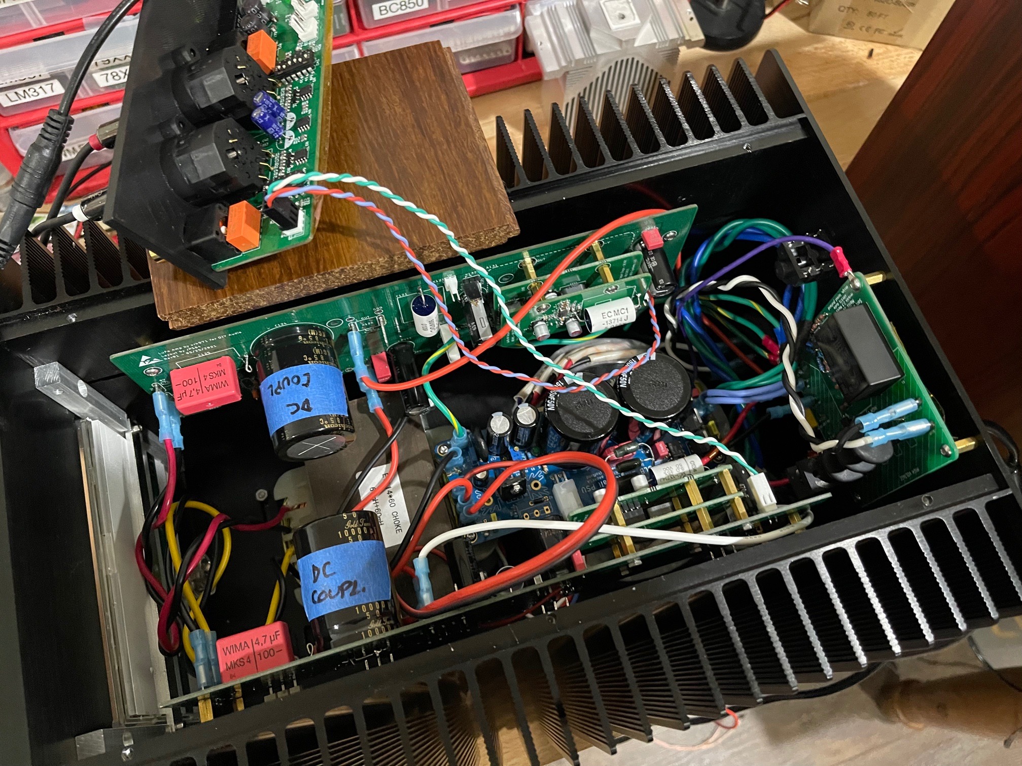

One good thing about this case is you can assemble everything with all the panels flat. Then screw them together since all screws are accessible from the outside.
One more reason to go with this chassis!

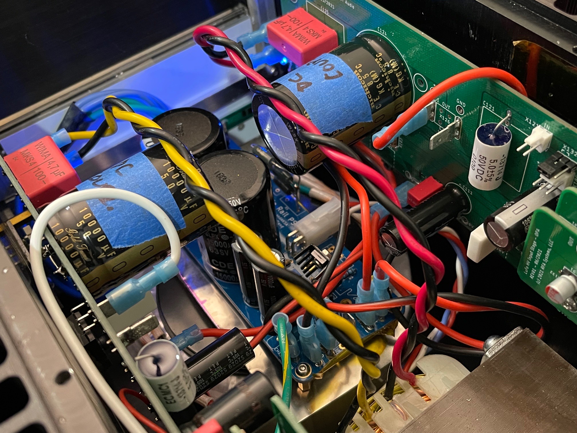

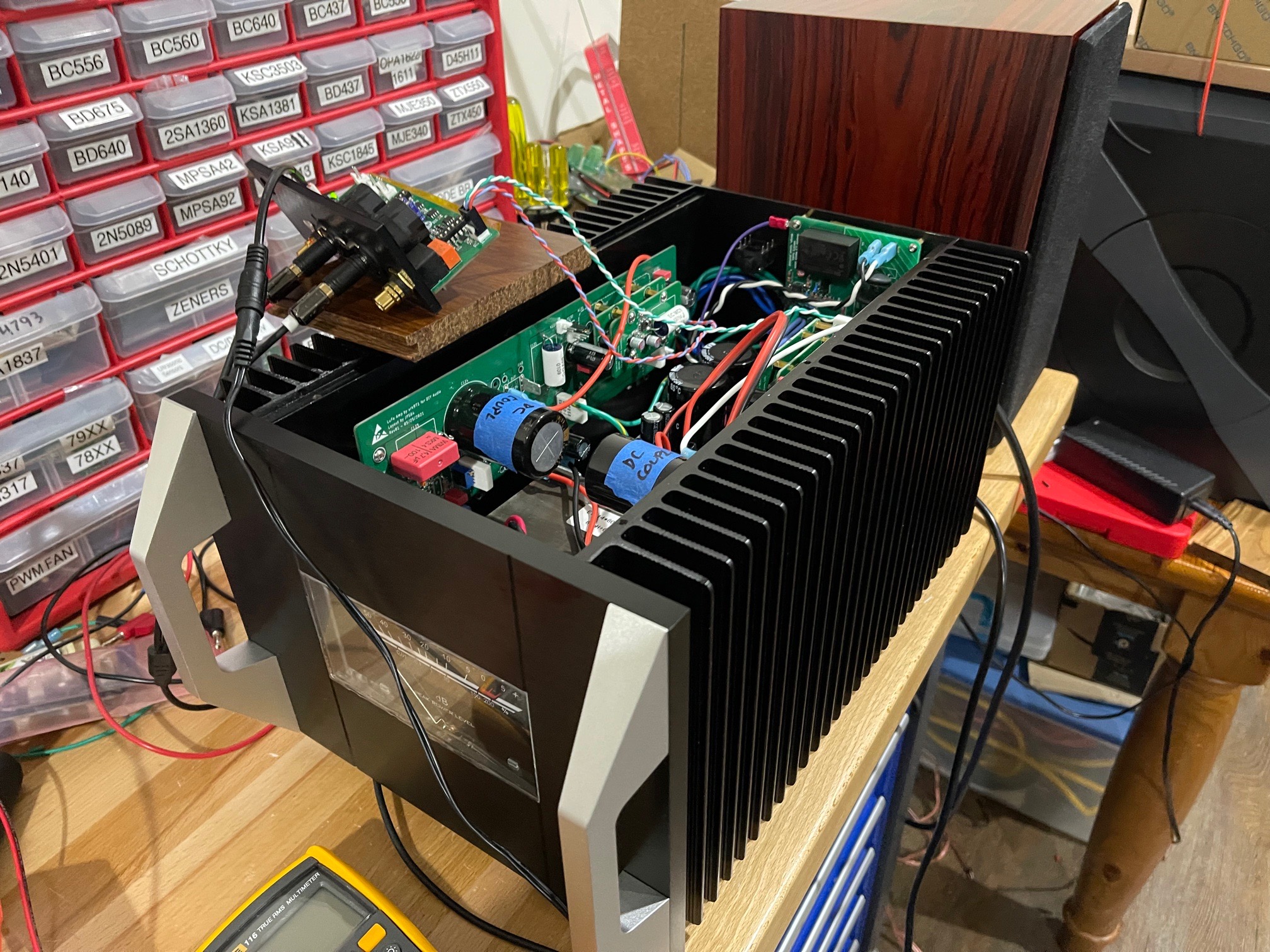

I’m chasing down the buzz/hum noise in the amp. I suspect it’s from the EMI radiated from the main toroidal power transformer and that is getting on the input stage. So I decided to test this out by flipping the positions of the inductor and power trafo. Luckily this amp is symmetric with respect to the floor board and screws accessible from the outside. Putting thr amp upside down then flipping the floor board 180 deg. I took the opportunity to clean up the wire routing.

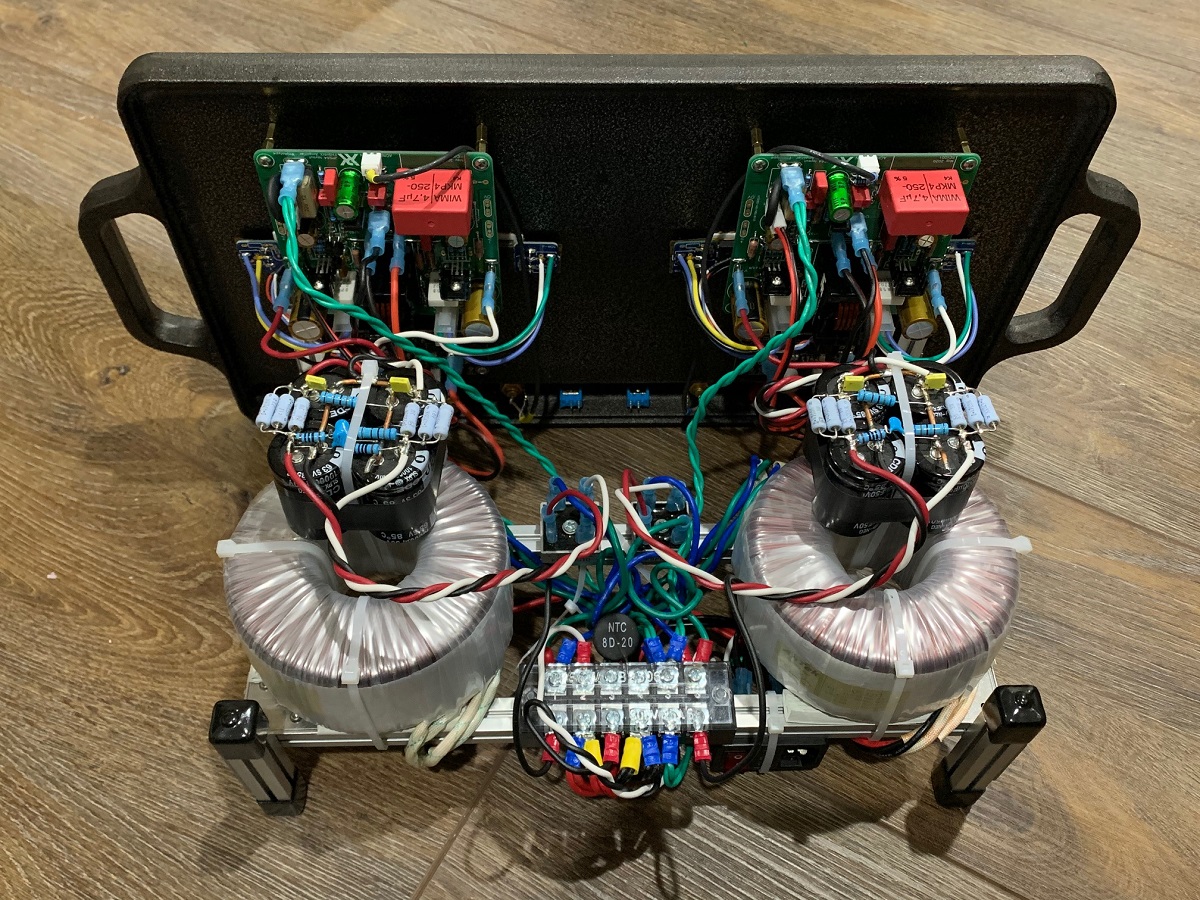

The feet come in handy as handles to pick up the floorboard from the main chassis body:
Here is the amp reassembled with toroidal trafo in front and balanced inductor in the back:
The noise went down from 1.4mV rms to 0.9mV rms. Still there but looks like it’s coming from the toroidal trafo. A SMPS might be the only way to fix this.
This is just a small change. Could be due to slightly different wire routing, or just a day-to-day variation. To teally check the influence of the transformer, I would remove the transformer and the SLB from the chassis and connect the DC rails using long leads to separate the AC power from the audio signals.

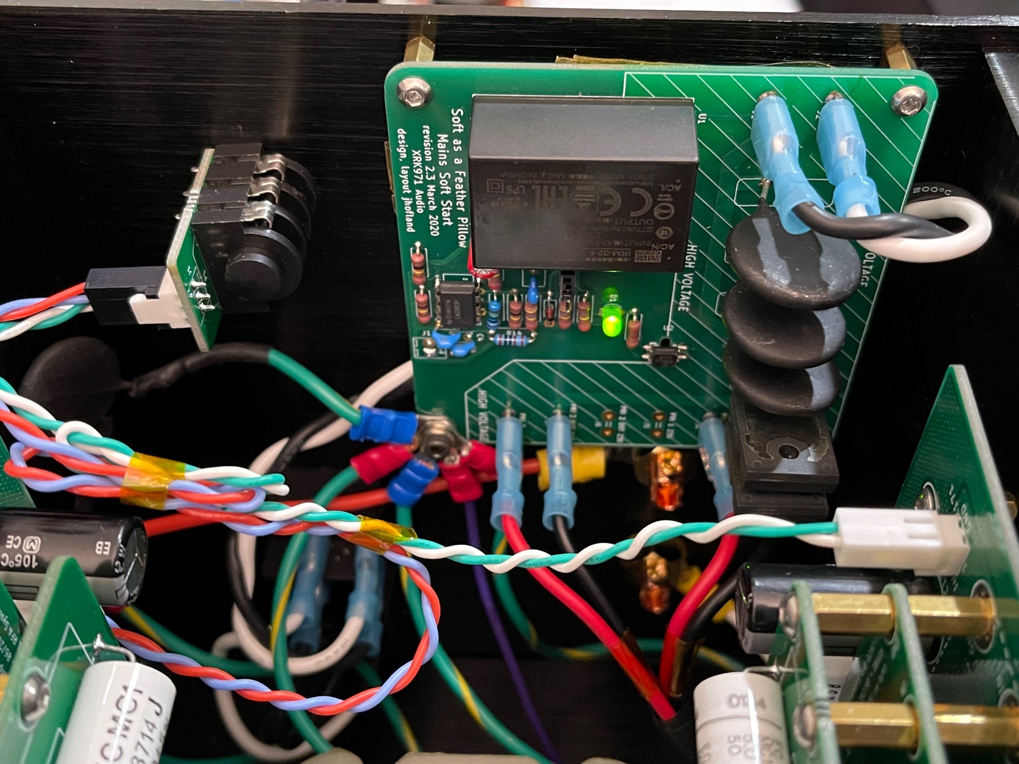

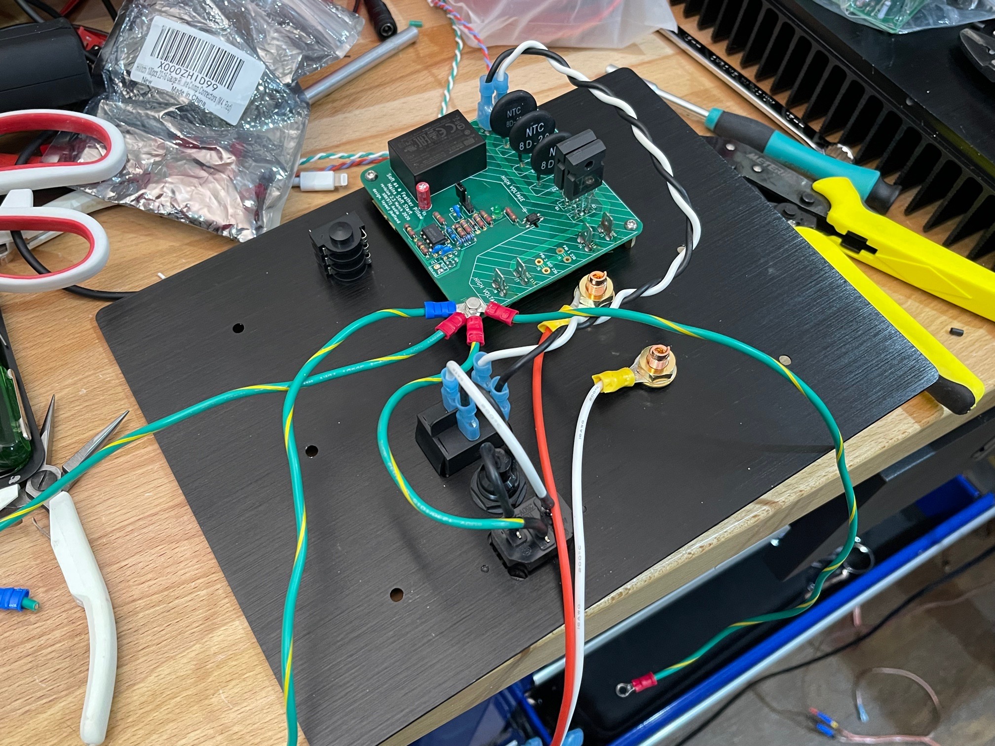

Oh, and since you have a hum problem, eliminate the complex relay based soft start module and replace it with a simple 4P terminal strip and a pair of MS22-20005 NTC thermistors wired into the primary side of the power transformer.

Nothing wrong with adding a bit of real capacitance, but the SLB power supplies used in XRKs build will provide very clean DC already. I'd be surprised if the hum is from the power supply rails, but it's worth to check.
Oh, and if the hum turns out to be EMI, I wouldn't think that going with an SMPS would change this. The only change would be the frequency of the noise.
All good suggestions, guys. My next step was to bring trafo outside chassis. I’m quite sure that works as that simulates the flat splayed out arrangement earlier before I buttoned things up.
As this is a balanced amp, I think it also has the advantage of very good PSRR as the common mode noise in the power supply rails would be subtracted out due to the topology. It essentially looks like a big LTP input stage.
The EMI however is not going to affect both legs equally.

2. Swap SFP soft start for basic heat burning NTCs on primary of trafo
