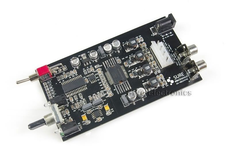

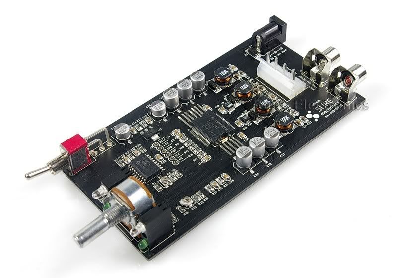

It looks like Sure Electronics has a new (and improved?) version of this board. They claim:
It integrates a high-quality potentiometer and a rotary encoder which provides precise shaft rotation. This potentiometer employs high-quality digital volume control IC ensuring more accurate volume adjustment and perfect sound output than the traditional analog potentiometer even after long time use.
I wonder what that means. You can see some of the difference on the circuit board. It looks like they may have made a few small tweaks to the power end of the amp as well. Look at the box caps used on the supply rails to the Tripath chip.
![th_AA-AB340.jpg](https://i69.photobucket.com/albums/i43/Ty_Bower/SureElectronics/th_AA-AB340.jpg)
![th_AA-AB341.jpg](https://i69.photobucket.com/albums/i43/Ty_Bower/SureElectronics/th_AA-AB341.jpg)
-Old board- -New board-
Often volume controls with IC are done with + and - buttons. A nicer interface is the rotary encoder, which gives the feel of a pot, but actually does nothing other than pressing the volume up and down at the IC pins...
Usually these encoders don't have an end stop and can be turned infinitely, so the volume often returns to a pre-fixed setting on start up. If not there may be a memory holding the last setting, but then (and in any case) it would be handy if there was a display showing the level....
I would ALWAYS prefer to have a separate preamp and not have all this junk on my power amplifier board, but for portable devices and PC speakers it can be convenient....
Sure should offer the encoder and IC volume buffered on a separate preamp board.
