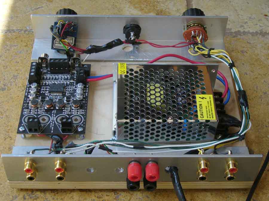

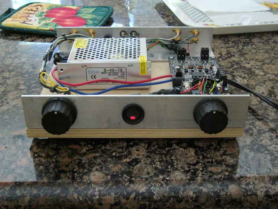

Here is my 1st DIY amplifier, tried several times and messed up.
I want to thank so many folks on this forum, particularly audio1st.
Got the basic mod but stopped short of soldering on the parts, such as input caps, etc. (not sure exactly which part I need...)
I soldered on on-off power, LED on, volume-pot, 4 way selector switch ( so can play from PC, ipod, CD, etc). Installed Arjen's SMPS and put in the tempoary case and it works.
When I catch my breath will put in the new case.
gychang

gurley123 said:
How is it sounding Gy?
Are those Zigmahornets that you have it hooked up to?
Inquiring minds want to know.
sounds excellent, with limited mod of the amp and the zigmahornet speakers, bass is excellent especially with the corner placement. Not for rocking roll but for us, great speakers IMHO.
gychang

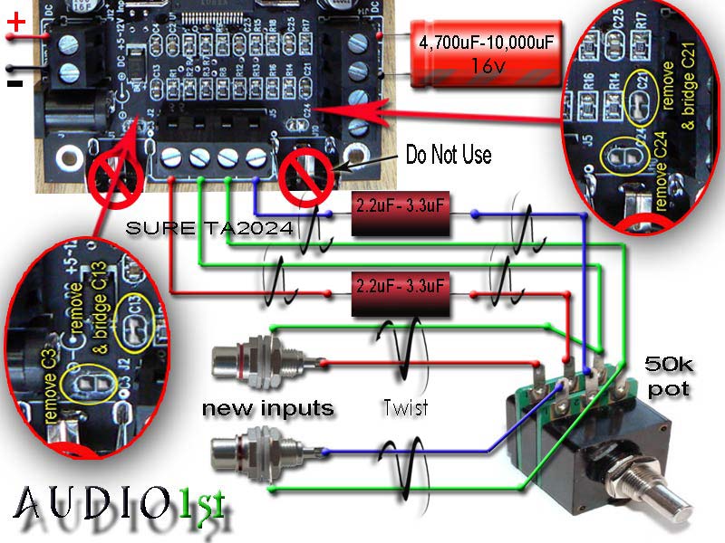

Where from / what part did you use for the input selector?
If you get yourself a power stiffening cap, you can add it without doing any soldering by screwing it into the auxilery power inputs.
Removing the lowpass caps on the input and replacing the input caps is worthwhile. Perhaps later...

what part would you recommend for this newbie for "power stiffening cap" and "input caps"?. I do have this Dayton DMPC-3.3 3.3uF 250V Polypropylene Capacitor detailed below, is this going to work?
http://www.parts-express.com/pe/showdetl.cfm?Partnumber=027-420
gychang
Thees Daytons look very good for input caps. Remove original input caps, bridge pins with small wire or large solder, then connect Daytons between screw input terminals and pot.
For power cap you can use 6800 - 10 000 uF x 16V electrolyte, you can screw it direct to amp boards's power terminal.
For signal cable from RCAs to switch and pot you can use better twisted pairs from cat5 cable, as short as possible, without unnecessary loops.
I usually use stiff cat5, with 1x0.5mm wire in each wire, before using in amp I twist pairs little tighter than original.
Main power wires to PS and power switch twist tightly too.
Zigis.
Zigis.
thanks for tips:
1. Will try the Dayton's and report.
2. for power caps, will this work? http://www.bgmicro.com/index.asp?PageAction=VIEWPROD&ProdID=11296
3. from RCAs to switch and pot, (do I twist, ground-hot from each red, white RCA's or in my case only hot is connected since the whole metal back is ground... do I twist both hot from each colored RCA's into one "ribbon"?.
I appreciate all the hot tips (pardon the pun).
gychang
this el cap is good enough, only you need to solder to it's legs short wires to connect to board.
For RCAs - one twisted pair for each socket (8 independent pairs in your case), one wire to hot, one wire to ground. You don't need to twist it all together.
Grounded connectors are not good idea, you can easy get ground loops problem.
Better use insulated RCAs in your final construction, something like this:
http://cgi.ebay.com/20-Pcs-GOLD-RCA...QQptZLHQ5fDefaultDomainQ5f0QQsalenotsupported
Because you use 3 pole switch, you can switch each source's ground too, connect both stereo pair grounds together on switch leg, not on chassis side.

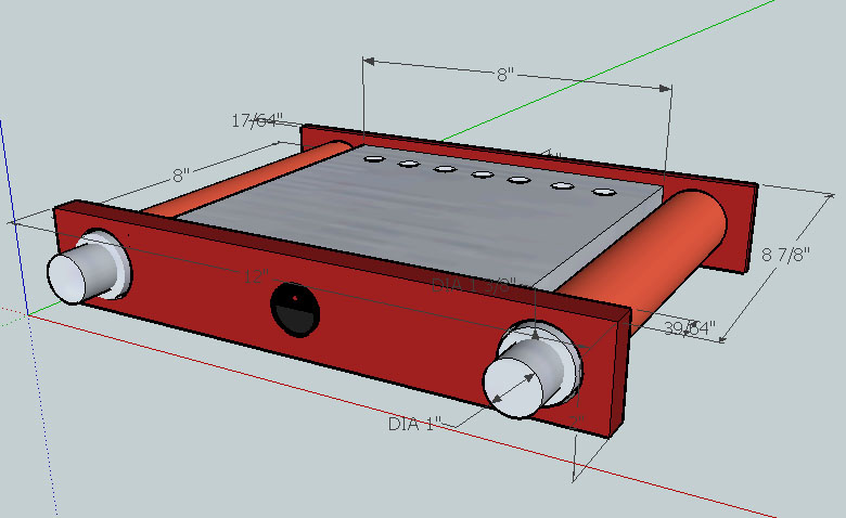

B.T.W. how do you plan to made these cylindric units in your sketch?

thanks for the numerous tips, these are valueable for newbie like me.
I bought the PVC pipe and plan to cut and paint to a metallic copper color, will see...
gychang
audio1st said:
Just for you gychang😉
just phenomenal picture, I appreciate your effort in be half of all those newbies. Your pictures are amazing, how do u create these masterpieces? I noticed "twist", I will indeed twist the wires for optimal build.!!
thanks, give me few weeks and will report back on the results.
gychang

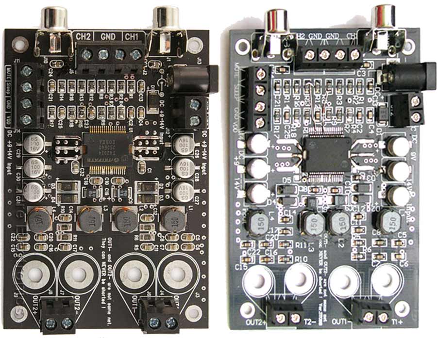

Sure copies are now appearing on ebay.
They make the Sure boards look like a work of art.
Look at the wires connecting the input resistors to the chip😱 and they have probably kept all the mistakes that Sure made as well🙄
I just received mine from "Iwanabuy" here on ebay: http://cgi.ebay.com/ws/eBayISAPI.dl...STRK:MEWNX:IT&item=230354638632#ht_2630wt_940
I mistakenly thought it was the same as Sure board..., will have to look at the board carefully. Hopefully it will be similar enough to follow the recommendation on the Sure board.
