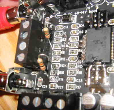

Peter Menting said:FWIW; I have enjoyed some success removing small SMD components using a sharp pointed X-Acto knife blade. I place the blade tip at the intersection of the chip and board and apply heat to it, sliding the iron down the blade toward the component but not touching it or the board. At some point the adhesion surrenders and the SMD simply "pops up" without damaging the trace.
Hope this helps.
Pete
Pete, this is a valuable tip, since I have removed the solder pads before. Will this work to save the pad and remove just the SMD?
gychang
Do not apply too much prossure with the razor and you should be fine. Be gentle so that you do not pull up the other side of the SMT too far and damage the pad or the device.

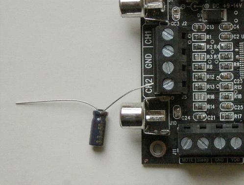

gychang said:
I have 2 caps, 3.3uF, 50V. Can these be used for C13 & C21? (I don't have 2.2uF). I plan to remove and bridge the original C13 & C21 and solder them on the input side on CH1 & CH2.
gychang
1. Attaching the caps as pictured work? (plan to use for both channels of course)
2. Does it matter which cap "leg" is toward the PCB? One is longer.
3. Unrelated question of attaching the heatsink without screws. Is the a special compound with bonding property that transfer heat? I am unsure how to "glue" the aluminum.
gychang
Hi gychang,
if you have original input caps C13, C21 in place, you don't need any additional input cap, just connect signal to input.
To improve sound quality more, bypath C13, C21 and connect quality non polarized film cap, search for metalized polypropylene or at least metalized polyester.
Electrolytic cap (you have in pic) in this place can't made any sound improvement, even worse than original.

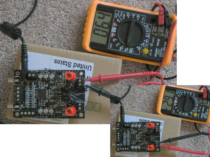

anything wrong here?
Partly modified board sounds very good to me, compared to my recent Pioneer Elite and professionally modified amp32, playing on my large speakers.
I measured the voltage output with the DC input, but I get markedly different values on the speaker side. Values are same whether I measure from the banana plug or the terminal side.
Is there a reasonable explanation or does it matter at all since the sound is very good.
thanks in advance.
gychang
thanks in advance.
