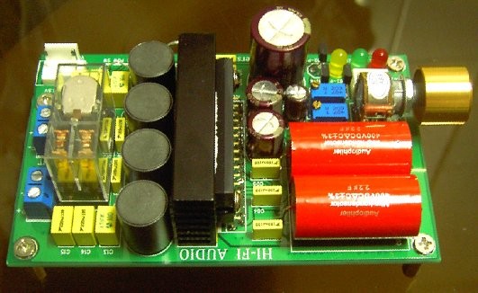

There is the Photo.
features:
-Better PCB layout
-Audio grade input caps
-Fully shielded output coils
-Delayed output with relay
-Over current protection circuit
-On board potentiometer ( this may be revised later )
-DC offset adjustment onboard
I yet have to test the board for THD distortion ect.

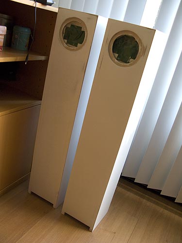

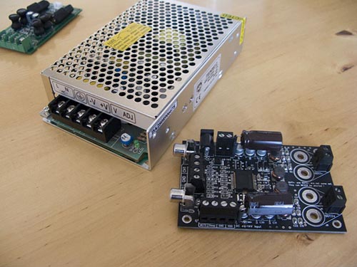

Got my caps and power supply in this week. I added two 2200UF caps to the Sure amp this morning. Hope I can find time for testing later today. I like the inductor ideas of Peter Henk and Woody. Sounds very promising too. Did you guys use Enameled copper wire or silver plated? What wire do I need to order? Thanks, Aad
Amp is working now. Next step will be removing C13 and 21 and adding a pair of Rubicon 2,2UF caps on the input. I am still using a pair of old Jamo's now. It's about time I finish my Cyburg Sticks. They are still waiting for painting. But the filler I used is so hard to sand and is so cold outside right now.
