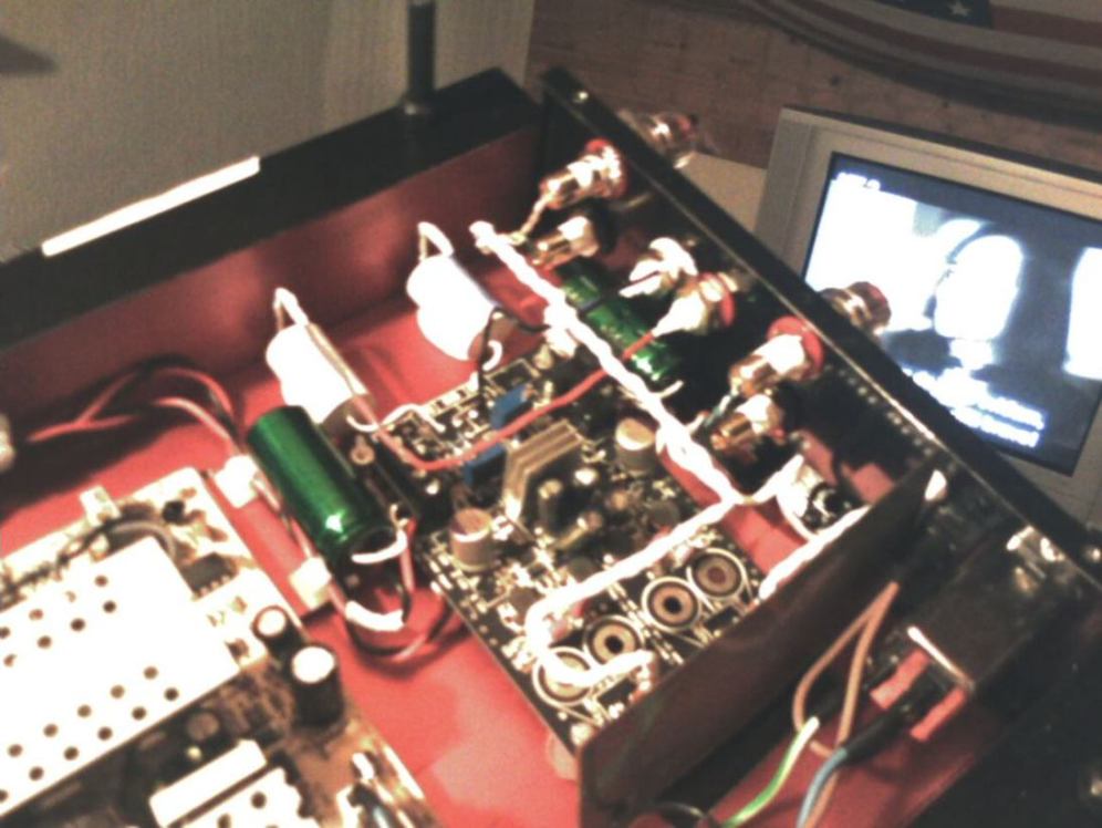

I did most of modifications on my board and I must say I'm delighted with things I hear.
This little t-amp is much better than my standard NAD C352 amp. More details,more accurate bass and cleaner highs.
Also, my speakers are Quad 21L ,88db on 6ohm and t-amp can push it loud as hell 🙂
Power supply is from PC ,moded,with trimer to get 14V DC.
This is what I done :
remove c3 & c24
remove c13 & c21 ,bridge it
put trimmers as on JustBlair site,dc offset zero now...
remove speaker connectors,input connectors(both)
Mundorf M Cap audiophiler 2,2 uF - one side direct to the HQ input terminals,other side direct to the board
r8 & r14 replace with 10k
c9 c10 c18 c19 bypass with 4 Panasonic FC 82uF
c26-c31 removed,replaced with 2 Sanyo os-con SEPC caps 470 uF
removed d1
dc mod II as on JustBlair site
C8 C11 C17 C20 replaced with Wima 0,1uF
Added 2 Nichicon Muse audio grade 2200uF on power input (both sides)
Cooler for chip
Added EMI shielding folil near AC current wires
And that's all for now 🙂
Now,this IS a truly giant killer 🙂
What else to do? Well, I plan to replace inductors with toroid ones,and maybe air core someday...
Copper shileding for power supply...
And maybe play with some polystyrene caps for C7 & C16
I will add some pics when I get camera...

Update
First, I replaced stock inductors with toroidal ones,but something gone wrong. Some kind of distortion was present on high tones.
Then I go mad and wound air core inductors 🙂
Because I only have 0,80mm wire ,inductors are near 5cm high ,pretty big,with diameter of 1,5cm, 62 turns.
But now,sound is beautiful,warm and gentle. Just like on most tube amps. No problems at all 🙂
Well,on the downside,now I can't put cover on my amp case,inductors are too big 🙂
When I get the 0,5 mm wire ,I will wound another ones,it will be only 2,2cm high.

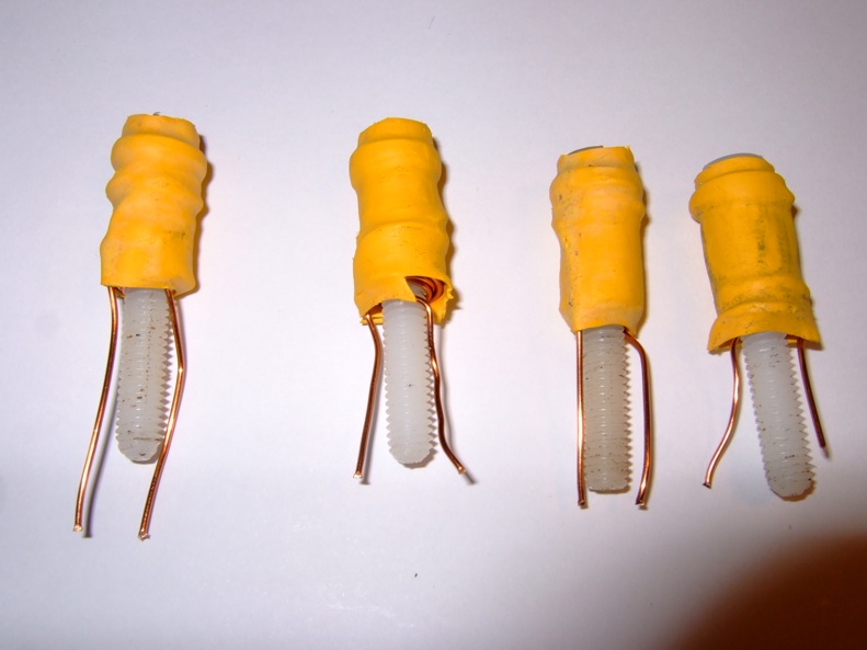

hand made inductors
Hi milen007
Yesterday I made these inductors of 0,8 mm wire on a 6mm diameter nylon screw core.
3 layers of 17mm long.
Souns very good!!
I first experimented a bit before I came up with this design.
There is a nylon washer on both end of the coil, and the length was adjusted with a nut. An extra nut to lock the distance et. voila.
It took me 2 hours to do the whole trick.
Next time I will use a wood core and make a small hole in it. Then you have a solid starting point. an other hole at the desired length and you can start winding much faster by turning the wooden core around.
Peter

nice one. will try that. wood and nylon core is available locally. i need to ship over the ferrite core tho. but will try the wood core 1st. thx for the tips

the one i have is ta2024. just hook it up. sound not bad. going to mod it.
